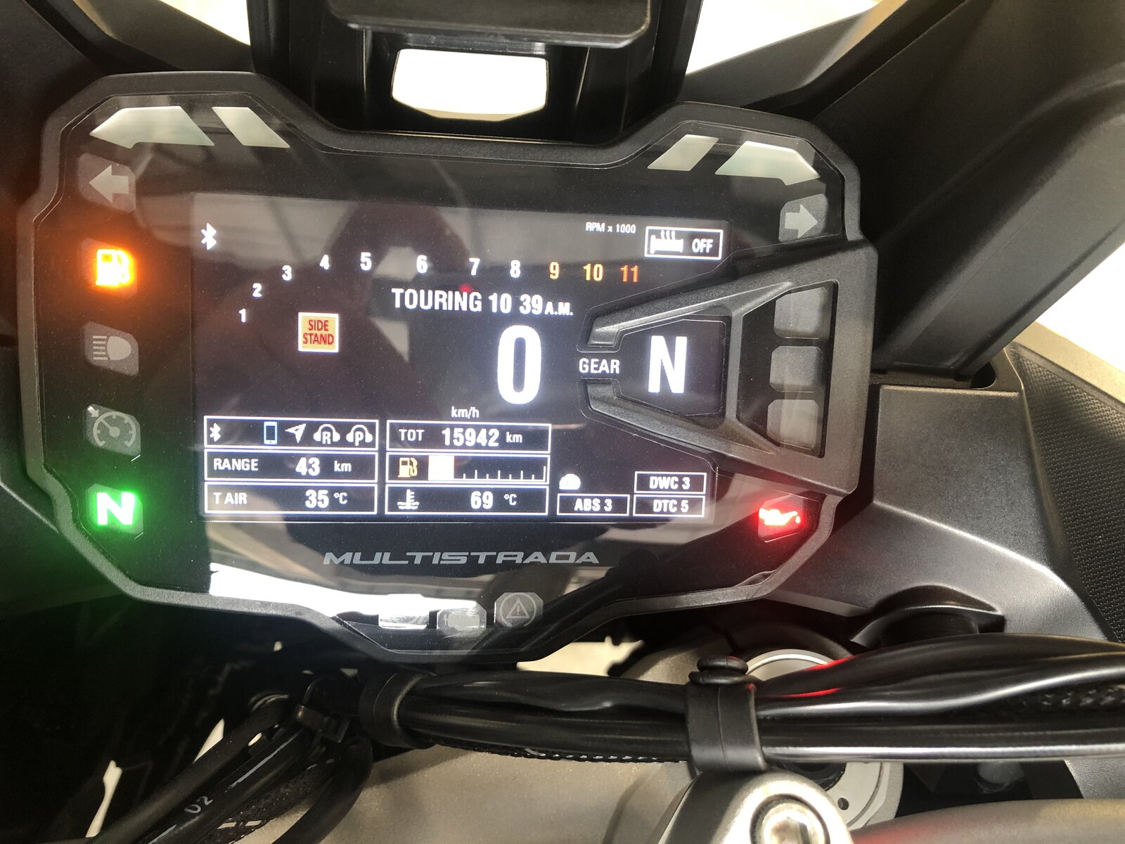

  1. Hi all, I bought a used 2016 Multistrada DVT 1200S from a private seller for about a month. The bike was overall in good condition and had no error when bringing back home. However, the DSS and generic errors are on after riding for about 100km. My mechanics did the computer diagnosis and said there are a few errors relating to the DSS sensors. He suggested to replace the 2 sensors in the front first since his experience told the front sensors are having the highest chance of failure. I am now waiting for the parts.
    I am still riding the bike from time to time and notice the DSS error is flashing all the time but the generic error light was off intermittently particularly when having some sharp turning but the light was back on again. It feels like having a loose wire connection.
    I worry if the generic error light will stay on after changing the DSS sensors but it seems not easy to identify any loose connection (if it's really the case). It would be great if someone can share the similar experience and how it was being fixed. Thanks a lot.

    Finally the errors are fixed.. but I didn't check the wires. The shop informed me the parts had arrived on Thur. After changing the 2 sensors, both the generic and DSS errors are fixed. I’m a happy owner now with no error flashing and having new tires!
