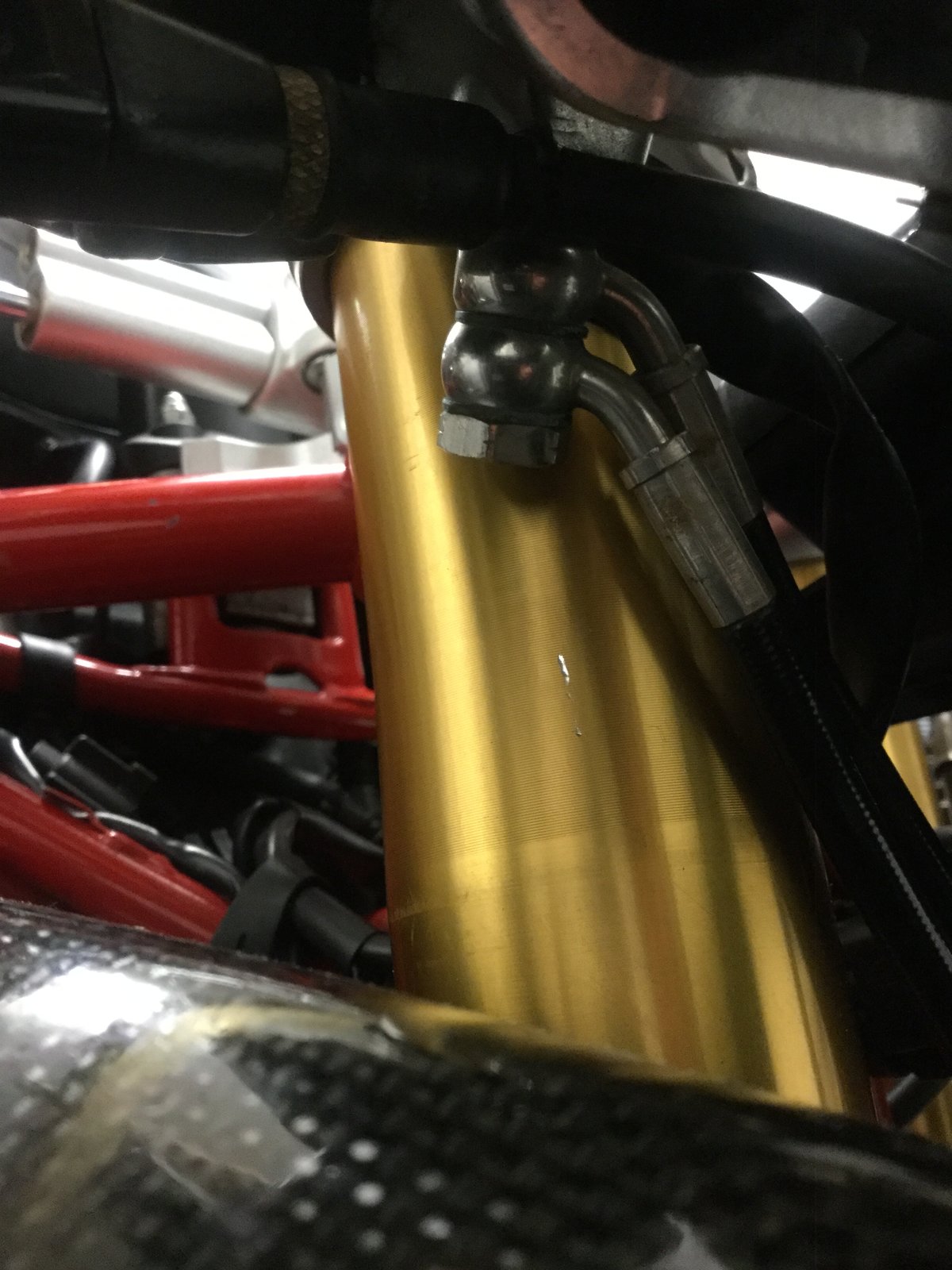

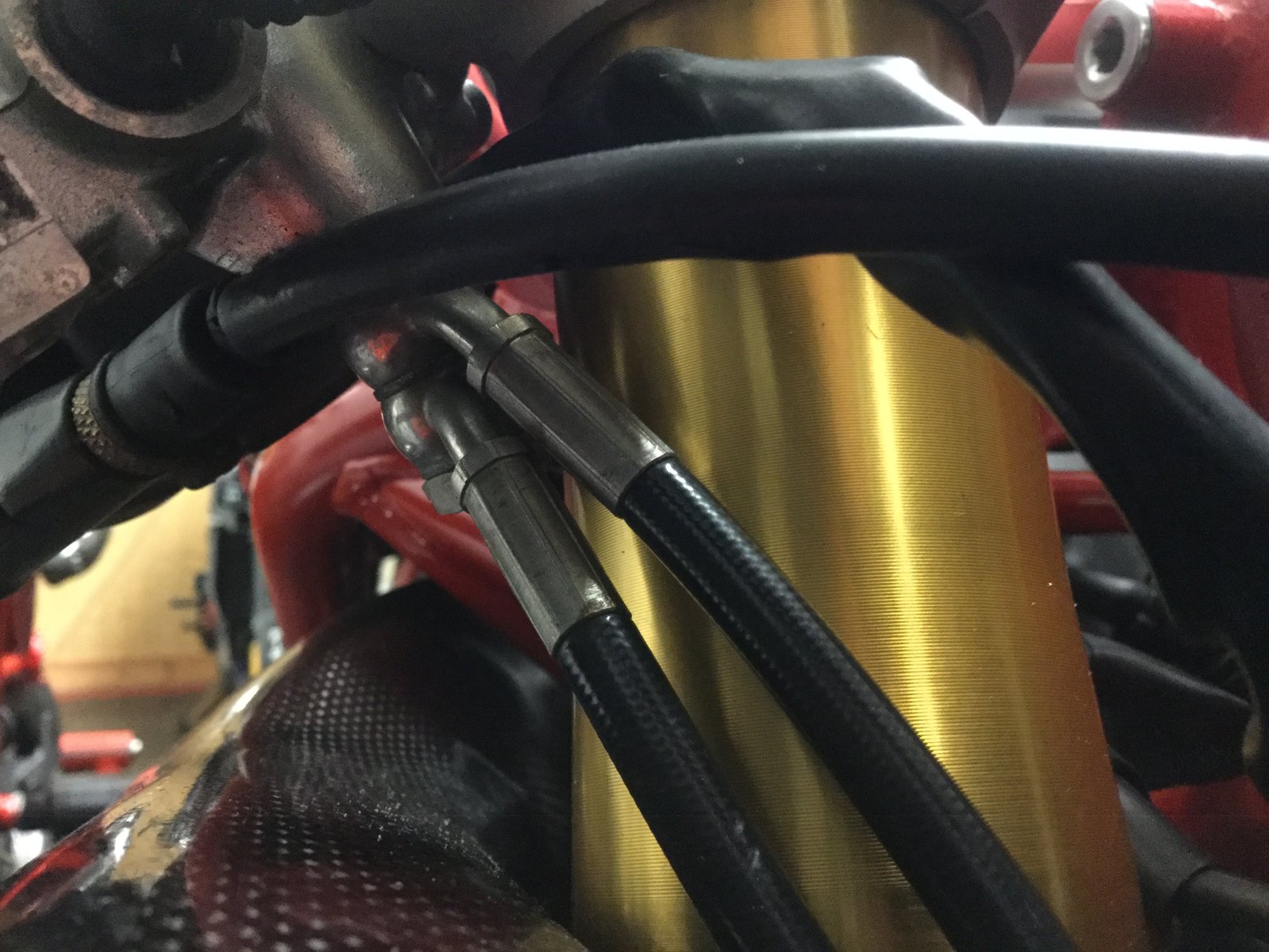

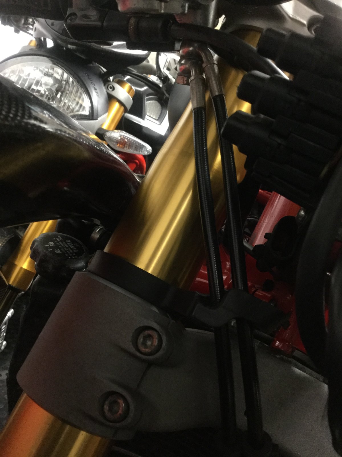

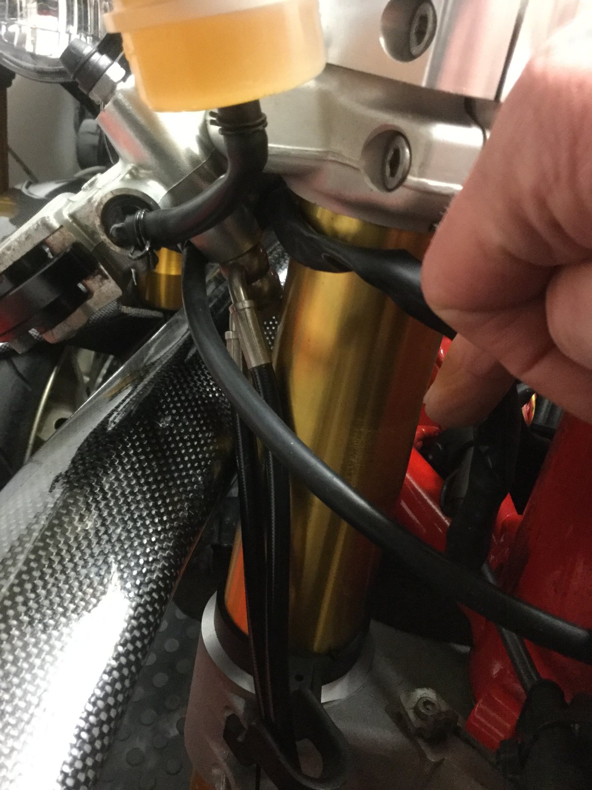

  6. 4C4096FD-CAA3-4872-8C80-3E787137D3EE.jpeg F6781328-97F0-4226-B5C7-4B707632CF0C.jpeg Here’s some pics.
    @Cream_Revenge
    To tighten the banjo, I believe I got the hoses approx correct and nipped up the bolt with an open ended spanner...then I think I undid the m/cyl clamp so I could rotate it carefully to get a socket onto the bolt head. Then I repositioned the m/cyl and checked it was all still ok and retightened the clamp. Bit of a nightmare.
    Regarding the alignment of the end banjo - it’s ok to twist them a few degrees to get them aligned so that the banjo lines up with the thread. Don’t wind them up like a spring, just light hand pressure.

  10. @RickyX your hose guide is upside down and in the wrong place (probably) did you move to get it to fit?
    Do the hoses rest against the forks at the top just under the banjo?
    CR
  11. @RickyX and now I understand why your guide is upside down and in the wrong place :upyeah:
  12. Yep. Does it work now?
  13. Yep, all good. Mine are at a slightly different angle. I think I may have a different throttle/cables to you.
    Anyway, sorted now. Losing the bracket tidy thingy helped. I've just removed it.
