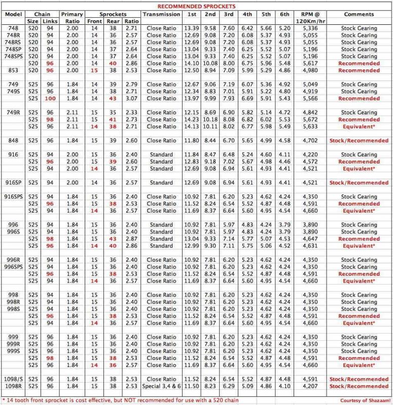

    Table courtesy of Shazaam
    14 front and 40 rear works OK, if you want to try to get the 30mph revs into a better place for quiet but smooth delivery in town try 41 on the back. Note the chain length needs to go up to 96 links with a 40 rear.
    If you want to play get a 96 link chain and an AFAM (or similar) carrier with quick release sprockets, once you have the carrier the rear sprockets can be bought pretty cheap (£30) and are simple to change. The AFAM hardened alloy 40 tooth one on mine has gone 8k miles with little to no wear on it using dry chain lube. At least double the mileage I was expecting with quite a few more to come

  4. Thanks guys, I want to retain the keep the current chain as its only done 2k so I will keep info this for when I change the whole kit for an Afam chain and HA sprockets
