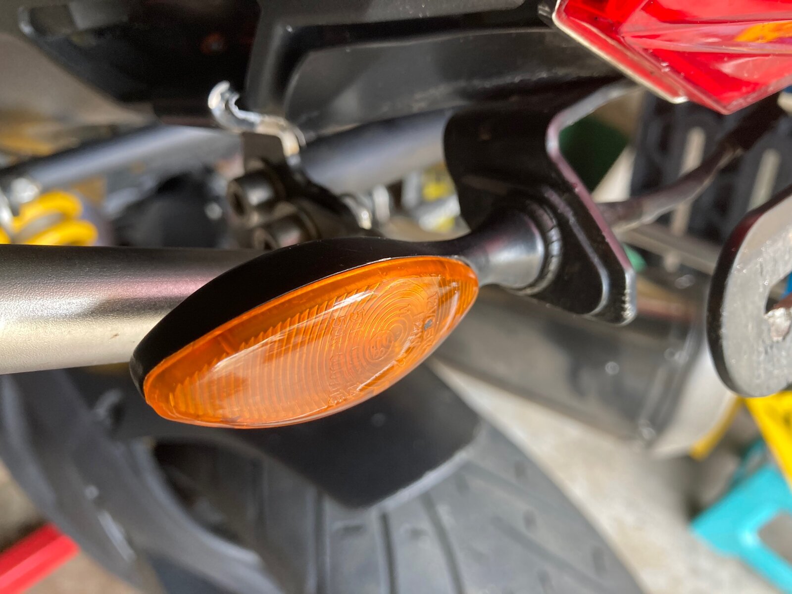

  1. I recently bought a 2014 Multi that has been fitted with an R&G tail tidy and small indicators - see photo below. However, these indicators are not very bright so I want to change either the bulbs or the indicators themselves before I get rear ended!
    Options are:
    1) - Fit secondhand original indicators but not sure what these are like
    2) - Fit LED bulbs to the existing indicators but will probably need resistors
    3) - Fit new LED indicators

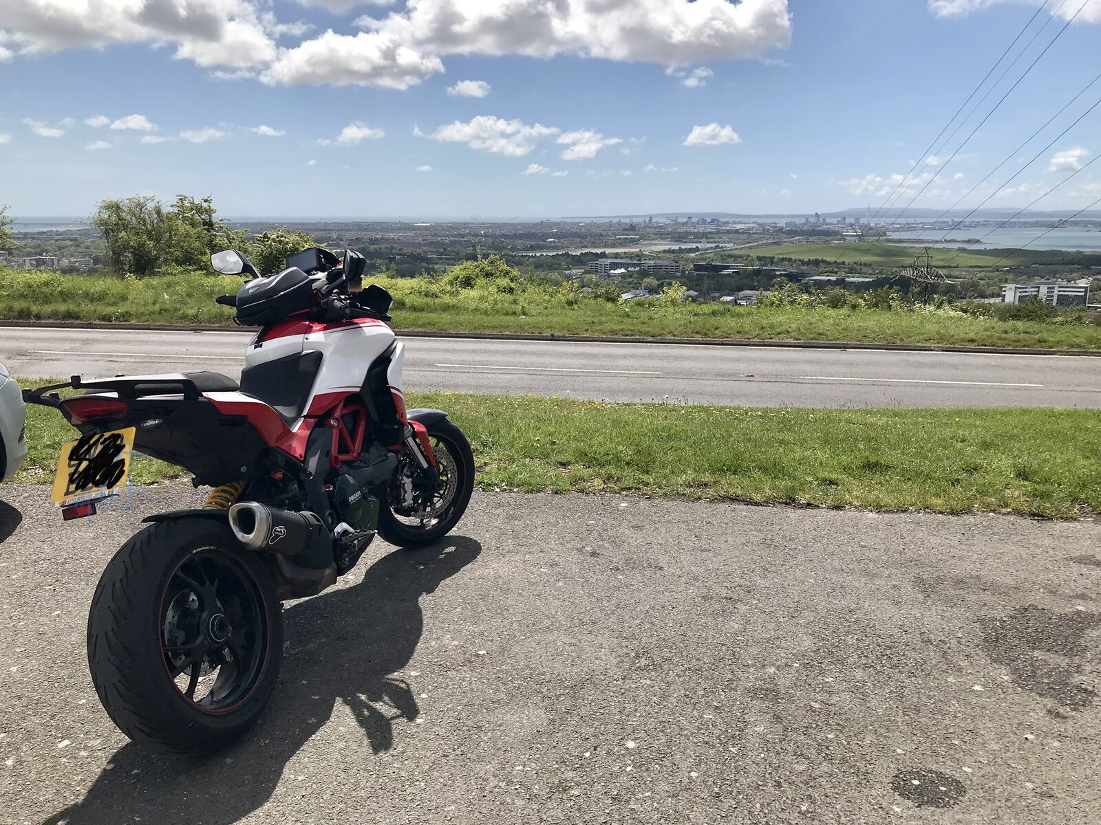

  5. As Fitted LED to mine - no issues 6D42D7A3-8A09-4A46-9CE9-06ABF3BBEC46.jpeg

  9. It does seem a bit of a mine field. Basically I would like something a bit bigger than what I have now (70 mm long) and much brighter so am looking at the MCD (millicandela) rating although some makes don't state it. I will let you know what I find out tomorrow.

  16. I have decided to try the Oxford Columbia indicators, 'only' 10,000 MCD so hope they are bright enough! Should get them tomorrow so will report back once fitted.
