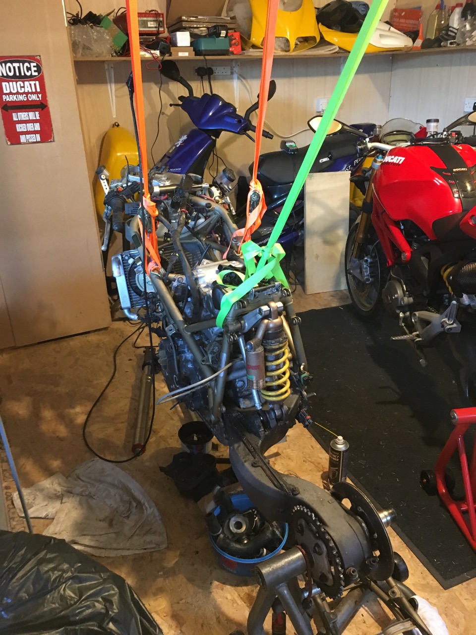

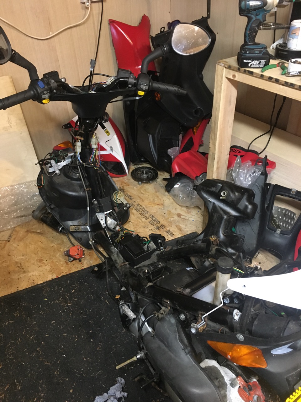

  7. Hi Gary and welcome to the Forum:upyeah:. We like introductions in the Newbie's section plus we also like A LOT pics of your bikes regardless of what state of repair they may be in. So you don't feel too bad about whatever is the current state of your bike here's a couple of pics of a couple of mine which I reduced to a pile of bits:)
    As for fork oil - 5-7
