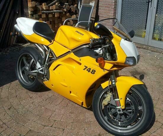

  10. I have been offered a 748 SPS, it is registered as a SPS.
    However it has a grey frame, 748 on the fairing and Marchesini 5 spook wheels.
    Is it a real one ?
  11. What year is?? Look like an R.
  12. Registred in 2000, model year 1999.

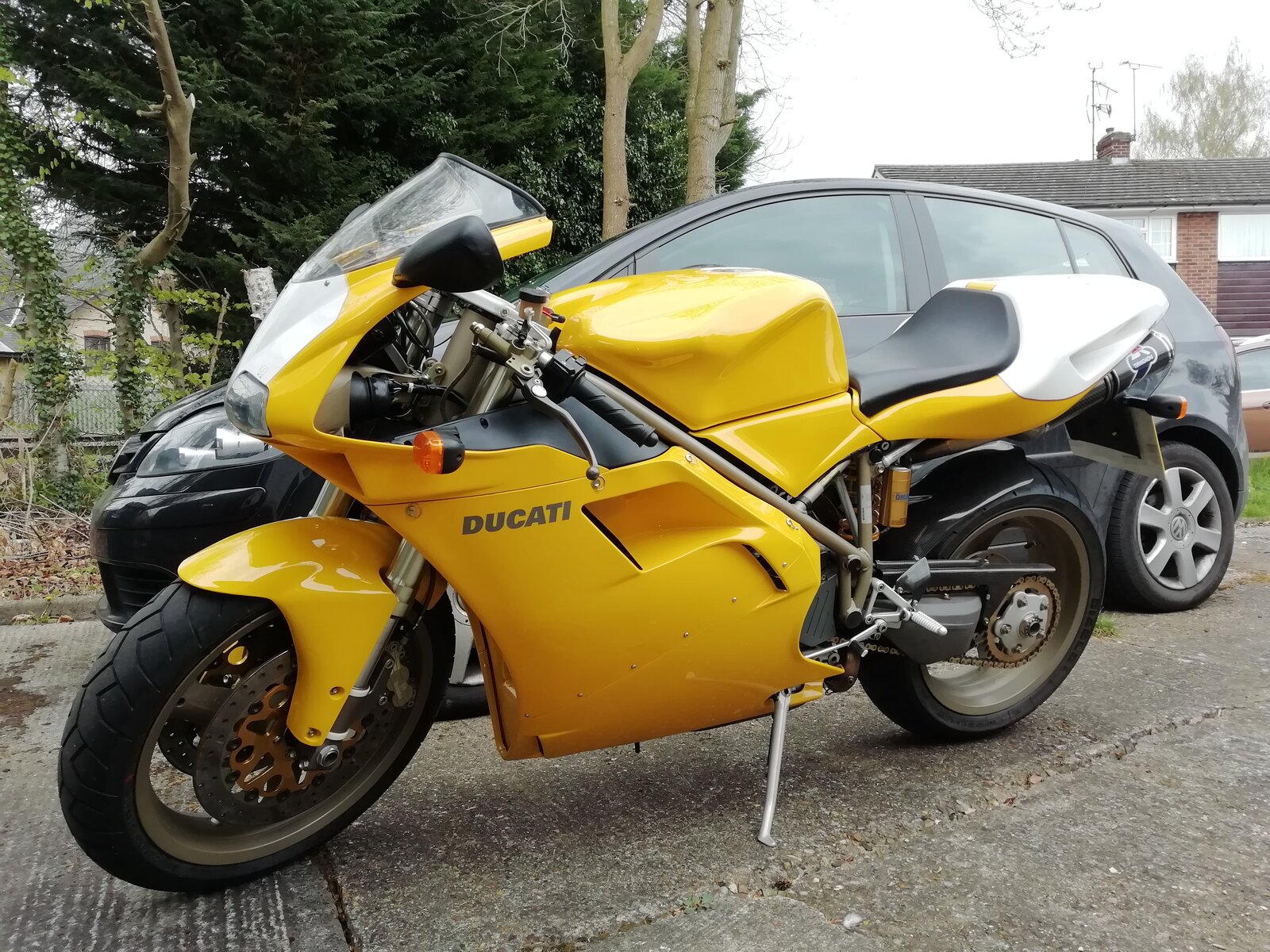

  13. IMG_20190414_112849.jpg Certainly got wrong discs and 99 MY also had gold frame and gold 3 spoke wheels. Picture of my '99 bike which I've got letter of confirmation from the factory stating what it is which the previous owner passed on to me with the bike.
  14. Thx, maybe this helps VIN number is
    ZDMH300AAXB######.

  17. You can tell whether the 2nd bike you're considering is an R or not by
    a) removing the left hand fairing and checking the cam belt covers. If they sit 5mm wide of the engine case, i.e. there's a gap then it's an R.
    b) also the front disks should be cast iron on the R and thus will show signs of rust, others are stainless steel and won't show signs of rust if the bike's been standing.
    EDIT.. (I forgot this bit), the R has a 2 piece airbox and there should be shower injectors over the throttle bodies, plus the frame is slightly different to accommodate the bigger airbox.
    It appears to have a oil cooler which is correct if an R.
    As @Hughdg said above, those are the wrong disks for the bike, it looks like someone has replaced them, the centre of the disk rotor should be gold as per his photo. However, you can always replace them with the original when they wear out.
    Also as per HughDG's photo MY99 bikes are bronze-gold frames and 3 spoke wheels, MY2000 bikes and onwards are silver-grey frames and 5 spoke wheels. IMO that's a MY2000 year bike and the front forks appear to be the correct vintage being TiN coated.
    There's nothing wrong with a Showa rear and early model R's had Showa rears.
    Apart from the external differences mentioned above titanium has been used on certain parts within the engine (conrods and camshafts I think), this lightens the internals permitting a higher max engine speed and thus extracting a few more bhp, plus this was an homologation necessity for race bikes. This will make an engine rebuild slightly more expensive but as most of the cost in rebuilding the engine will be labour the difference in price will be minimal.
    If it's an R and if it were me I'd take the R over the SP any day of the week.:)
    ps. I learnt all the above from others on this forum and have merely distilled that info for you:upyeah:

  18. Thanks Paul, yes it is a R i got the confirmation that it is a R. SP is ofcourse cheaper and the risks are less because it is a maintained bike, done 35000 miles. The R has 33000 miles done, with no history.
    The SP is still also nice, ok it is not that sophisticated as a R but had the gold frame and Brembo rims, like that...
