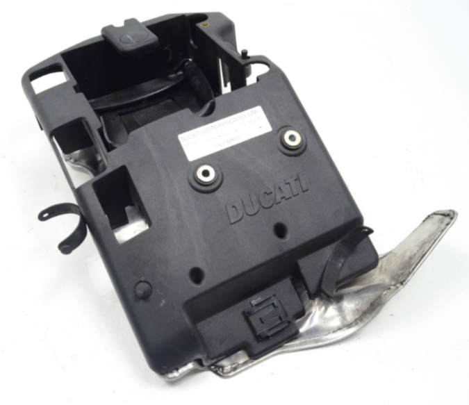

    you need to undo the black plastic battery casing get it away from the frame, behind the heat shield is the ecu where that bolts to the plastic is a fly lead from the loom that earths the ecu undo that clean that and lube..
  15. this piece of junk see the silver heat shield behind the black plastic the ecu is hidden between that and the black plastic
    Screen Shot 2018-11-08 at 07.59.32.png this piece of junk
  16. Yes I have removed that one enough times the last days that I now can do it blind folded!
