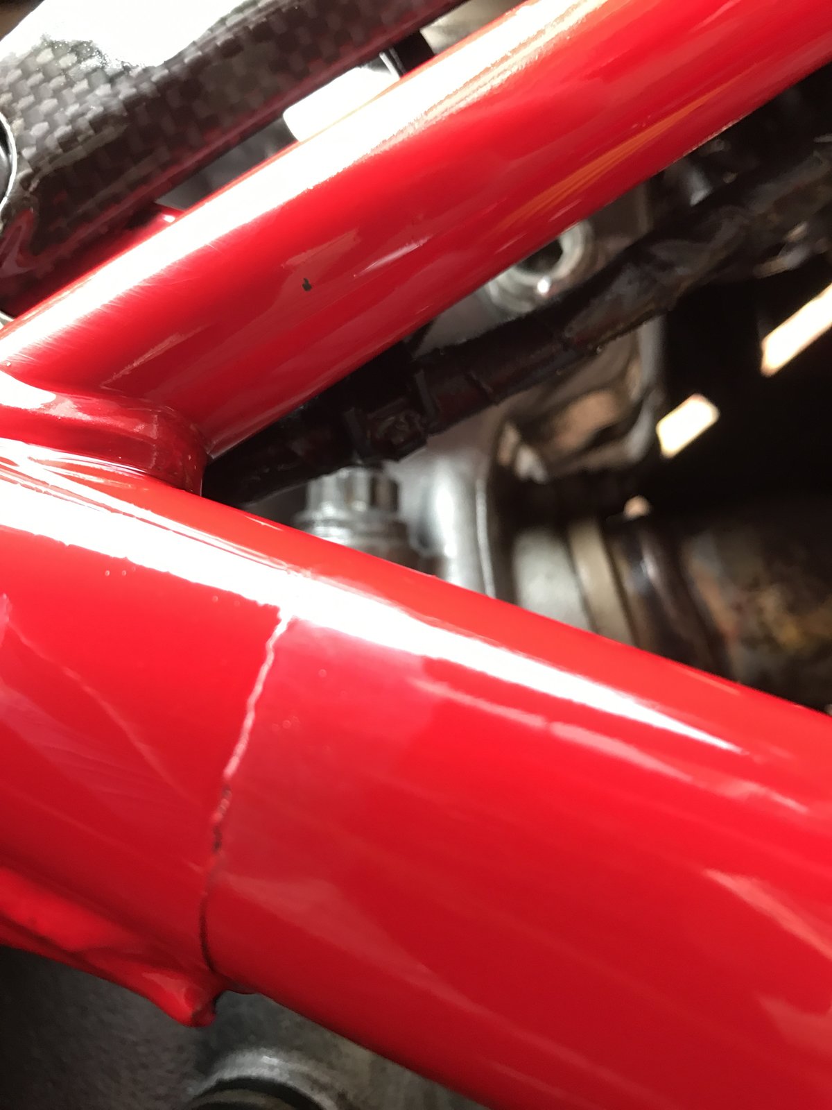

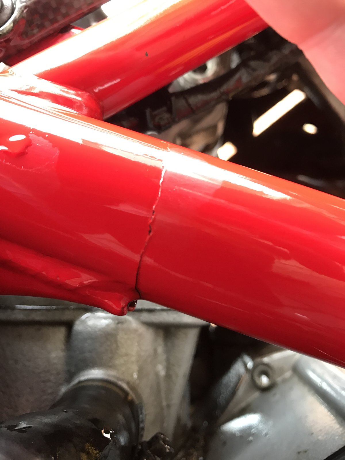

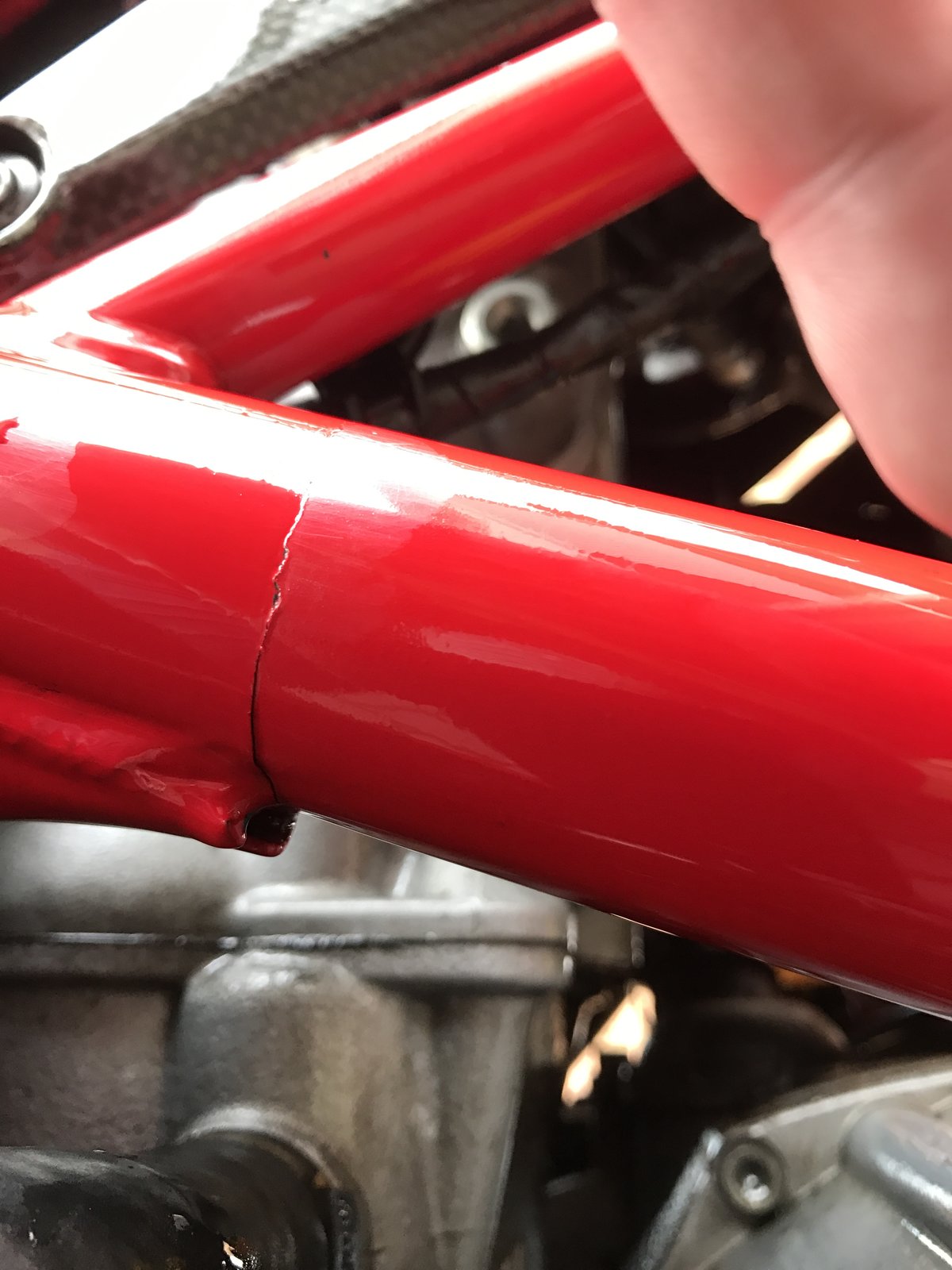

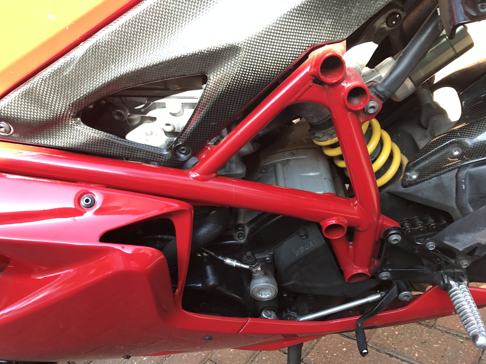

  1. IMG_6532.JPG IMG_6533.JPG IMG_6534.JPG IMG_6704.JPG Hi all
    I have an issue with my beloved 2012 848 Evo, while cleaning I noticed a crack in the frame back in February this year, an assessment has been carried out by the Ducati dealer that I purchased it from and they are saying it has been in an accident and is likely to be the cause, Since I have not had any accidents and the dealer did not disclose any before it's purchase in 2014 I cannot accept this, I believe that this is a "stress crack" caused by overheating the frame tube during manufacture, I would appreciate any advise on how to resolve this as the dealer is uninterested. Thanks, Anton

  4. Cant see that being accident damage.
    Faulty material is my guess.
    Contact Ducati UK or factory, hopefully goodwill gesture replacement.

  15. I would imagine any crash large enough to do that to a frame would also leave other tell tale marks. How is the headstock and stearing stops?
  16. I assume when you bought you did a check against Cat D/C?
  17. Me too, everything is as it should be.
