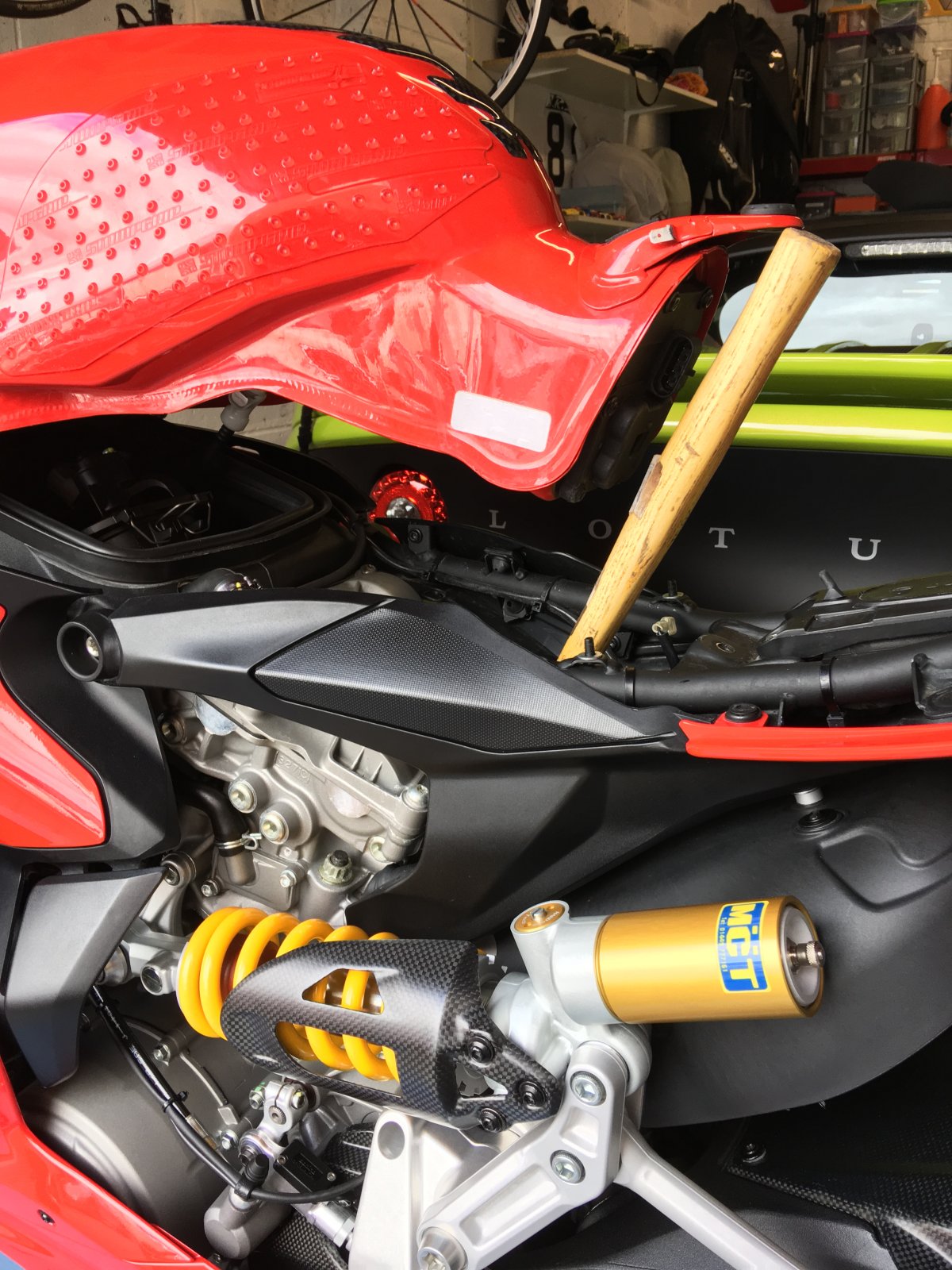

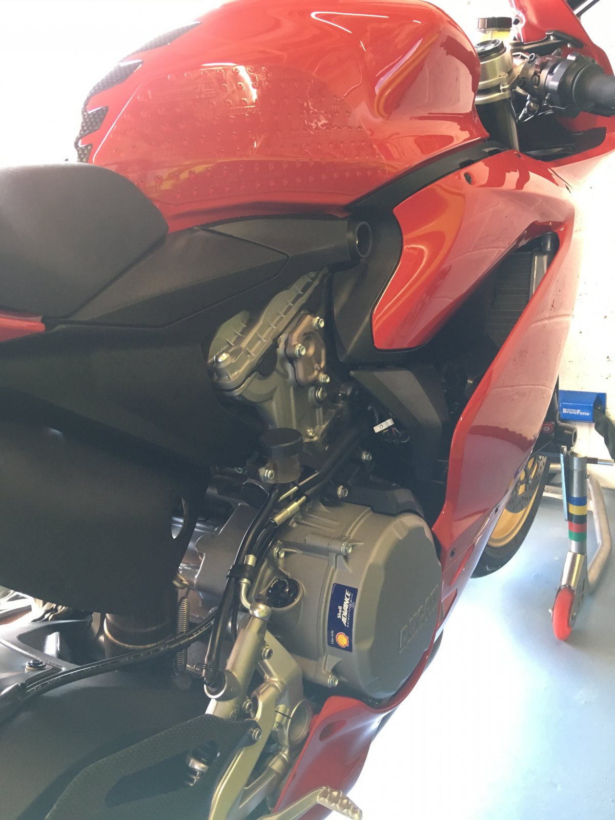

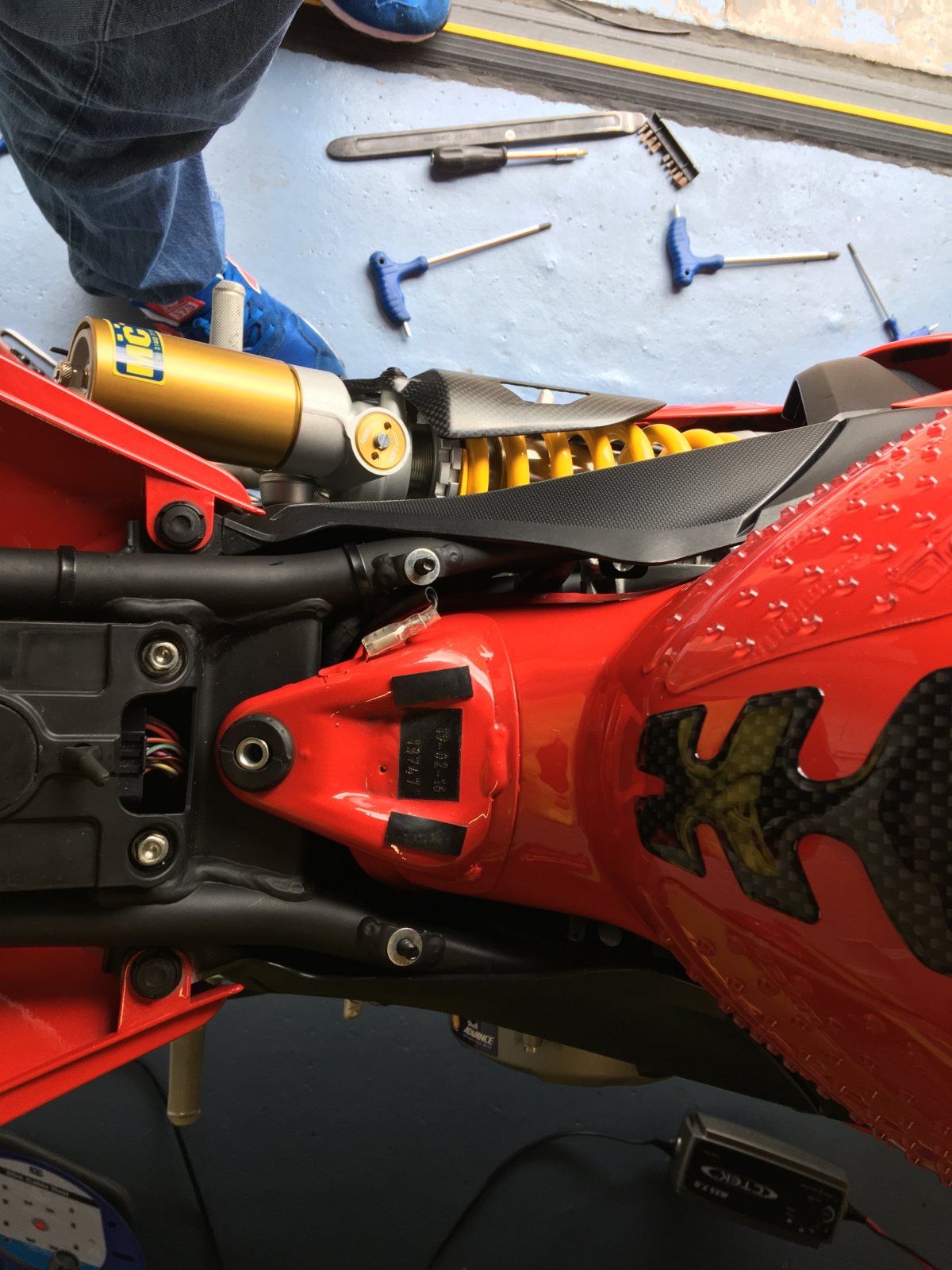

  2. Took the cylinder head plastic covers off today.
    Straight forward job I've been meaning to do for ages and not got round to.
    Basically remove key surround and side trims, loosen 2 front tank bolts but leave in.
    Remove rear tank bracket completely and pivot tank up on the front bolts enough to unplug fuel pump and remove the earth spade connector from tank body.
    Prop tank up with something suitable and remove the 4x bolts on the plastic trim and pull out.
    On the left side there's an ugly cable running across the head, pull this up out of the way and cable tie to the subframe and jobs a good en.
    Looks better I reckon

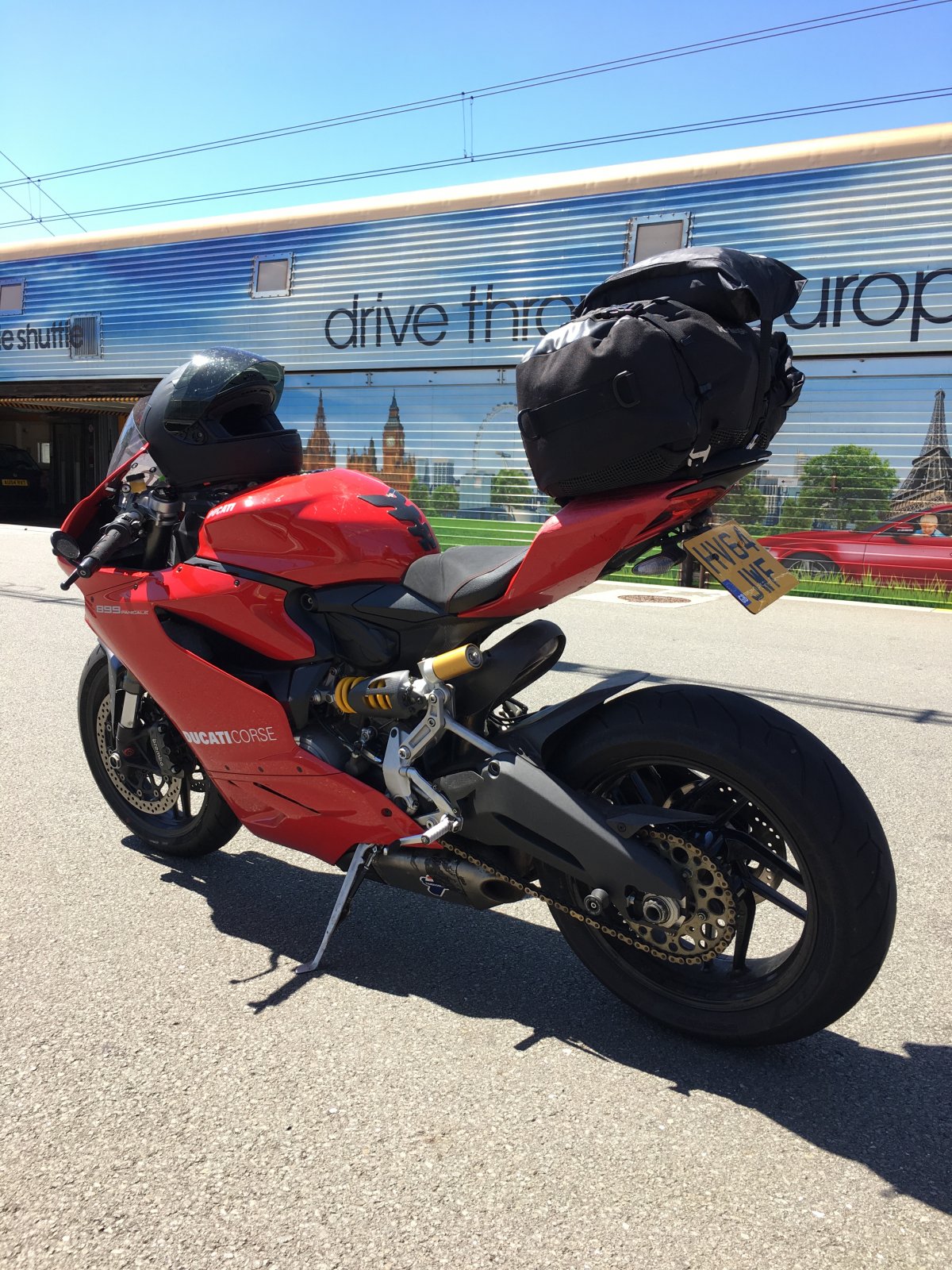

  5. IMG_7204.JPG Mines just been used in touring mode, 2500 miles in a week and it performed amazingly.
    A week in Italy for MotoGP, factory visit, a ride over the alps and then back on the Route Napolen carrying everything on the back for camping and it was awesome.

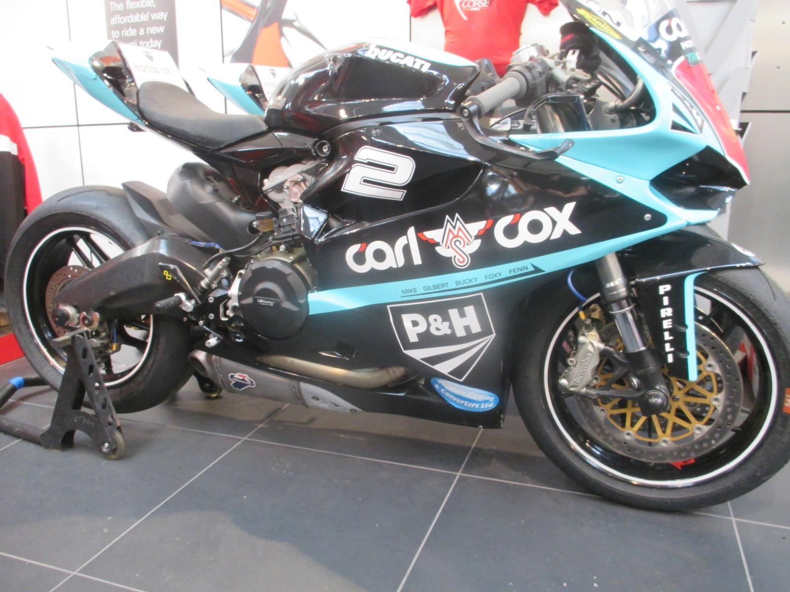

  8. Offered up a couple of newly acquired panels....
    Snout to be tried at some point.

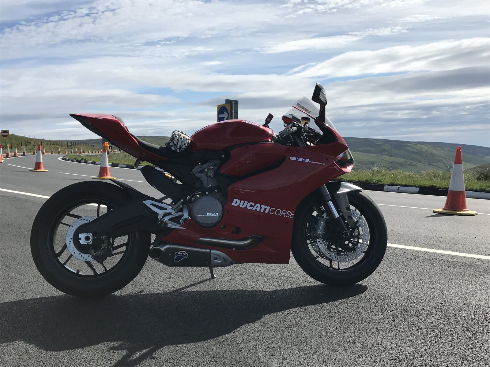

  12. IMG_0749.JPG Iom 2017 lovely

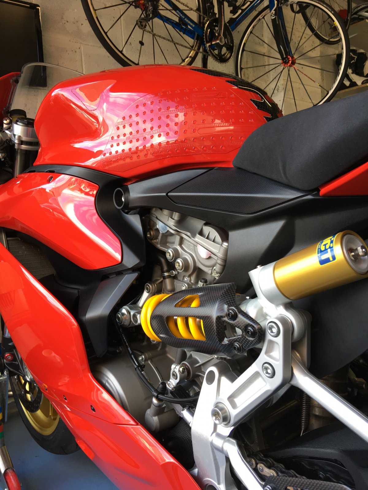

  16. Great write up @flatstick959 thanks. Just out of interest, how clean will everything under the covers stay, is bolt oxidisation likely or will everything stay squeaky clean. I'm really tempted to remove the covers
  17. Well I've done about 600 miles since removing the covers and it's fine so far. Remember the same grade fixings and fasteners are used throughout the bike and are exposed and are Fine if looked after. Also early bikes didn't have these fitted either.
    What I did notice was when I took the covers off the nuts on the large head bolts were just starting to tarnish - a soaking in acf50 has reversed most of this.
    The plastic covers obviously trap moisture after washing etc so best to have them off IMO
    Also removing them keeps your legs nice and warm!
