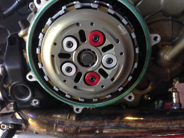

    Next question is to take the clutch cover off and examine the clutch itself but I got this photo when swapping the engine covers and is it me or should the springs be central??
    Other than that I'm struggling to dial down the judder... It's that bad I don't want to change down gears unless I really have to.
    I'll report back once I've had the clutch out and examined.

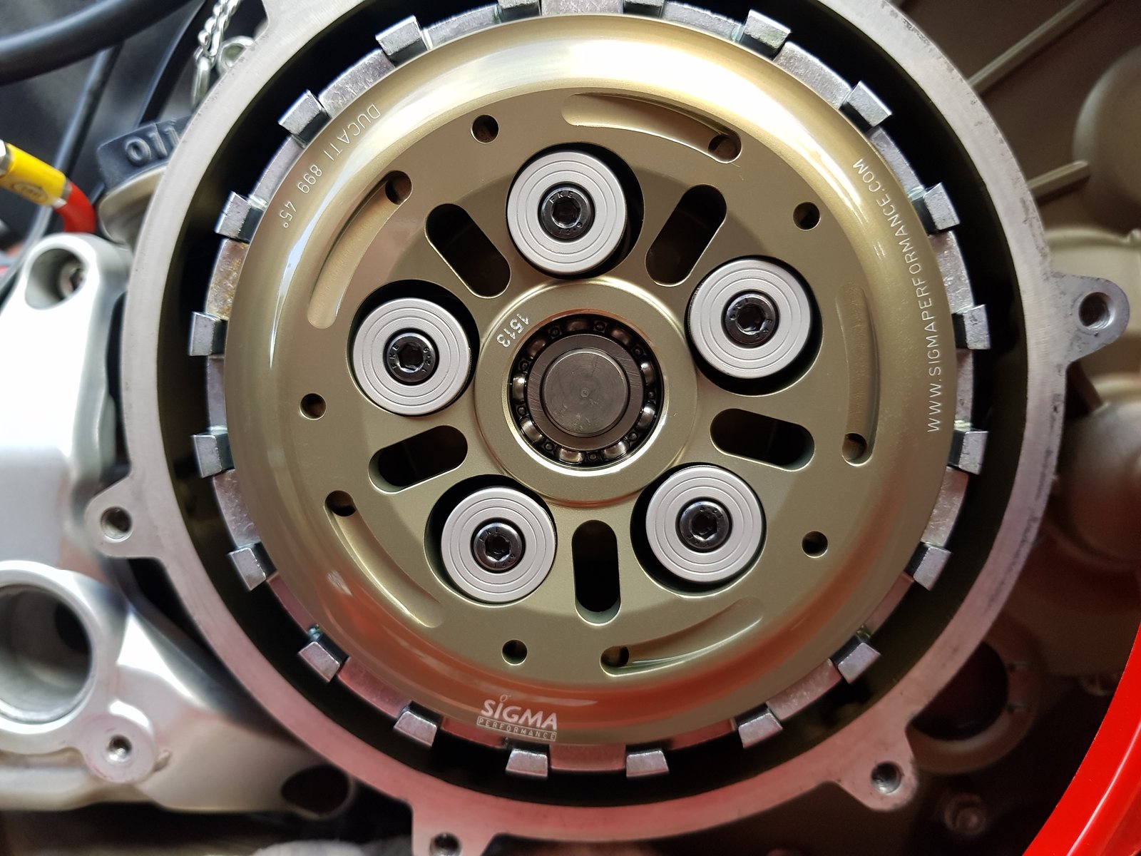

  10. Mines the same 'offset'.
    Have you checked the stack height yet? I have a load of info from Sigma if you need it.
  11. Cheers @Nelson that would be appreciated. It's Dean, I've been asking loads of questions about your blipperbox on FB messenger.
    Glad to see you springs are off centre like mine... rules that out as well.
