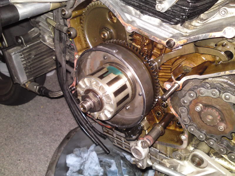

Fitting hi-comps? Good choice! Best sort your timing out or your bike will run PROPER hot. This is 1.2kgs/2.64lb lighter than the standard flywheel and with 32° of advance instead of the standard 36° this will set your engine up PERFECT to fit and run hi-comp pistons without it running too hot or other dramas... Ducati 900SS M900 600SS 600 SS lightweight flywheel fly wheel hi comp pistons | eBay

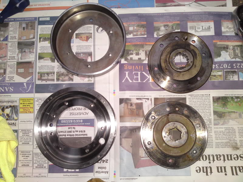

Update - has arrived today, have stripped off the sprag etc ready, will get it machined the next couple of days and get it listed...
New flywheel has been received, all marking holes drilled deeper, 4mm machined off the drum width & is now ready for sale! I am looking to recoup my purchase costs plus my time, fuel and trouble - Posted First Class Recorded for £55 Paypal/Postal Order.
