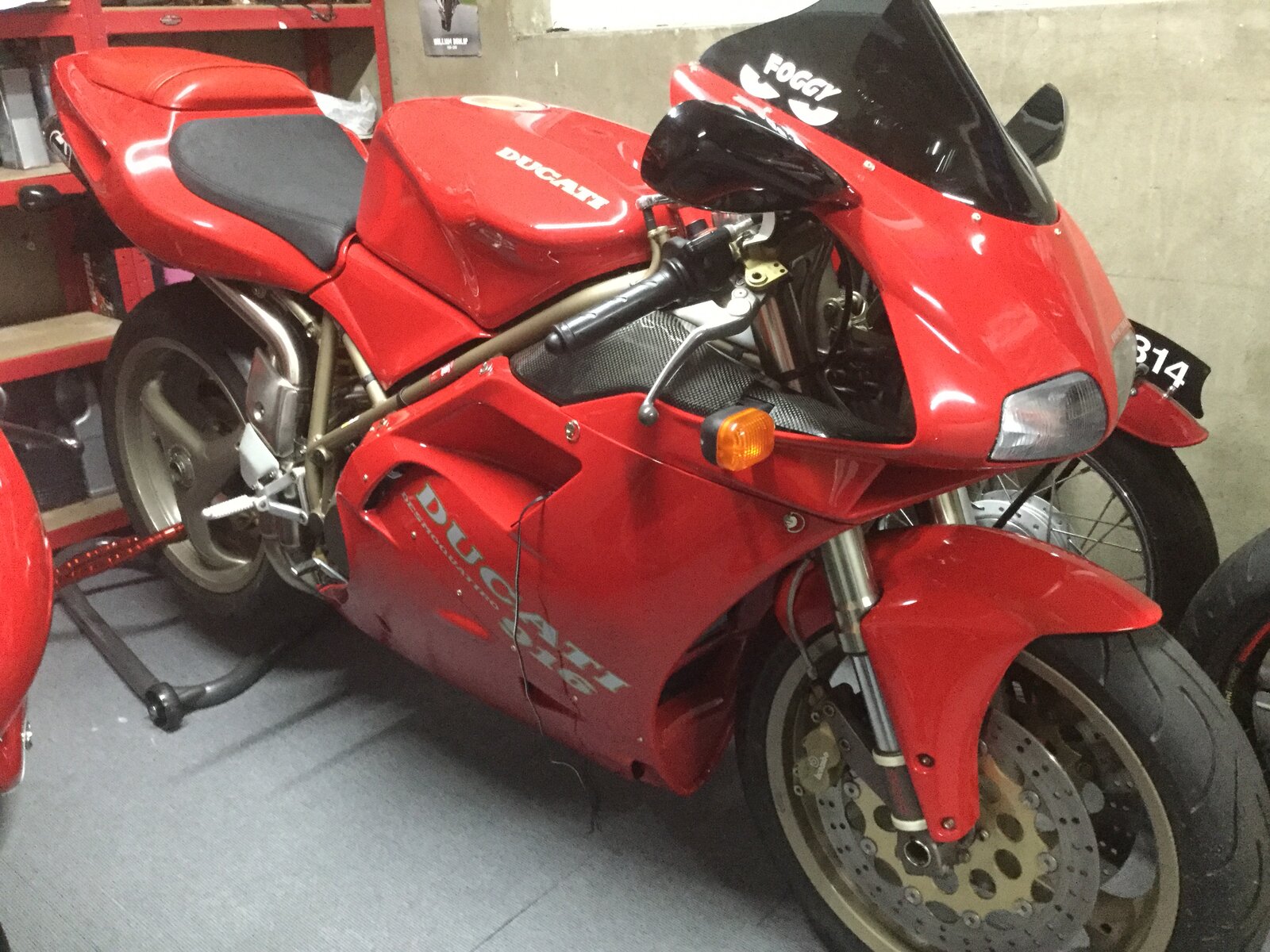

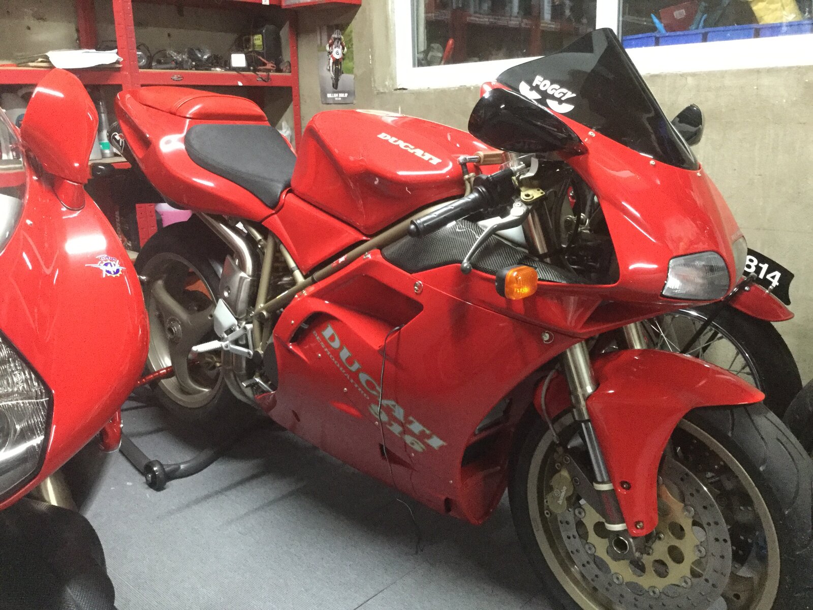

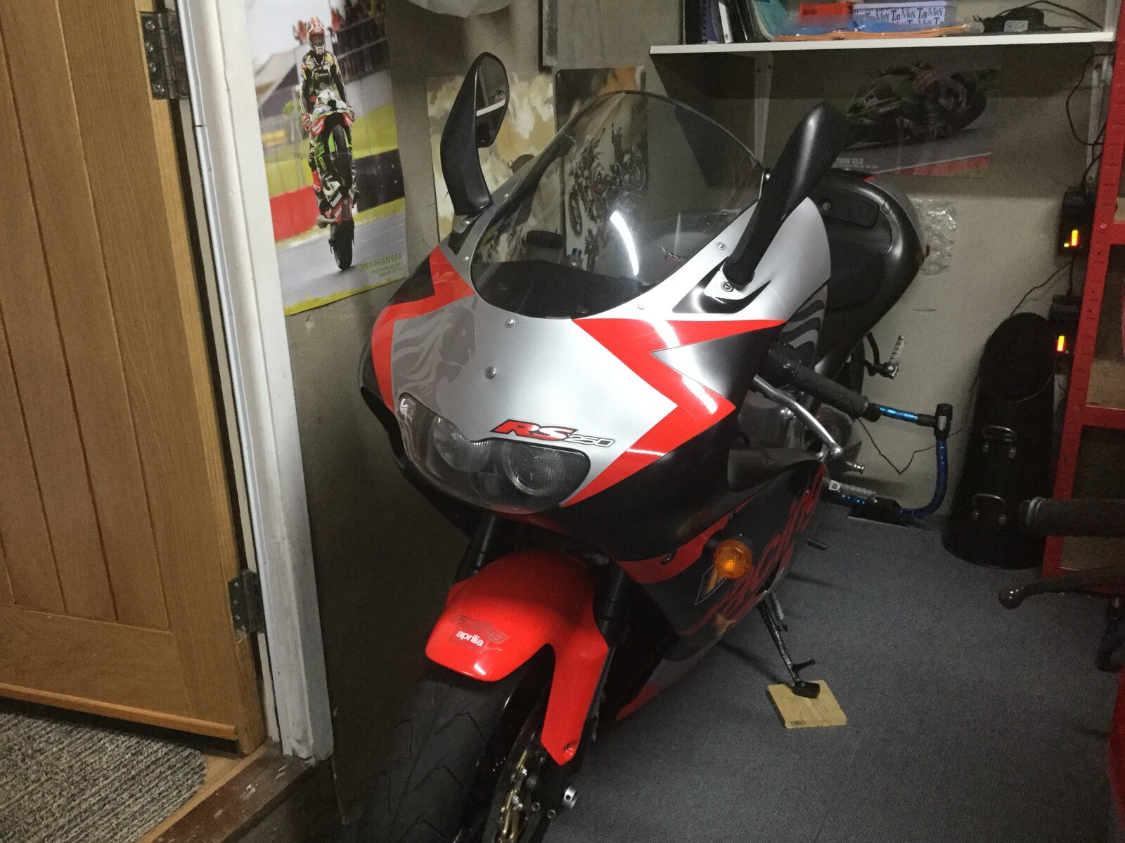

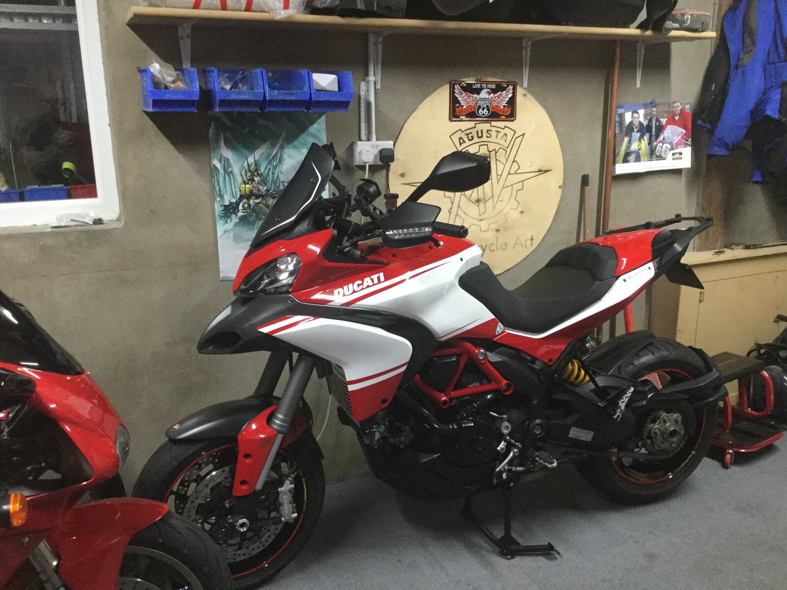

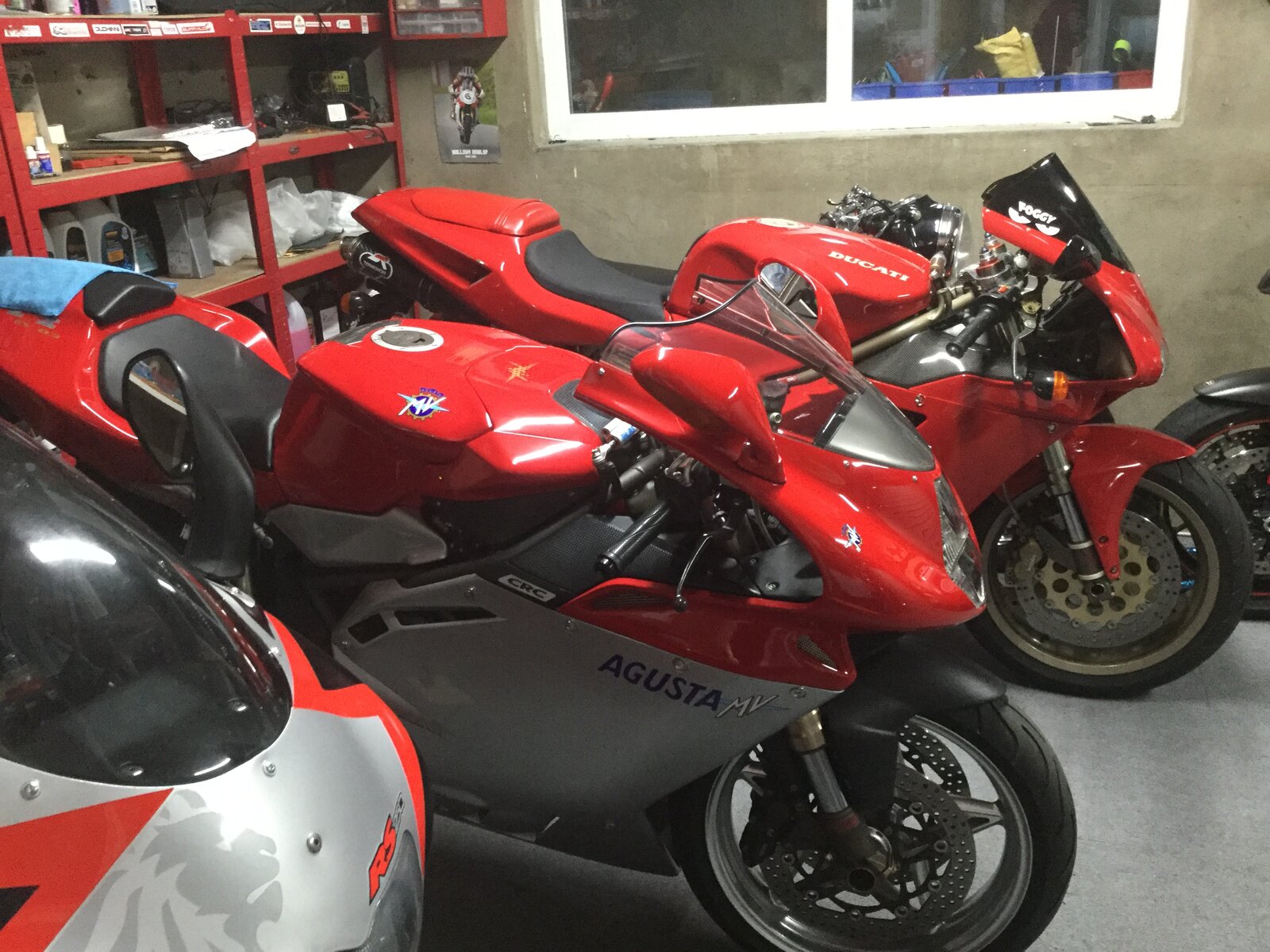

  7. Thanks for the welcomes guys these are my bikes and the reason why I am always broke!

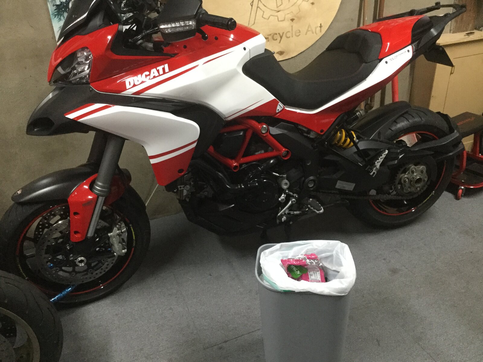

  8. :weary_face: No bin
    Guys there isn’t a bin :sob:
    • WTF WTF x 1
  9. Oh yes there is,the coal bin.:eyes:

  11. Is that better?
