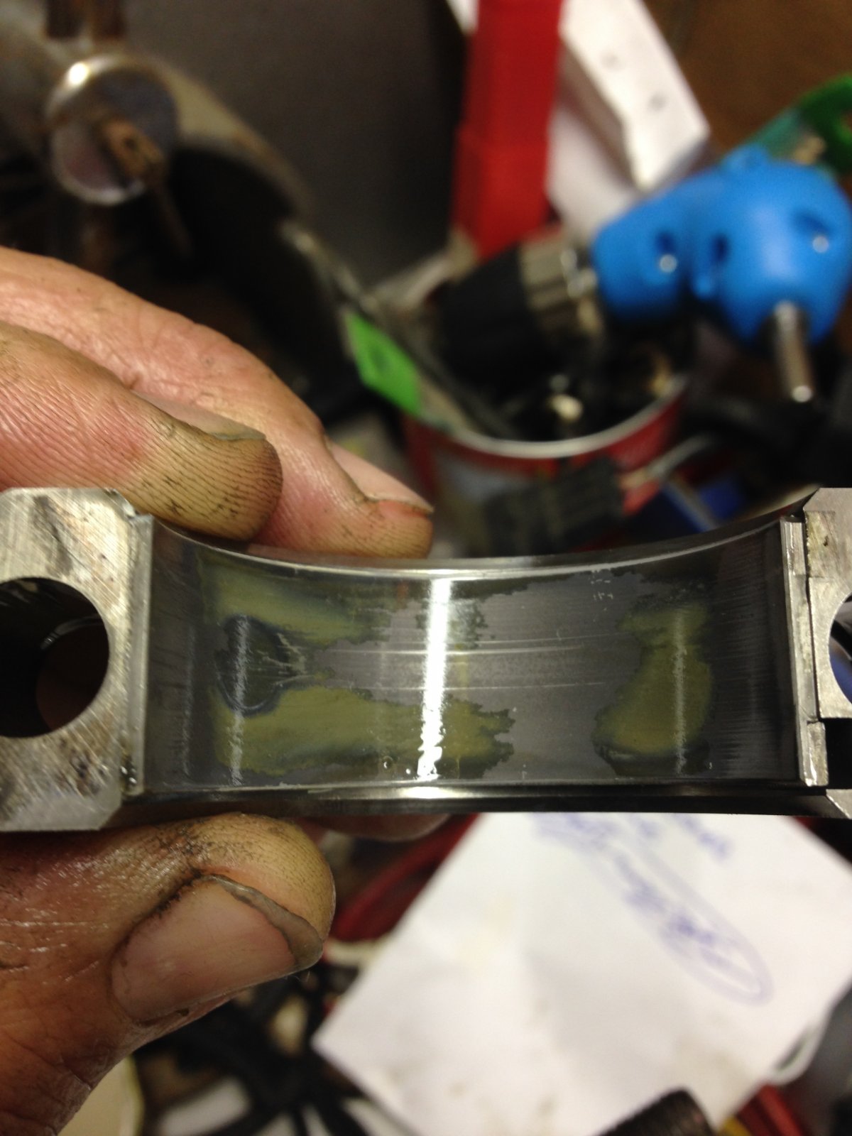

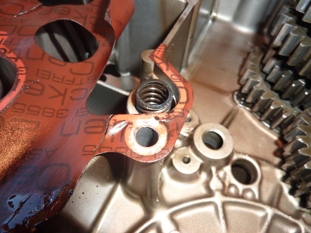

  12. Well finally split the cases today only problem was the gearbox refused to stay in the right hand case an I found a spring......... It's approx 50mm long and same internal diameter as the selector fork pin......... Where does it go??
    Good job I split it though the big end bearings were shot
  13. This one?;

    That's the one :grinning::thumbsup: thanks
    And is that a gasket mine just had gung
    #15 tazmantic, Nov 4, 2015
  16. Yes mine had a gasket as that was how they made them back then but it was reassembled with just threebond.

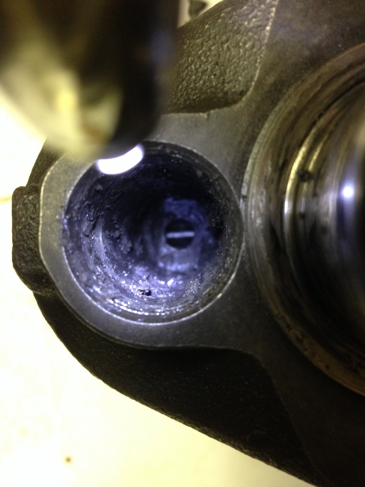

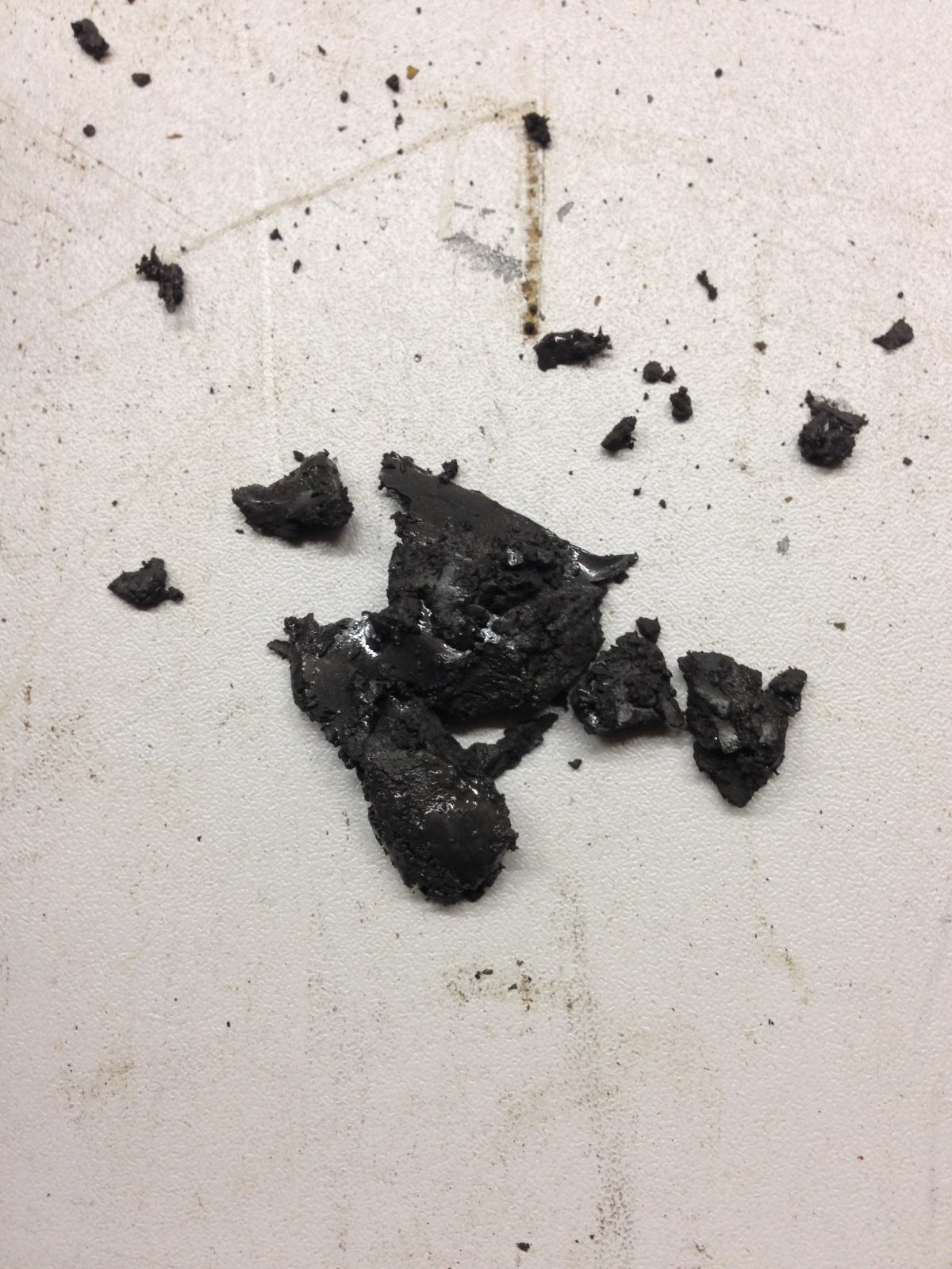

  18. Unscrewed the plugs out of the crank shaft tonight and found it full of black crud could this be why the big ends were shot, or is it the big ends :grimacing:
  19. Oh right well it had deff trapped some sludge all be it dried, should the plugs be locktighted back in Cus the big plug was loose :0/
