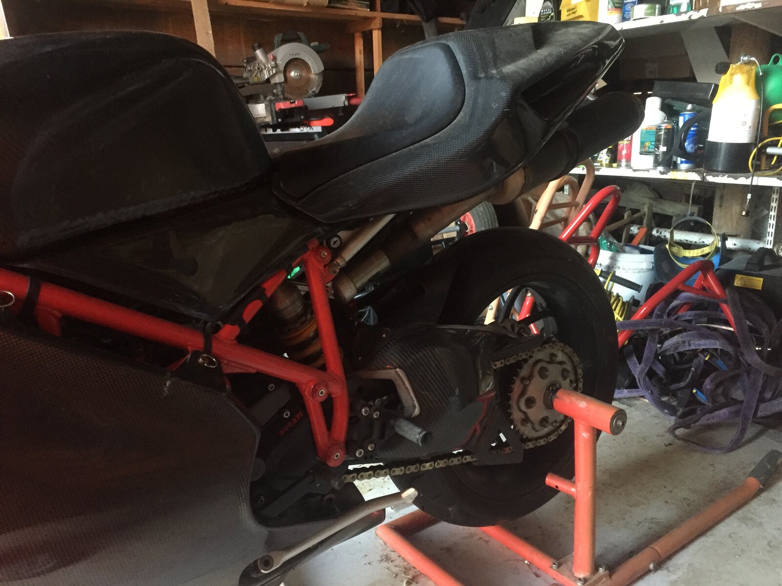

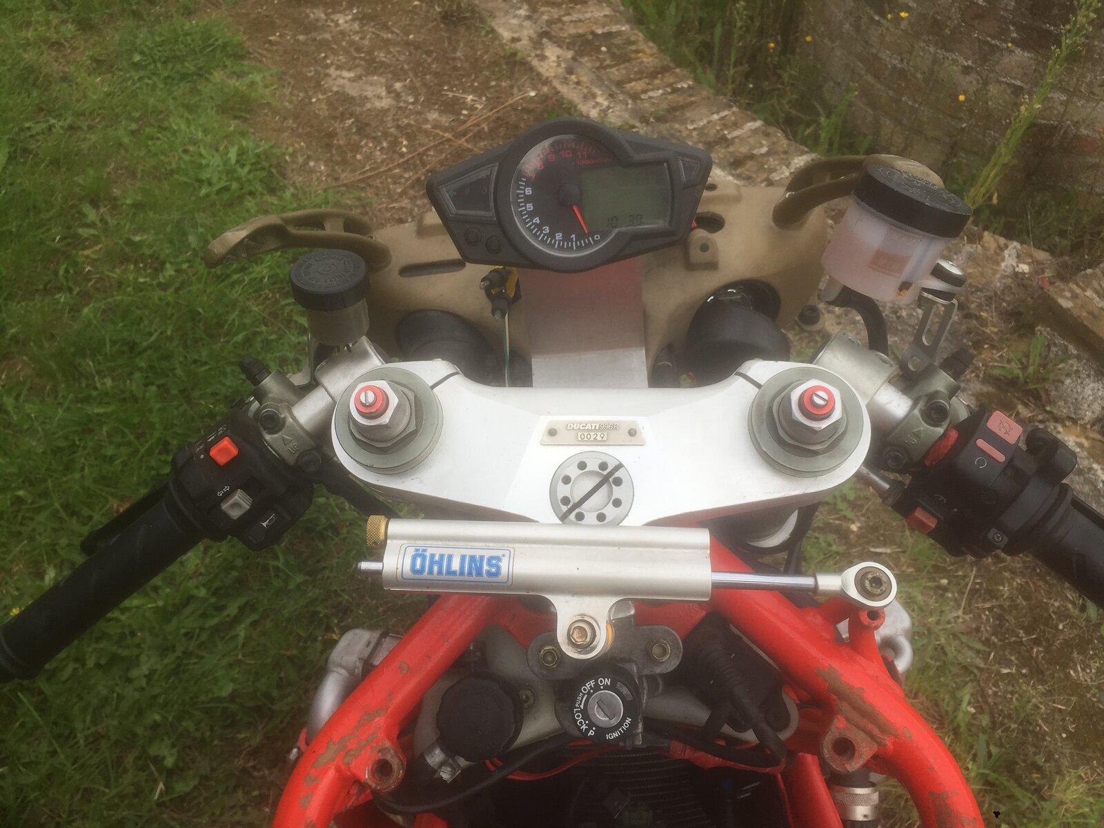

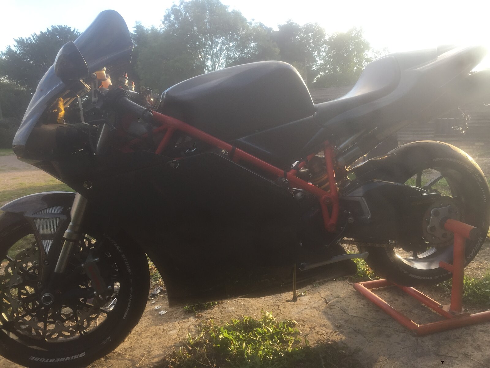

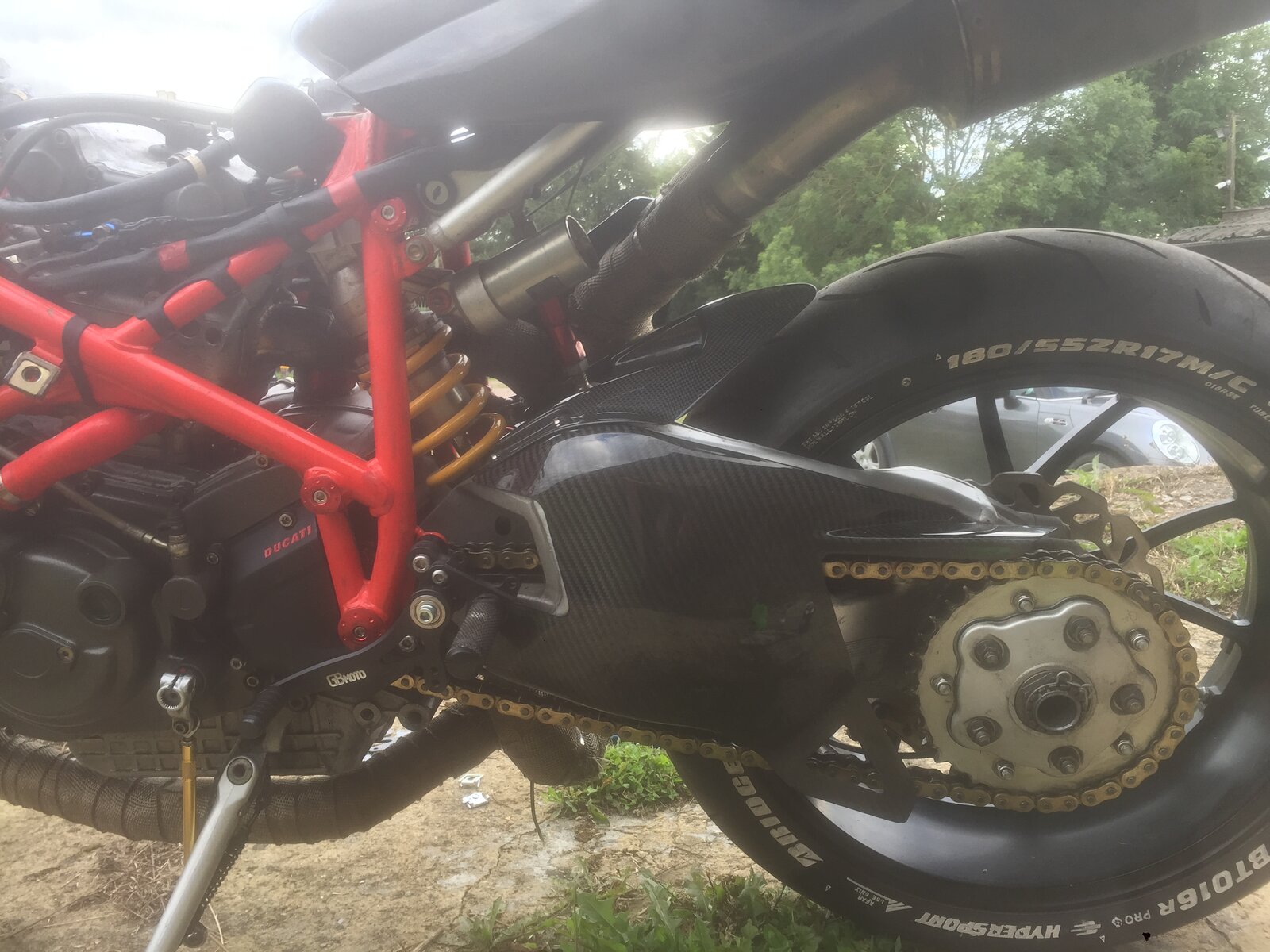

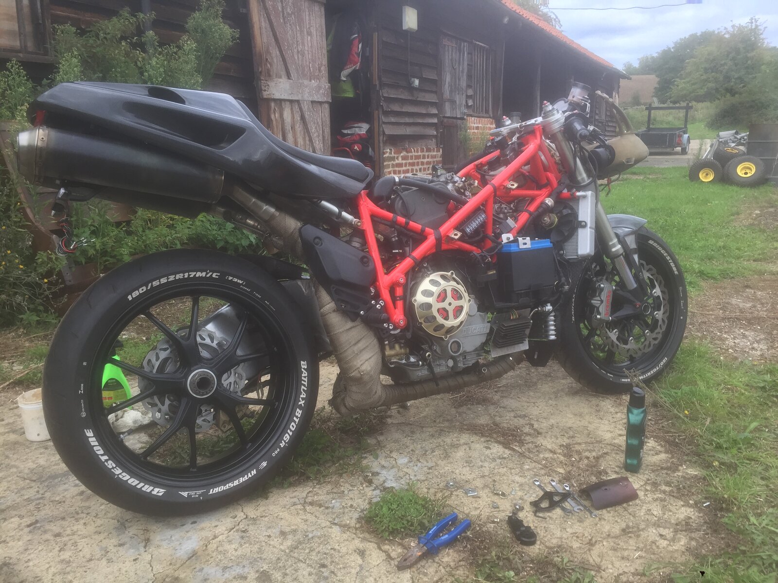

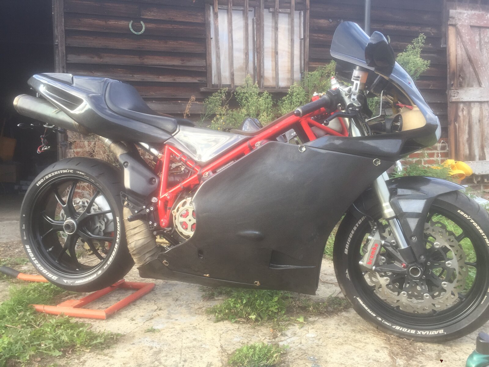

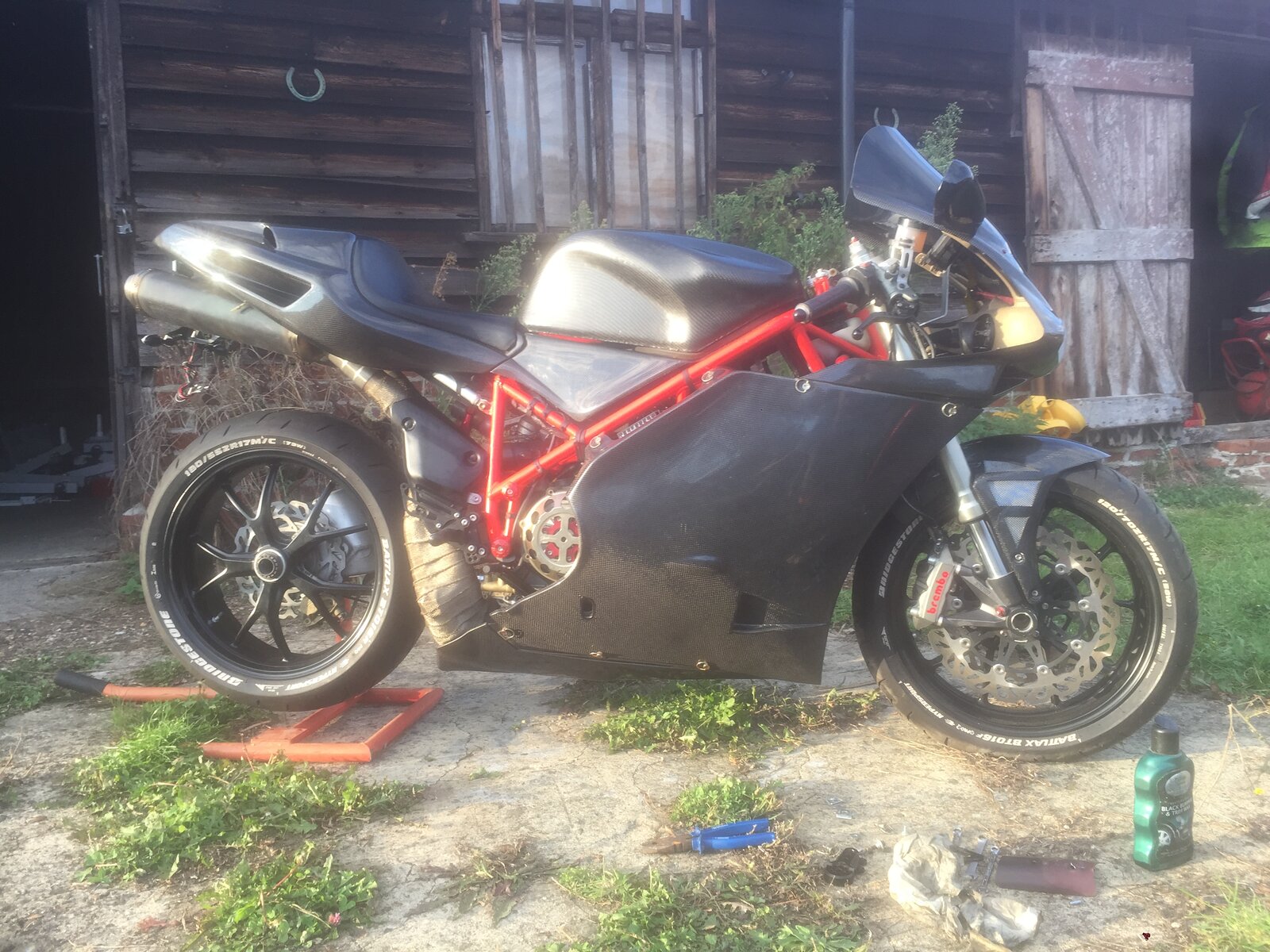

  1. ok.....so here we go....and where to start?
    firstly what ive done so far!
    1198 swing arm
    1198 wheels (brand new out the box)

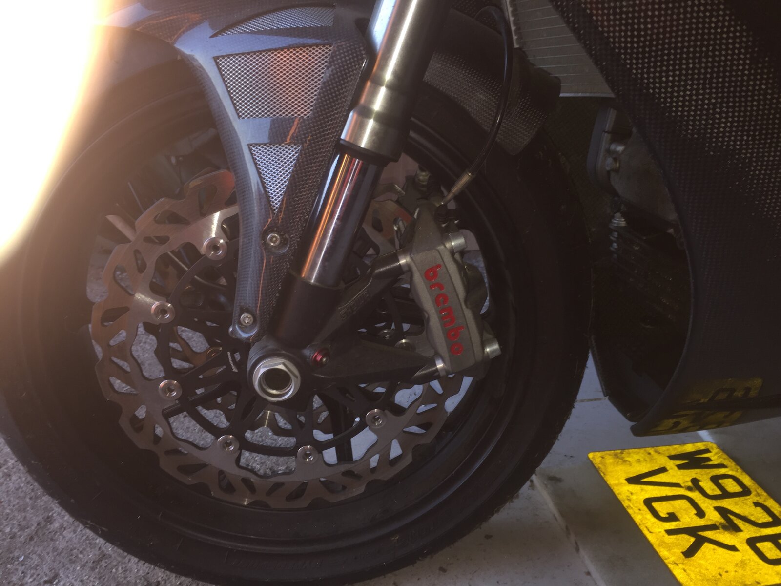

    wavey discs (armstrong) 320mm front
    1198 shock
    custom swingarm pivot rocker (so the swingarm works properly)
    did chain and sprockets (i cant remember the tooth count)

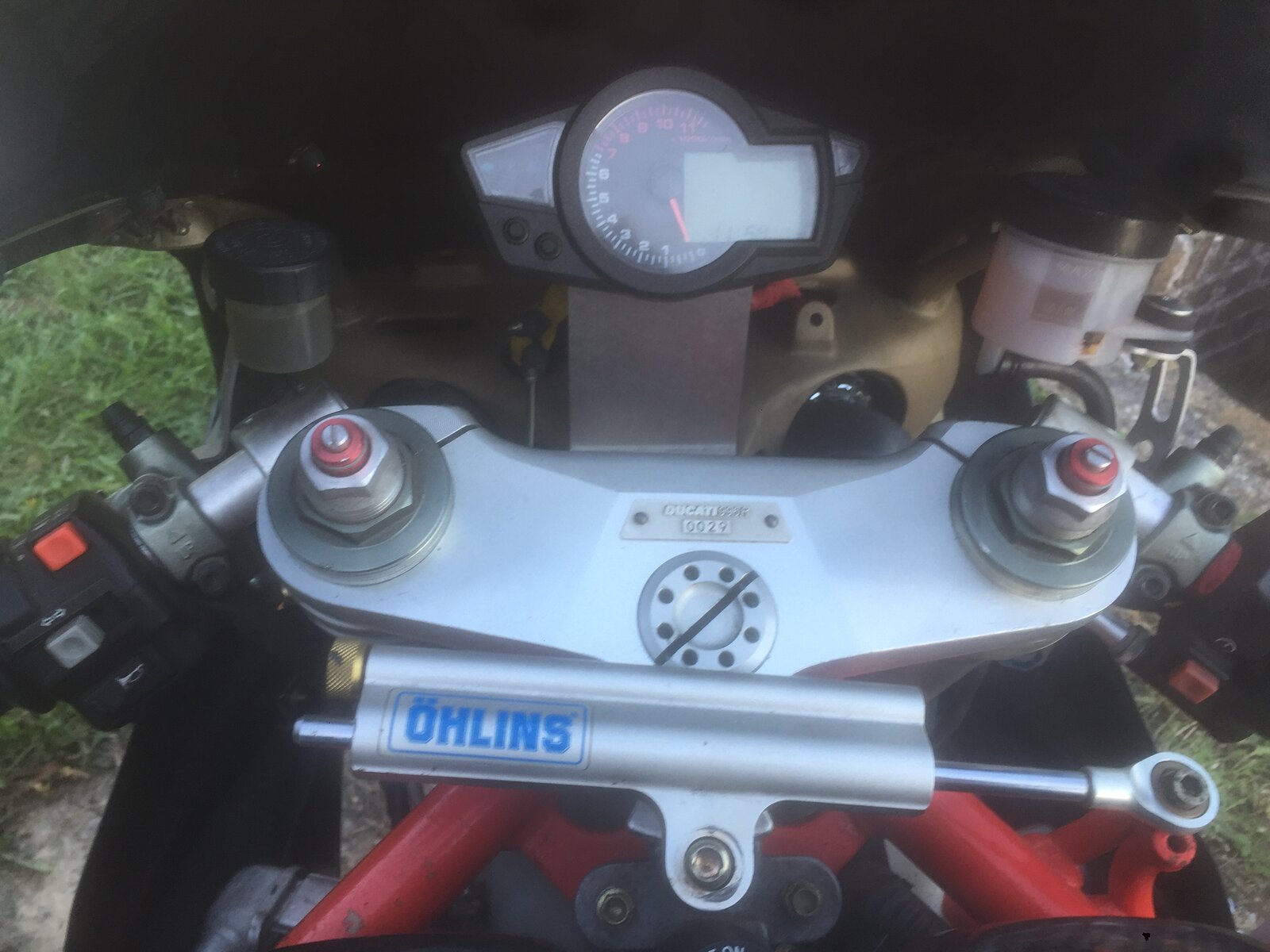

    1198 forks
    digital dash
    speedo pickup moved to the rear of the bike (digital)
    p4 callipers with 5mm spacers to fit the bigger discs
    1198 clipons + brake and clutch masters
    shorty levers

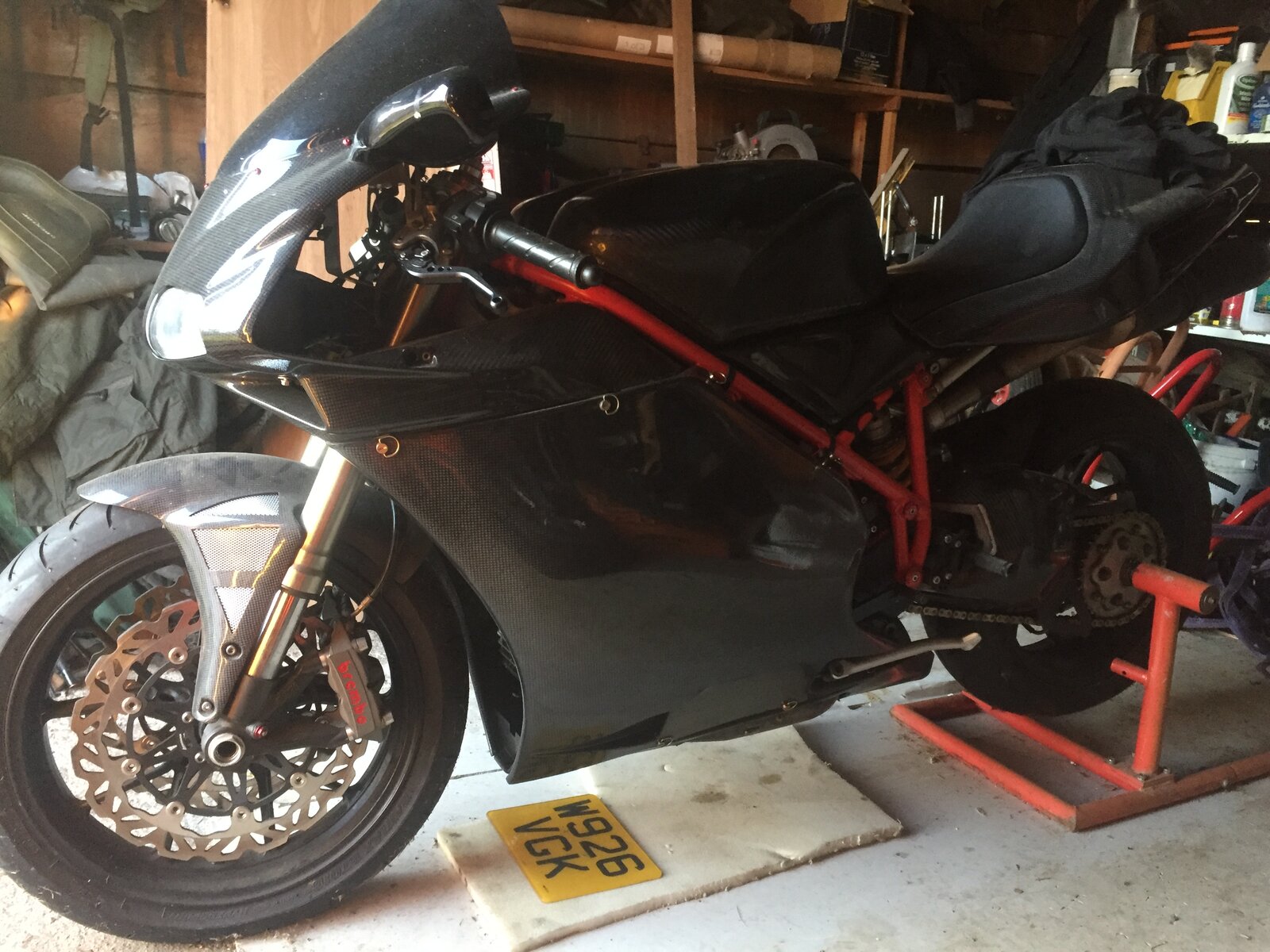

    996r rad (twin fan)
    new oil rad
    full all round naked carbon fairing 996r style

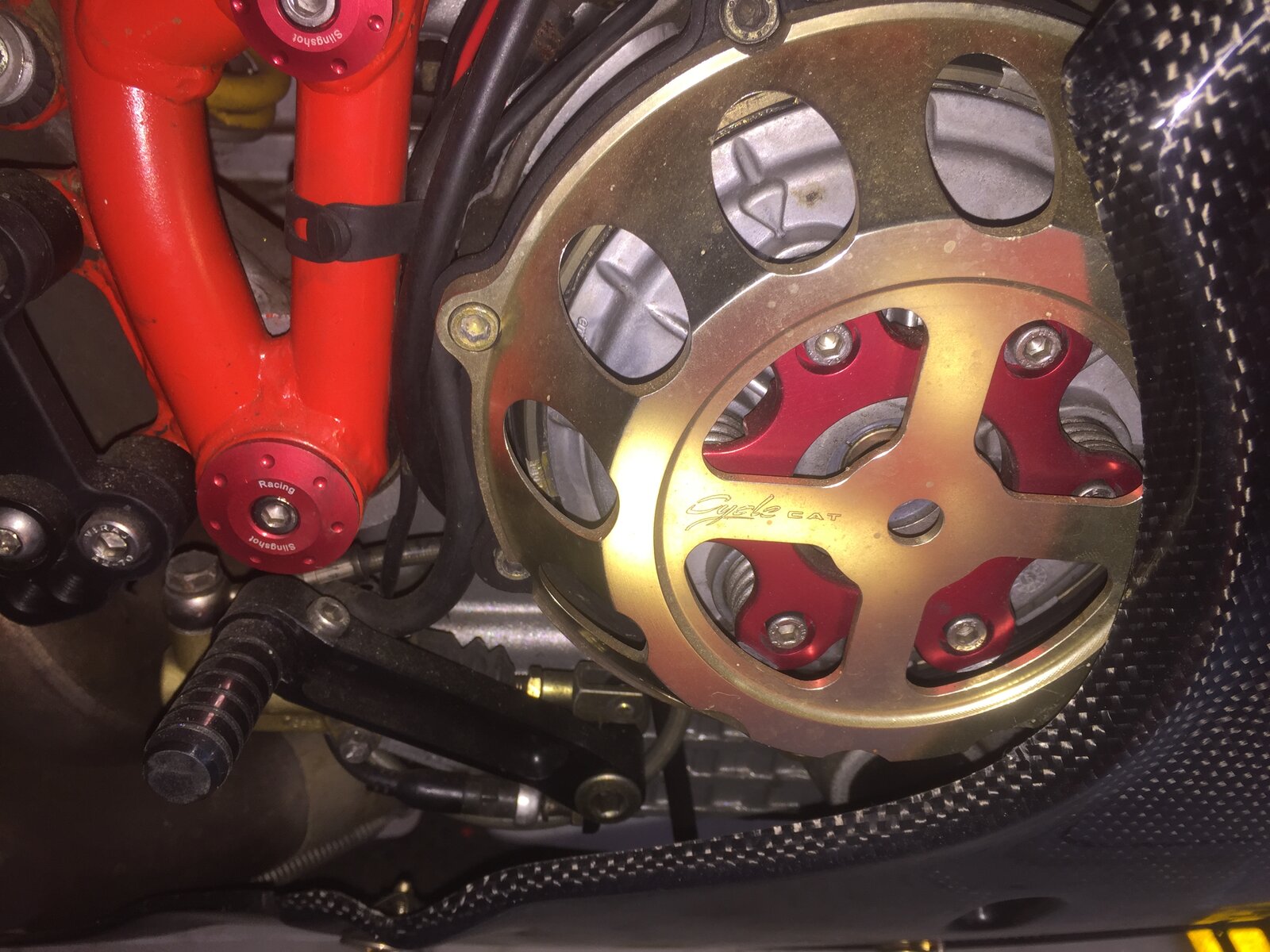

    engine.....
    lightened flywheel
    plank con rods....lightened balanced crank
    engine case loading reduced
    sps pistons/heads
    squish reduced on heads by 1mm
    sps cams
    748r gearbox
    999 starter sprag

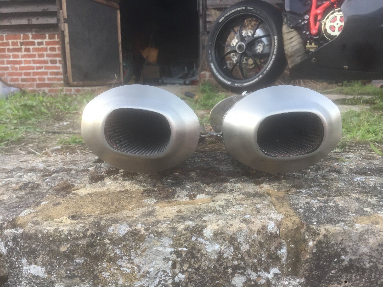

    custom welded 1198 exhaust cevlar wrapped
    996r mono subframe
    if ive forgotten anything i will add to the list later

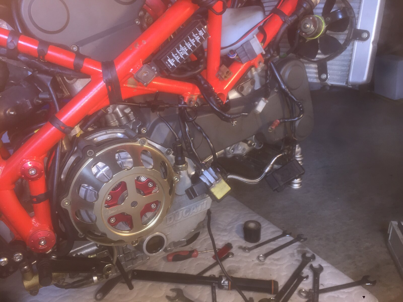

  5. the problem i have right now is i suspect the ecu is faulty!
    im running 1.6m ecu and need another so i can rule that out!
    i dont suppose one of you lovley people has a spare kicking about?

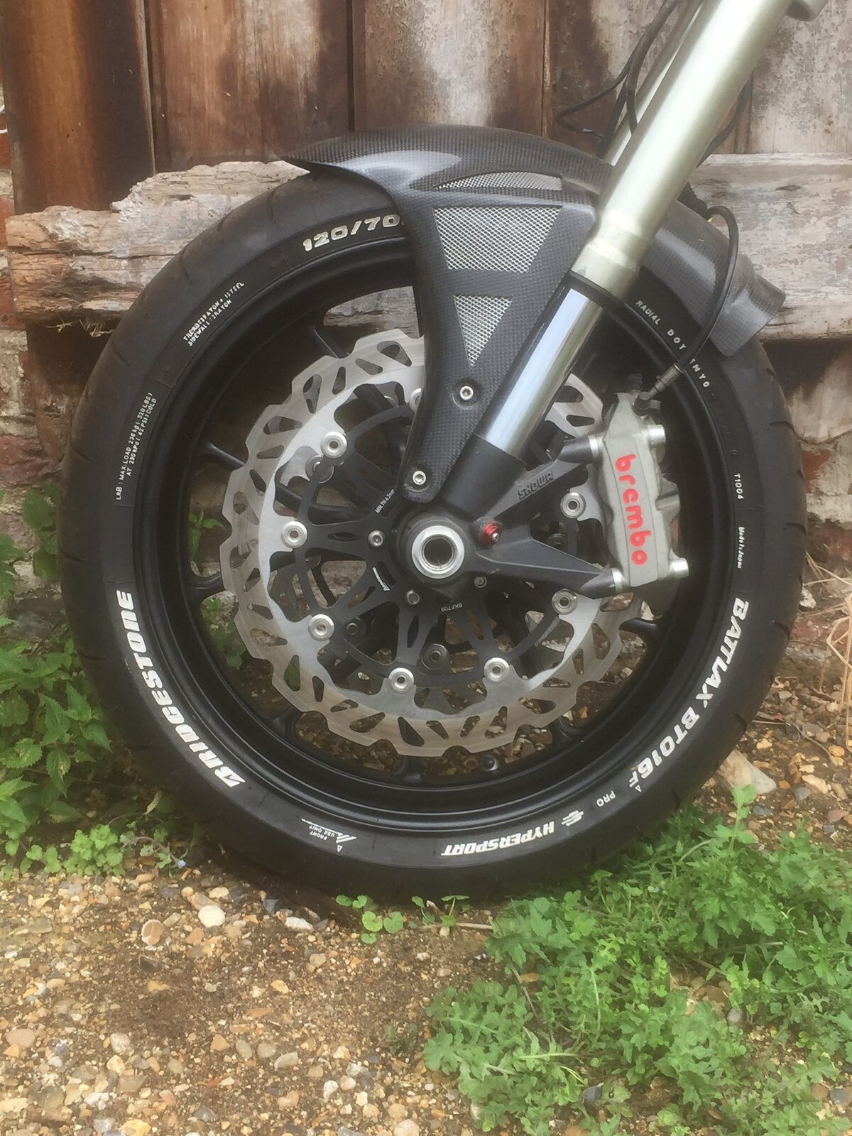

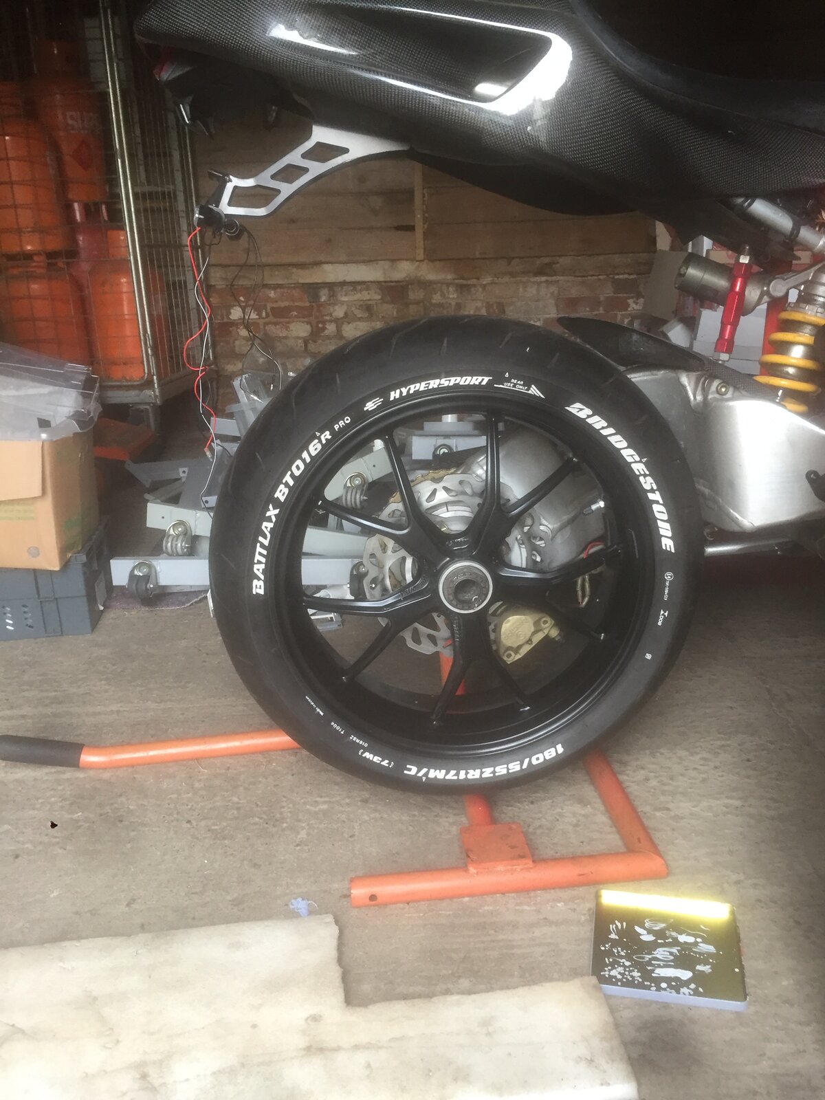

  7. It was all going well up to the tyre letter paint....
  8. He must have a lot of spare time to be doing tyre lettering, I admire his patience and attention to detail even the rotation arrow and smaller lettering.

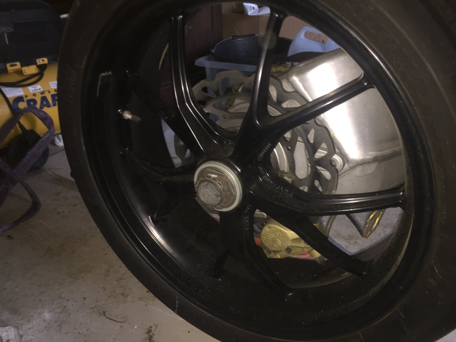

  9. And is that a 1198 swing arm wheel combination or 848 small hub?
    6 point wheel nut not 12??
  10. you running a 996 loom ecu and 1198 Throttle bodies? The TPS runs the opposite direction...
  11. its a 1.6 ecu + loom 996 twin injector throttle body
    i need an ecu because my friend broke the potentiometer next to the eprom chip!!
  12. You not running a 1198 motor then?
  13. well spotted!! im running a 848 rear wheel and hub at the moment, that was so i could have a 180 profile rear end!
    (better for conering)
    an honest mistake! (it has been in the shed for 5 years lol
  14. You need a 1098 rs rear swinger ttx and rs rocker....
    You could run a 200 60 rear tyre then... proper better for cornering
  15. not yet! way back when i started this build the main drive of the build was the suspention update and all the problems that brought with it!
    changing the swing arm was easy! but the rear shock then fouls the exhaust, and the pivot rocker no longer works. (the 1198/848 rocker makes the bike sit like a lowrider lol )
  16. haha.....just bored and waiting for parts to turn up......also an excuse to be in the mancave and away from my little boy who (due to lockdown) has in my opinion LOST THE PLOT! (hes 5.5) going on 15 lol

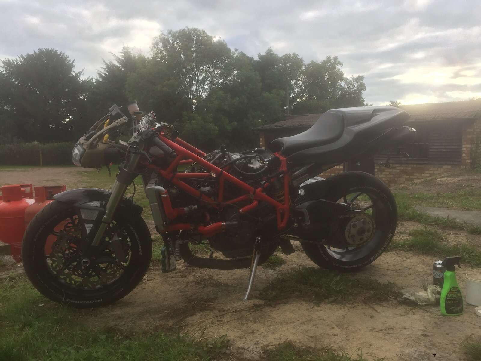

  17. anyway....back on point!

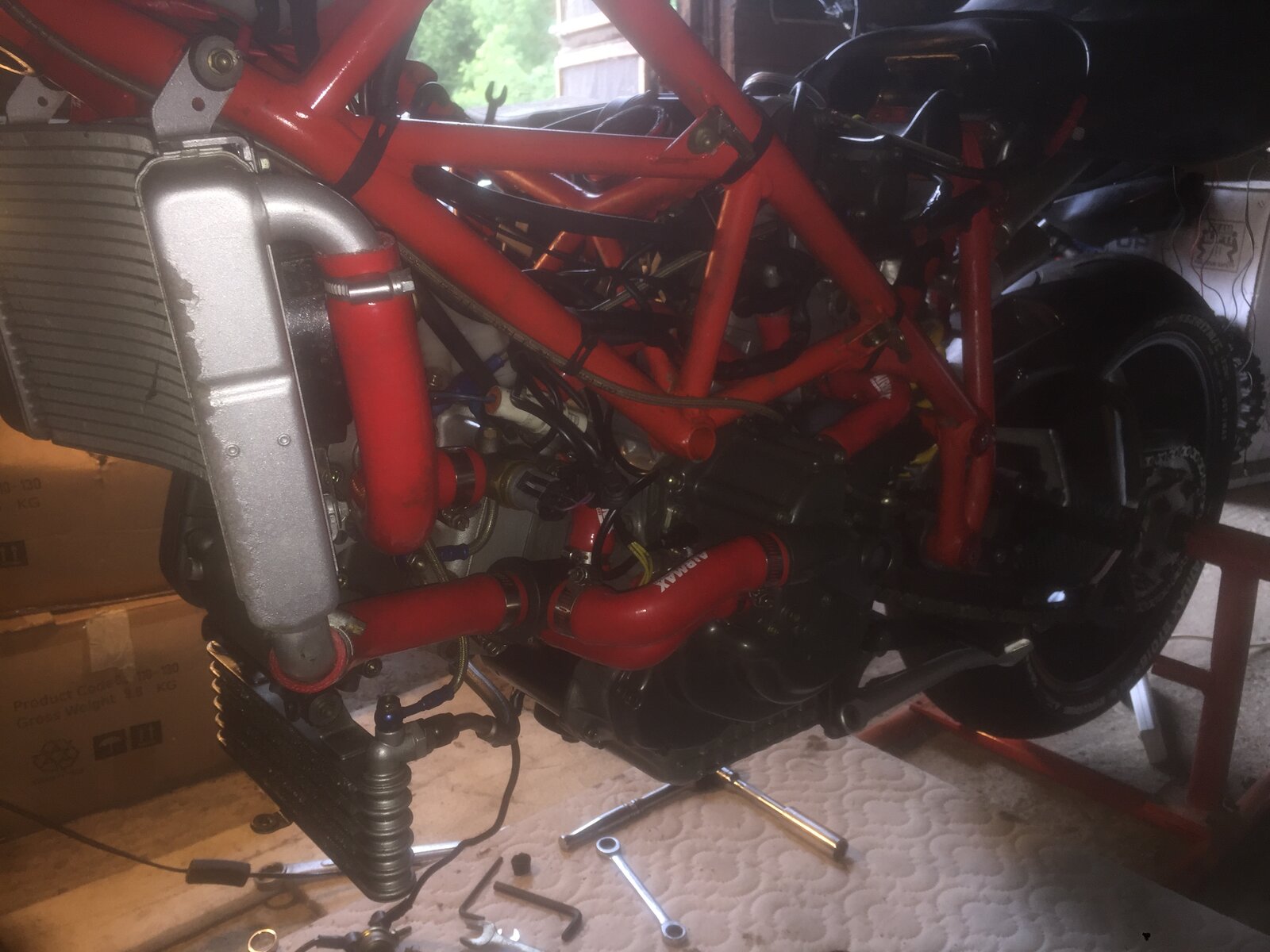

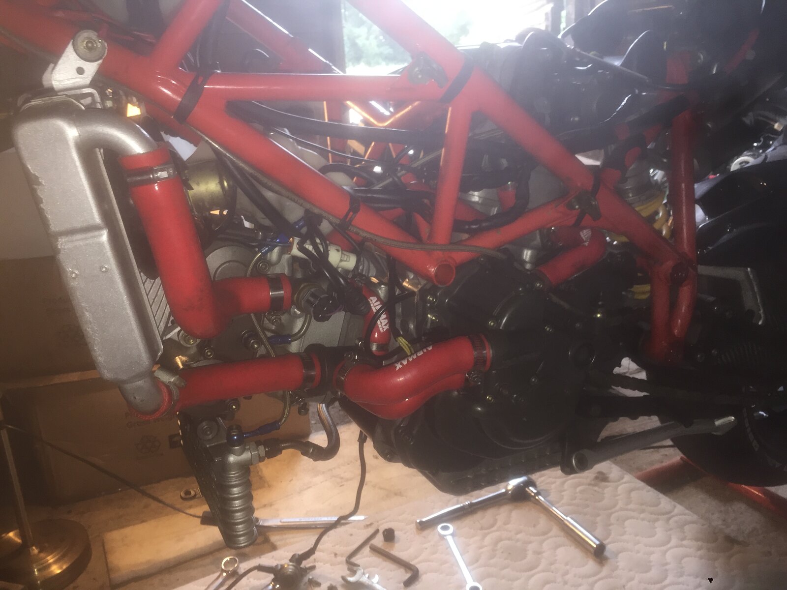

    the problem now is whilst trying to start she missfires in the front throttlebody.
    and i know (air leak) ive been over the fuel system with a fine toothcomb, replaced the inner tank hoses and fuel pump and filter, rebuilt the throttle body, checked the inlet manifolds, done the belts and re shimmed the valves and even replaced and reseated the valves and cleaned up the heads.....the ignition sensor was replaced and air gap set. new battery installed. so the ecu is all thats left to explain the problem im having.
