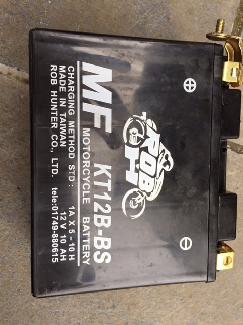

  1. hi guys , just pulled out battery from my 996 , here it is on the pix. it is 150x130x70
    trying to find replacement, but looks like nearest replacement is YB12B-4 , is it correct?
  2. Unsurprisingly it looks like your battery has been changed at some time, I think the originals are by Yuasa. Their web site states YT12B-BS
