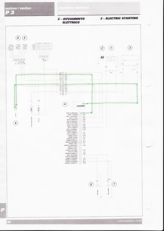

It's not as simple as that. The switch sends a negative signal to the ECU. I would eliminate it by using a known good/new switch. Looking at the wiring diagram the switch just closes a -ve loop so bridging the wires would complete the circuit but it's not a way I would advocate for testing whilst out on the road.
