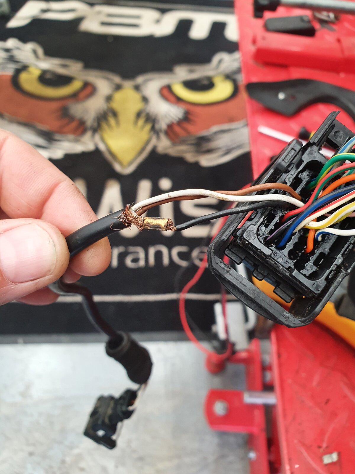

    looking at both injectors when its running is the only visual i can see that the fuel is coming out of both injectors equally, but trying to get it to run isnt easy when it is ,its firing fuel down the exhaust and sometimes back through the air intake, ill try get a video of it but i have found a connection i'm not happy with on the ground from the cps plug to the the ecu, not sure if its how it came from factory as it looks like its been crimped afterwards, ill get a pic to see what you guys think, it does show the sheathing to ground on the wiring diagram but unsure if this is how they are.

  7. I know Italian wiring can get bad press but that isn’t “factory”.
    Looks like somebody may have slaved in an alarm or something in the past?
  8. hi Ricky,
    cheers, i didnt think it was factory but also wasn't sure, funny you mention an alarm as it did have one removed many years ago from what i have found in the service history what came with the bike.
    cheers
    Adam.
  9. Bejus who wired that Stevie Wonder not even a Friday midday Italian would be doing that.

  12. Unfortunately that is a factory connection of the ECU wire onto the shielding of the cabling to the sensor.
  13. Putting the suspect electrical connections to one side, it's possible that the spray pattern of the injectors could be the issue.
    I'd still replace the fuel filter unless you have a record of it being done. Not necessarily as problem solving but just because they get neglected and will help prevent issues in the future.
  14. Meaning every 749/999 has this type of connection?:astonished:
  15. If you strip the 999 loom down you come across some iffy looking bare linking wires towards the ECU connectors.
    • WTF WTF x 1

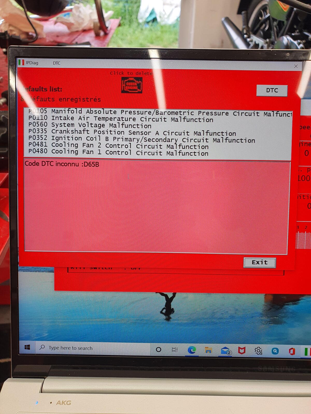

  16. A little bit if an update tonight, I thought I'd try the jpdiag and see if I could see any faults showing, after a bit of mauling around trying to get it to connect to the bike, I ended up speaking with @chrisw who sorted it out for me and I manged to get it to connect, thanks very much, I've got a few questions really regarding some of the pictures I took, are these faults, past faults or are they current? I don't believe this many things have failed unless it's an ecu problem? I deleted them and then tried to run the bike hoping it would show something but it didn't
    Cheers
    Adam.
  17. Clear the faults by pressing the engine symbol. See which come back.
  18. i did try this, but nothing came back on after several attempts of it trying to run and getting it to run but with back fires on the inlet and down the exhaust i thought id leave it for tonight.

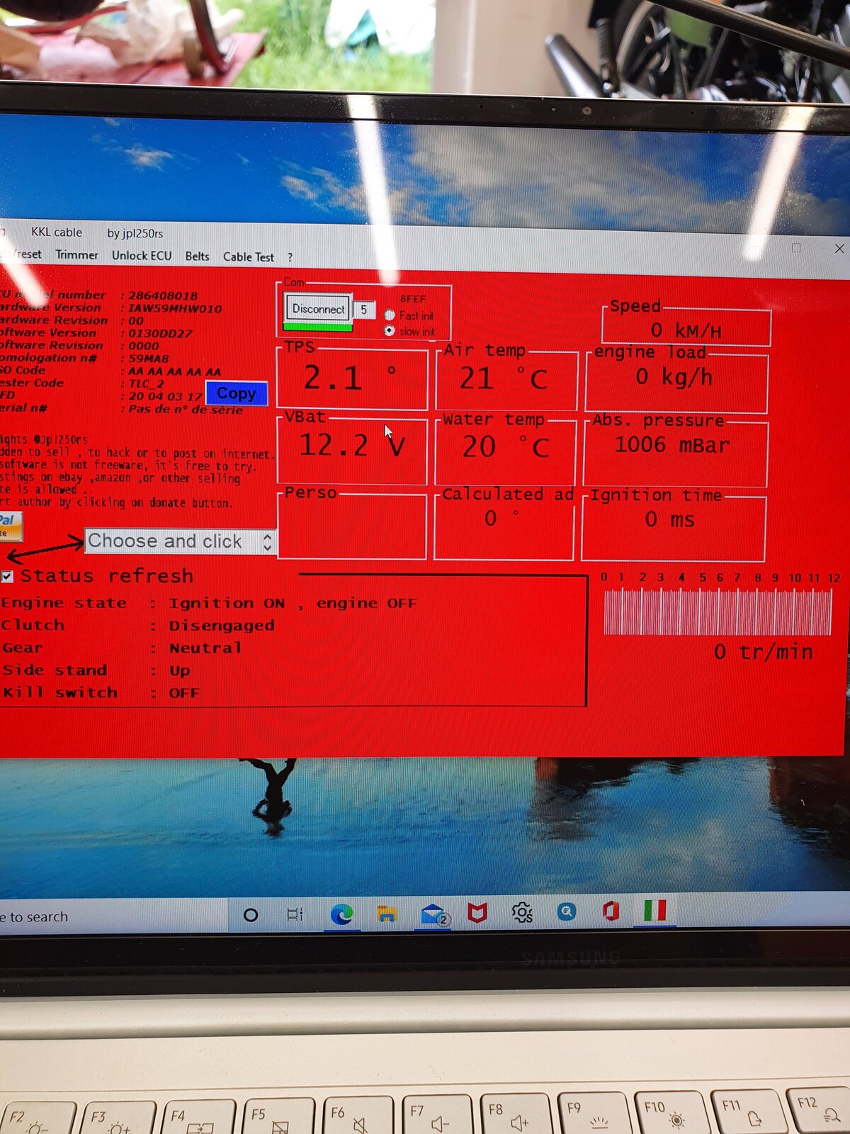

  19. This is the bike just with ignition on,
