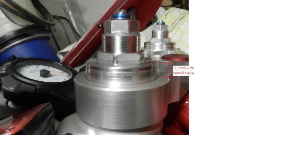

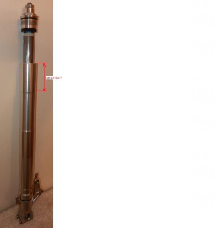

    My first question is: correct fork oil volume? I read my owners manual and found 0,511ml,but in other electronic manual I found 0,480ml. What is correct??? I tried to find more details and found,that volume is not so important, but the most imortant is oil leve(height from the top of fork). OK, but how is oil level??? and how to measure it (please see picture 1).Could I measure this oil level in this position or is necessary to remove inside parts and etc.. (I think,that I could to measure as it is on picture).And my next question is how is stock alignment fork/triple clamp ???? (see picture 2). Now I have fork 11,5mm(measured included special screw) above triple clamp and I was quite satisfied with steering ,but I think,feeling of stability is not so good as I expect.

  2. A well recomended 999 set up for forks is 4 lines showing above the yoke but this will make the bike steer a bit quicker and less stable to how you have it now. Also rear ride height 285mm between centres of tie rod. Can't help you with fork oil level. Sag is measured with your kit on. Interested in fork oil level myself as I have this to do.
    ps. 4 lines showing is the maximum you should raise the fork legs in the yokes.
