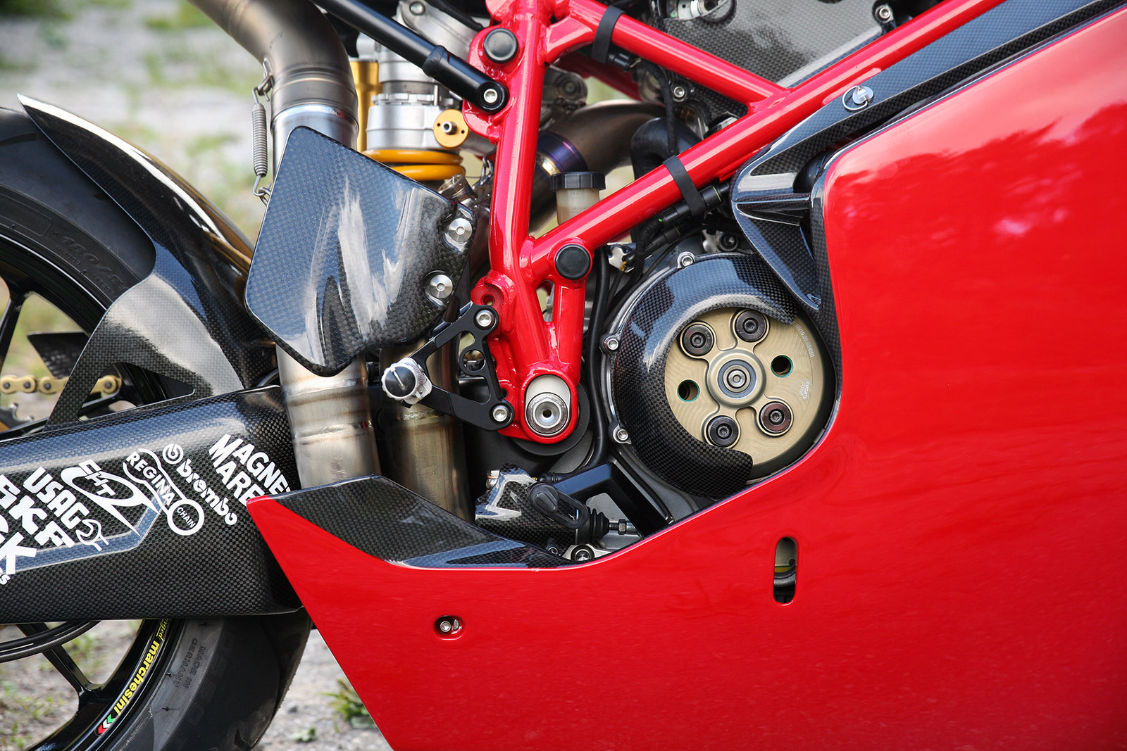

  2. Corse/F05 four post slipper with Surflex alu plates treated with lithium grease = perfect. Smooth engagement, neutral easy to find even with oversized slave and it's quieter than my previous 48t clutches (with steel plates).

    As stated by @JoeC they are available from Forza - I bought mine from Kevin as well. Recommended. Plates were bought separately from Bursi Evolution, but the stack height needed correcting with one or two 1.5mm steels from Ducabike.
    The lithium grease trick should be known by anyone with a dry clutch Duc and there are a lot of threads discussing it, including this one: http://www.ducati.ms/forums/56-superbikes/123775-grabby-shreiking-clutch-how-i-cured.html
    EDIT: The version of the F0 clutch I have uses ramps instead of ball bearings so it has a minimal amount of parts compared to an STM Evoluzione which looks like it was designed by a drunken dimwit (you need to open the 190Nm center nut to remove plates, because why the fuck not?). You "need" special grease to take care of the ramps. I use Molykote M77.
