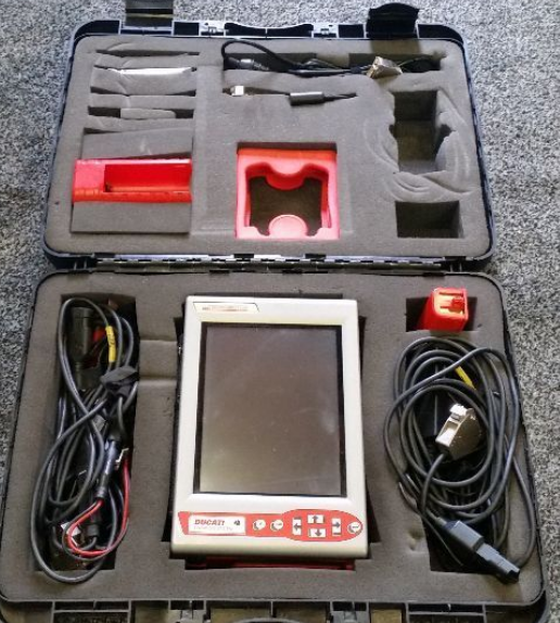

  3. Hi, Thanks for the reply,
    So its authenticated daily on a network right and unless I have an account I will not be able to use it like the one in the picture?
    The one in the picture i will not be able to use without authentication right ?
  4. That's not DDS 2.0, it's the original DDS issued after the Mathius tester was discontinued. Hasn't been supported for many years now. IIRC, 1098 era is the cut off point. It used data cards that were issued with each new model introduction. If it has the cards, then you can use it for the relevant models but you can't update any longer.
  5. basically the pooter say's nooo. Hope you didn't spend to much buying it:bucktooth:
