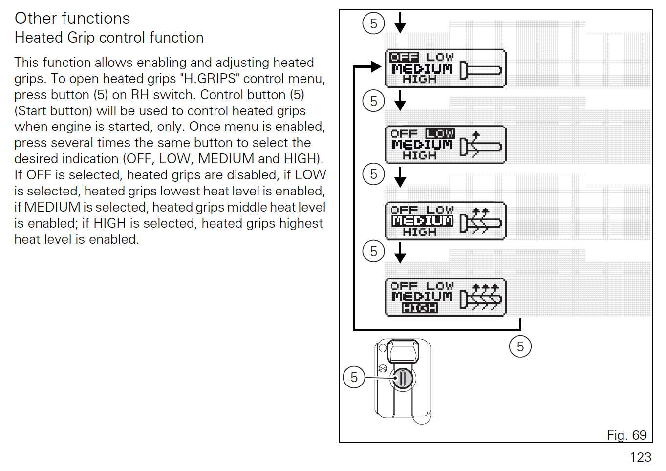

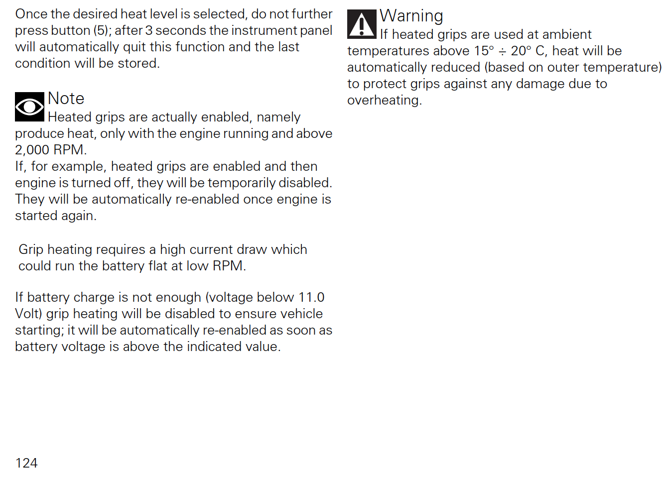

Thanks Derek. I know I'll buy them for the reasons you say (neat wiring and integration with the dash). I just wanted to check that they were any good. I'm surprised that they have to be enabled by a dealer. I read this portion of the owners manual last night, and it just mentions the heat setting on the dash, nothing about enabling them. I'll check later.
You don't see heat settings on the dash until it has been enabled - unless your bike has had it done already.

Yep Derek, you are correct. I started the bike, and pressed the starter button to go through the heated grip settings.........nothing. I guess I'll have to have this activated when I buy them. As I'm likely to buy them from my dealer, the cost of activating the option should be negligible or gratis. I buy quite a bit from him.
