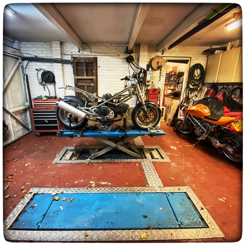

  1. Thought I would start a new thread... It's been a very strange year... I normally build something over winter, but this year I have been busy on my last build all spring and summer, and that is finished and at the back of the garage ready for spring.
    So I have started a rebuild on a 1998 Monster 900, a bike I have always wanted to own. I like the looks, and simplicity of them, and they handle great! this will be a straight restoration and I will be keeping it looking the same save for it being red and probably gold frame and wheels. I started the stripdown yeasterday...

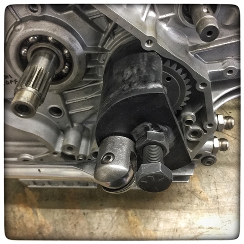

    To get the bearings out I also heat the cases… I would like to use the oven as its a more even heat… but I can’t for two reasons.. the first is the cases are too big… and secondly she gets upset, particularly as its a new oven! So over the halogen heater it is… keeping an eye on the temperature… I also like to mark EVERYTHING, so it can go back where it came from, and in the same position. I am not keen on centre pops, instead I use a little diamond burr in the dremel… this will even mark bearings and means you can number stuff as well, and it does not cause stress raisers…
    Of course parting the cases means the primary gear has to come off… and they are VERY tight… you can forget anything but a really robust puller. here is one I mad a few years ago. with this it came off easily.
