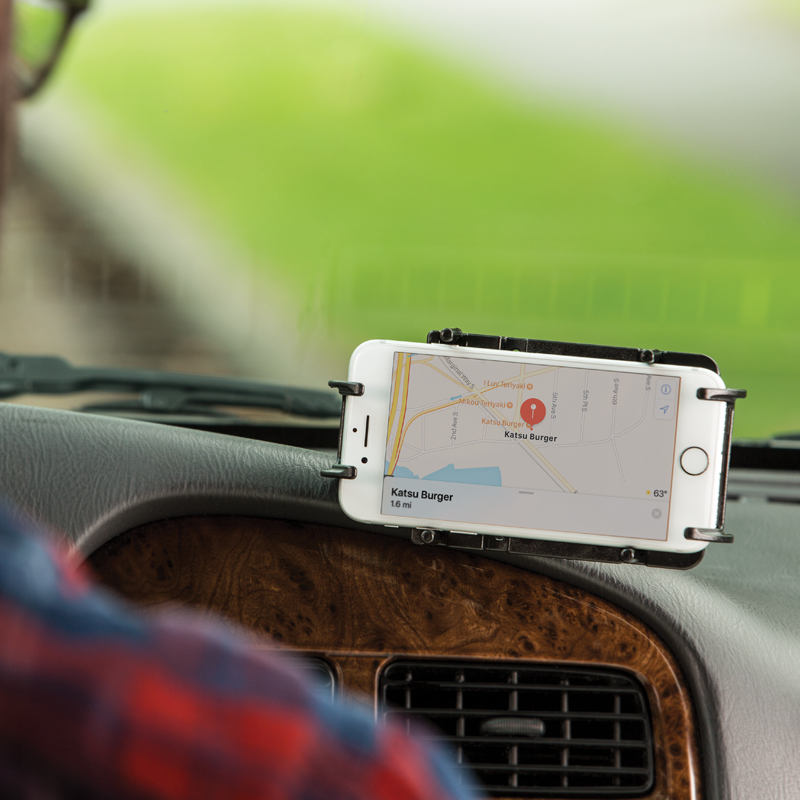

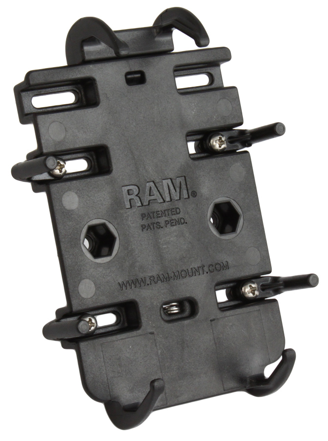

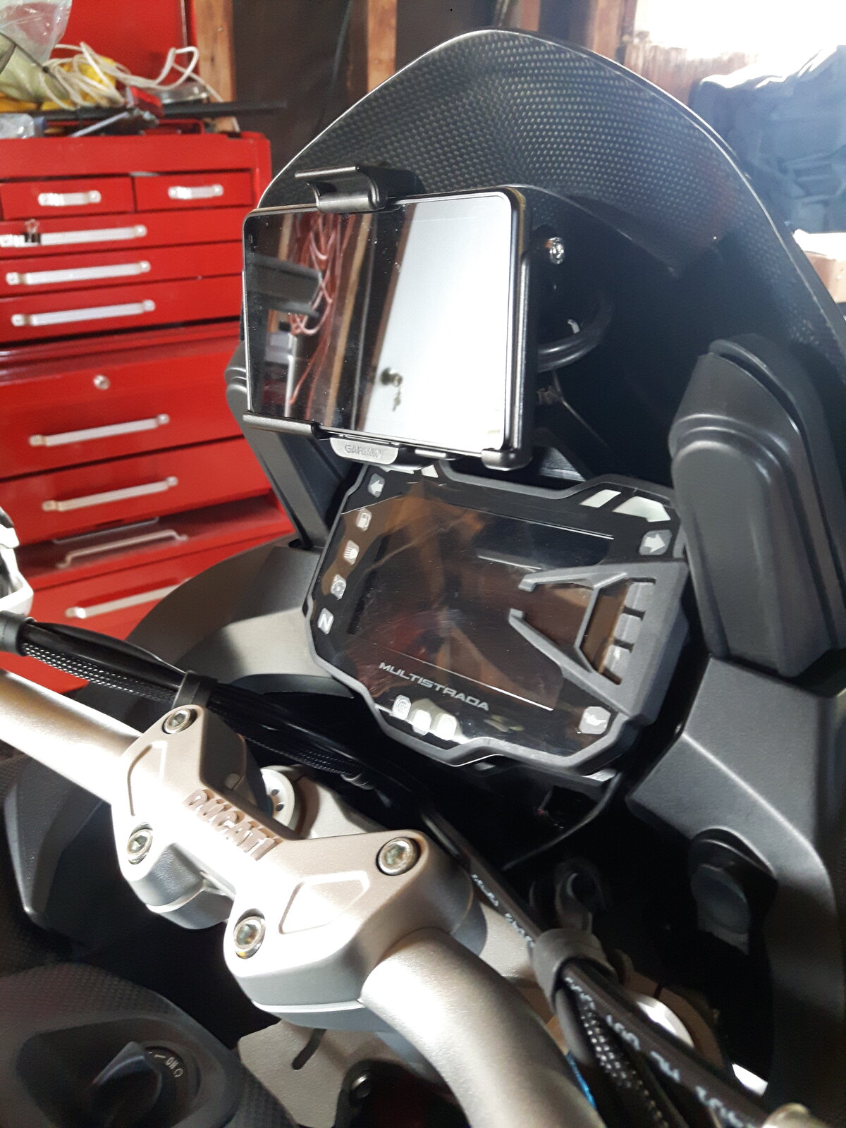

  13. Let's face it, the days of "stand alone" GPS are nearing the end of their useful life.
    I'm only using them because I have them. So many if fact, I may as well call it a collection.
    Two- 3590LMT (cars)
    Two- 3490LMT (bikes)
    Two- GPSMAP 76CSx marine handheld with bluecharts (Seadoos)
    Two- 2597LMT (originally for the kids cars which they don't even use)
    One- built-in Garmin in our Jeep Wrangler
    With the exception of the handhelds, all of these are now expendable.
    Consequently, I would not go out and buy one today.
    If it wasn't for those, my Smart Phone would already be cradled in the Navihalter bracket in lieu of:
