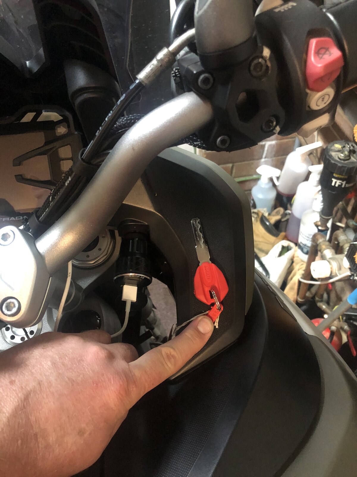

  1. C79600B5-37FD-4556-854A-AF7023507AFD.jpeg Hi all I have a 2017 Multistrada Enduro.
    The bike went in for a service and a key fob warranty exchange back in July/August they delivered the bike back to me and the on off button pictured would not turn on the bike, I used the recovery unlock system button and the bike turned on perfectly, again the on off button pictured would not turn the bike off. Today it went back to Ducati and they said it would be a faulty switch, switch exchanged and the problem still exists, they reprogrammed a new key again and still no good, they checked the canbus and no errors? They have sent me home saying they need to send the sheets to Ducati to ask what to try next. The bike has ran faultless for years so it’s not making sense. It’s not the battery as we have tried a new battery and a new fob, no errors so what else could I try?

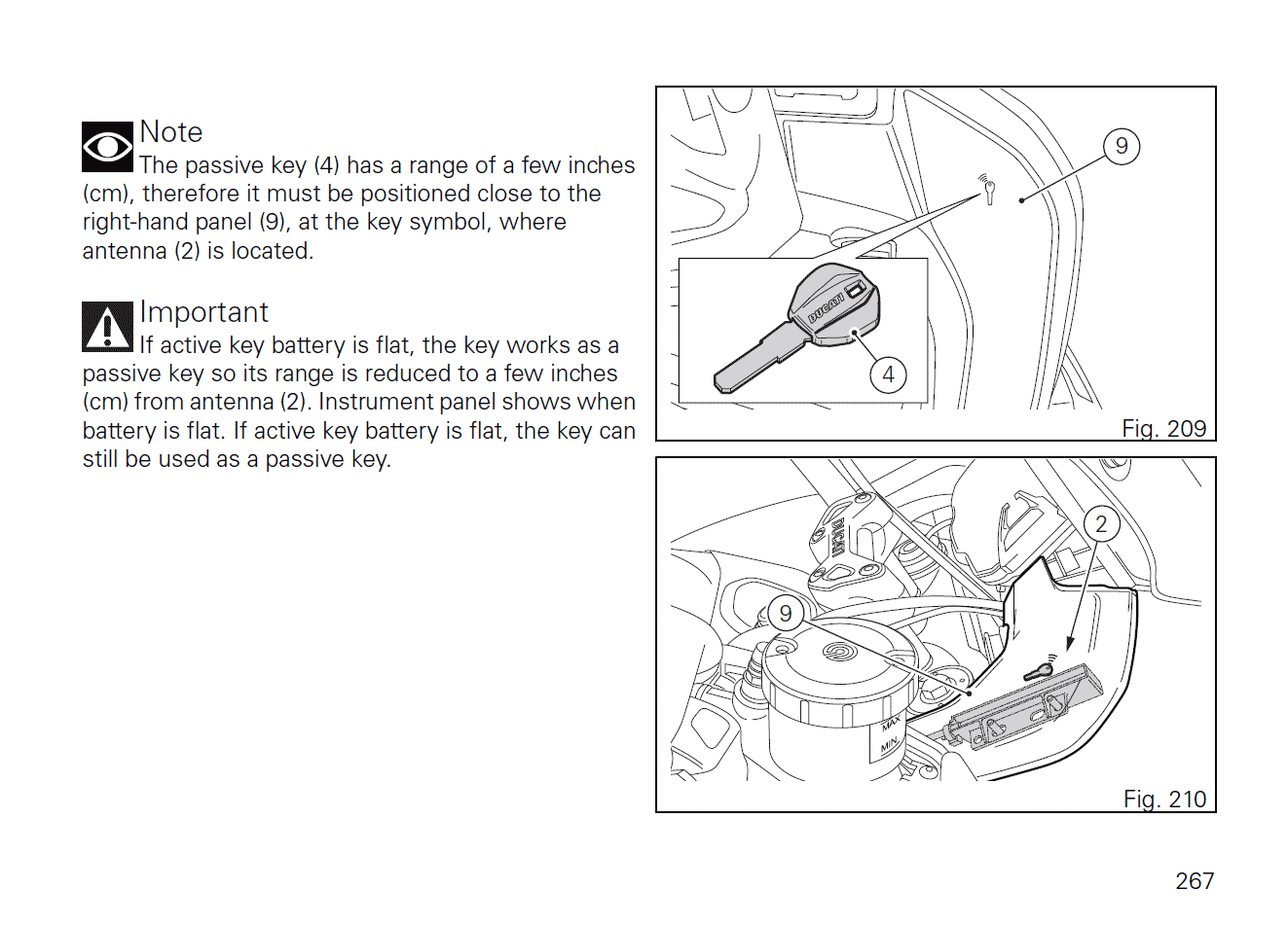

  9. I'm lead to believe that the spare non fob key still has a chip in it, the passive variety. You need to, as Nelly says, place it on/v. close to the antenna. There is a symbol moulded into the right-hand black panel under the bars. If that works then it's probably an issue with the fob key still.

  11. Placed the red key on the panel. Where I believe the reader is and still nothing in fact when pressing the recovery unlock its asking for the pin leading me to believe there is no chip in the master key.

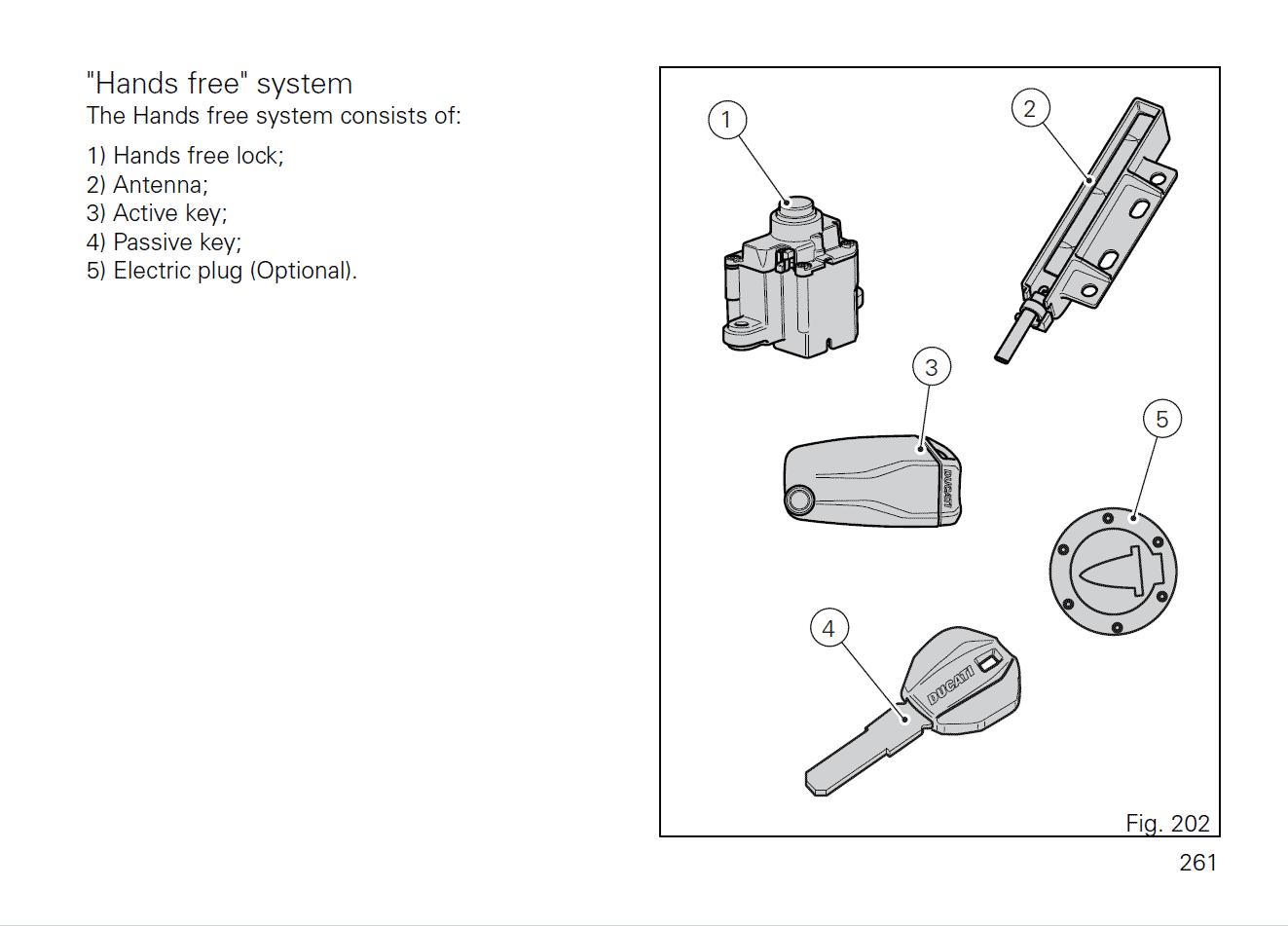

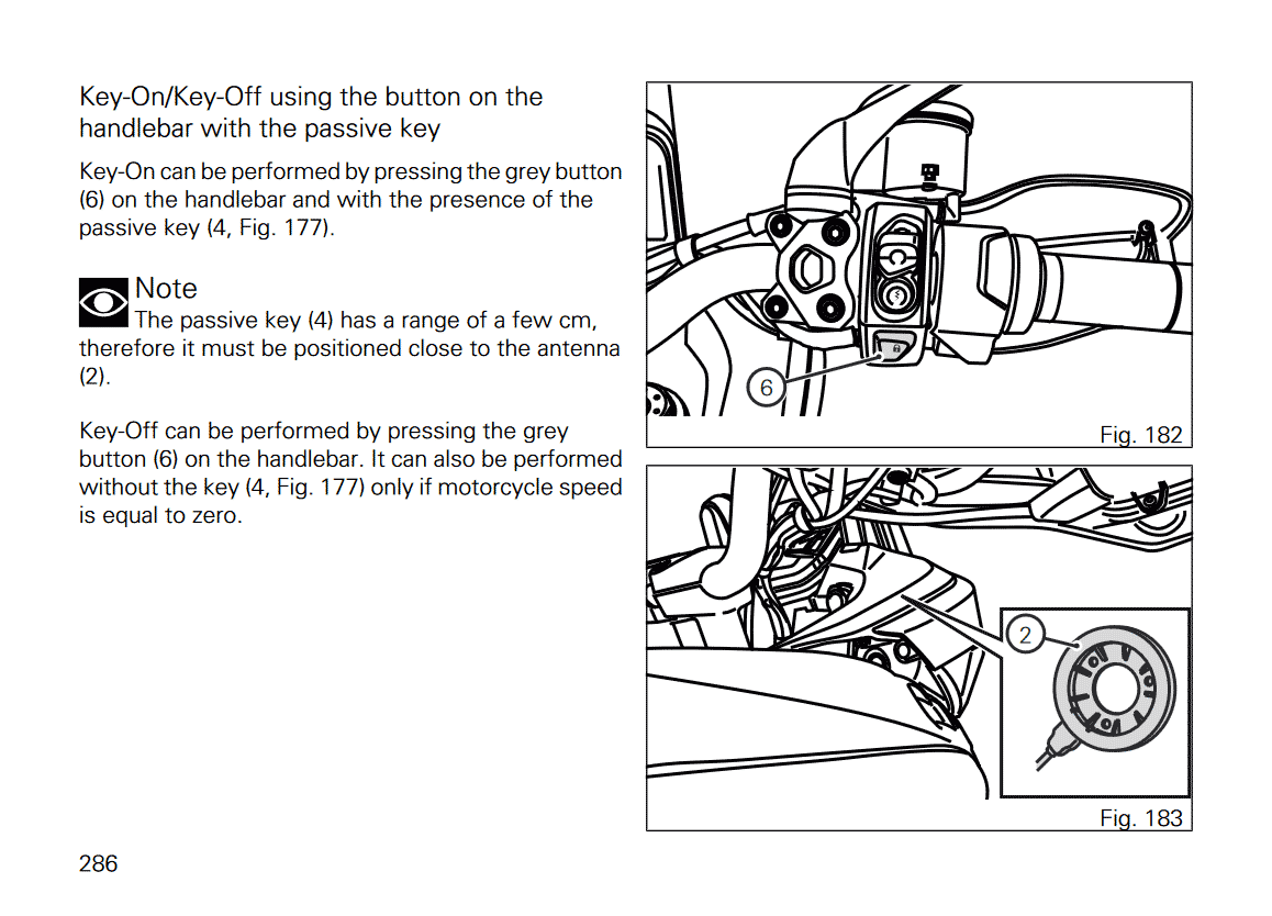

  14. From the owners handbook:
    Will need to access my bike to verify this, not possible until later, possibly tomorrow. Maybe someone else can confirm?
    This, quite possibly, confirms that it's a duff antenna or wiring to the same.

  16. I cannot see any key symbol on the panel. I can feel the cable under the panel

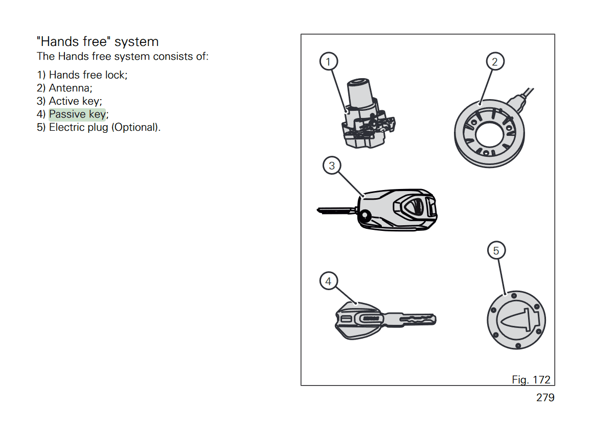

  17. That's interesting, maybe the antenna is located somewhere else on the Enduro... no, just looked at the 2017 1200 Enduro handbook, looks different but located under the same panel by the looks of it. No mention of a symbol though, unlike the 1260 Enduro which does.
    Still mentions the passive key and has a similar drawing of the components as in my previous post.

  18. I tried the passive key again in many places along that panel and every time the handlebar button would not work and the recovery button would not pick up the transponder as it would only ask for the pin no… Ducati are coming for the bike on Tuesday and said they will keep it until it’s resolved but I’m slightly worried at what cost….
