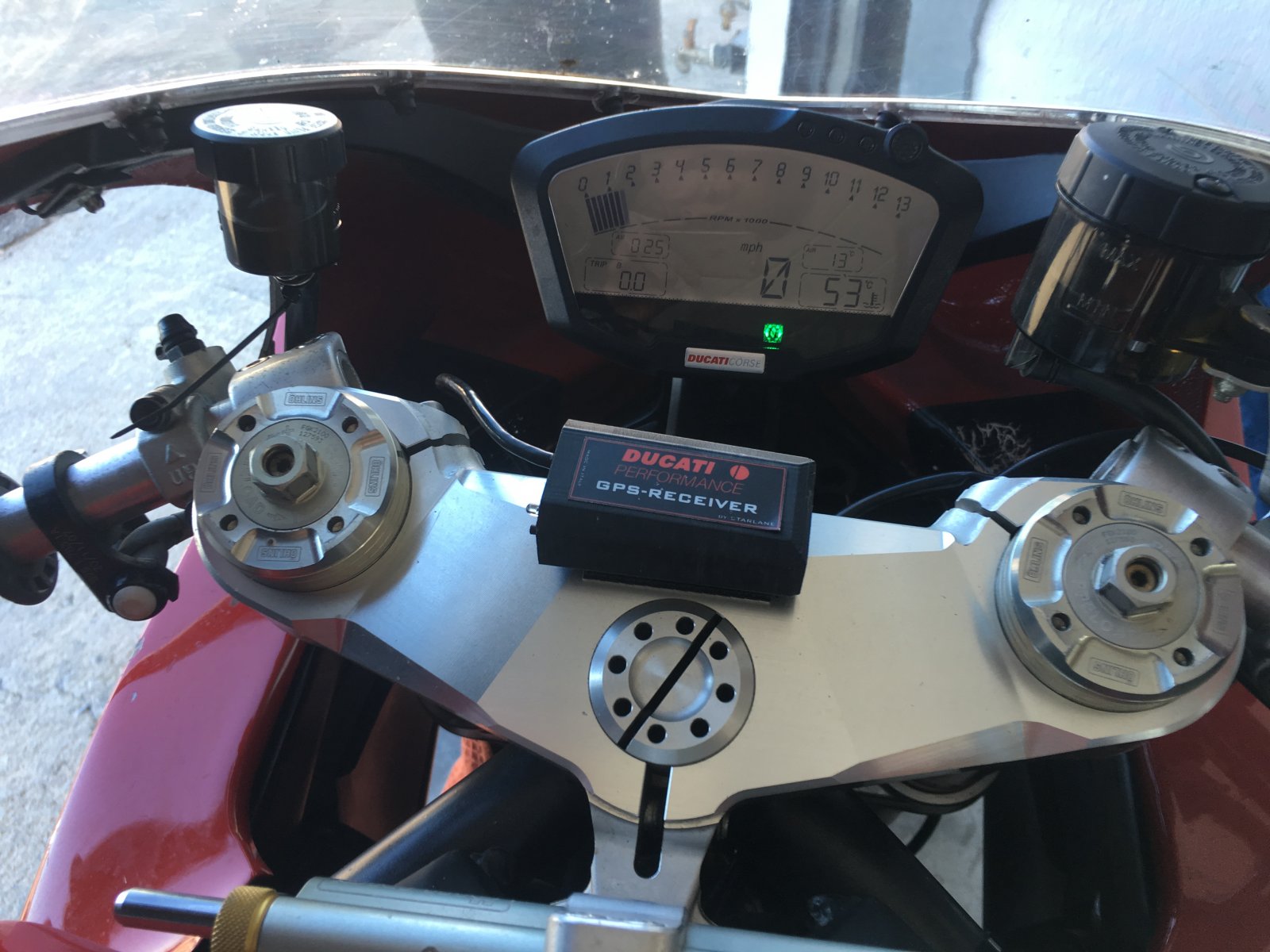

  1. this is on my mates 848 evo ex tri options race bike. Does anyone know how it works, does the bike have an inbuilt Laptimer ? I've tried holding the different buttons but don't get a lap timer on screen??

  3. How did you get on with your GPS? Does it work? I have one on my ex Trioptions 848 with two mode buttons on the left side bar. I am setting up for use next year.
  4. I dont think he ever got it working unfortunately and he sold the bike recently.
  5. @Paul55 I *think* it connects to the DDA, so its not the bike as such but the DDA thats the lap timer. Otherwise, you have to flash the headlight to register a lap.
    Also I didn't think try options were allowed a mode switch so must be an additional
