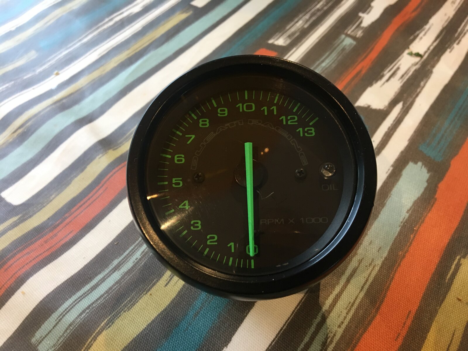

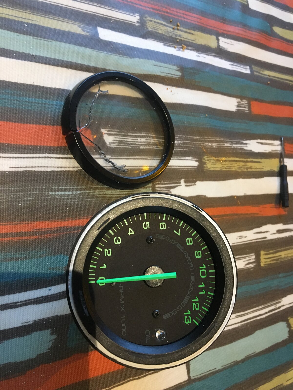

  1. F:skull::poop:k, sh:dizzy:t, b:sob:ll:scream:ks!! :skull:
    Yes I somehow have a large crack in the rev counter glass - which weirdly includes the black outer frame, the crack spread to it too!!
    Yes I was working on the front brake reservoir. No I didn't notice anything drop or hit it!
    Can the glass be extracted and replaced - does it need to be done by a professional?
    Very depressed! Please advise! Very pi55ed off tw4t!

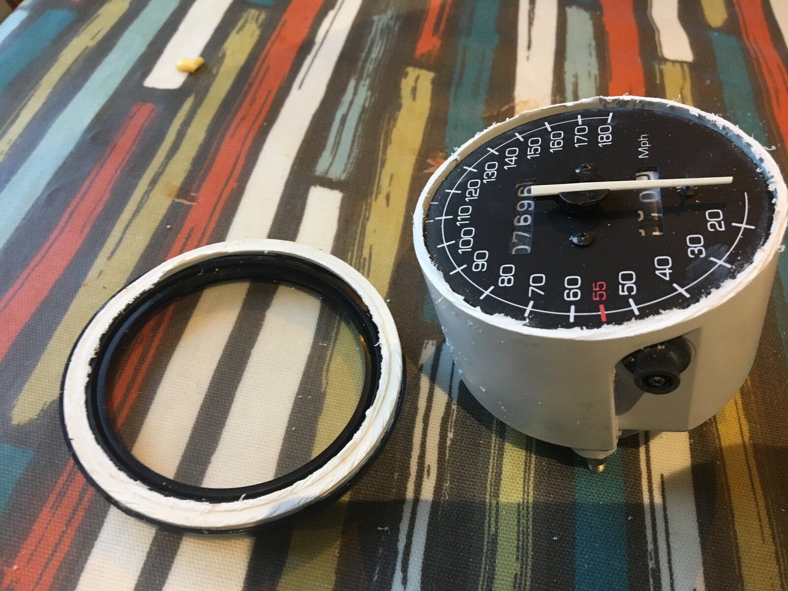

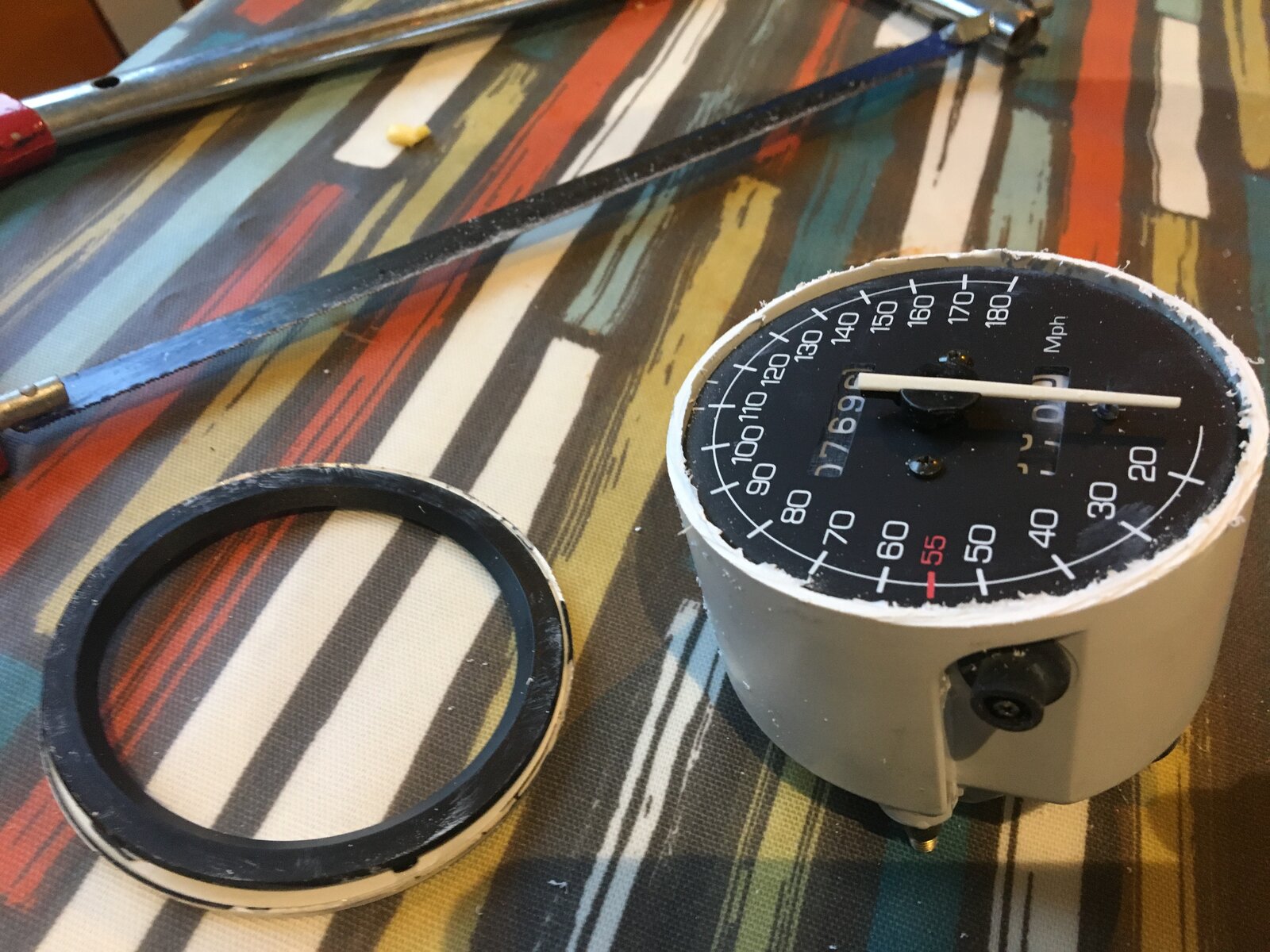

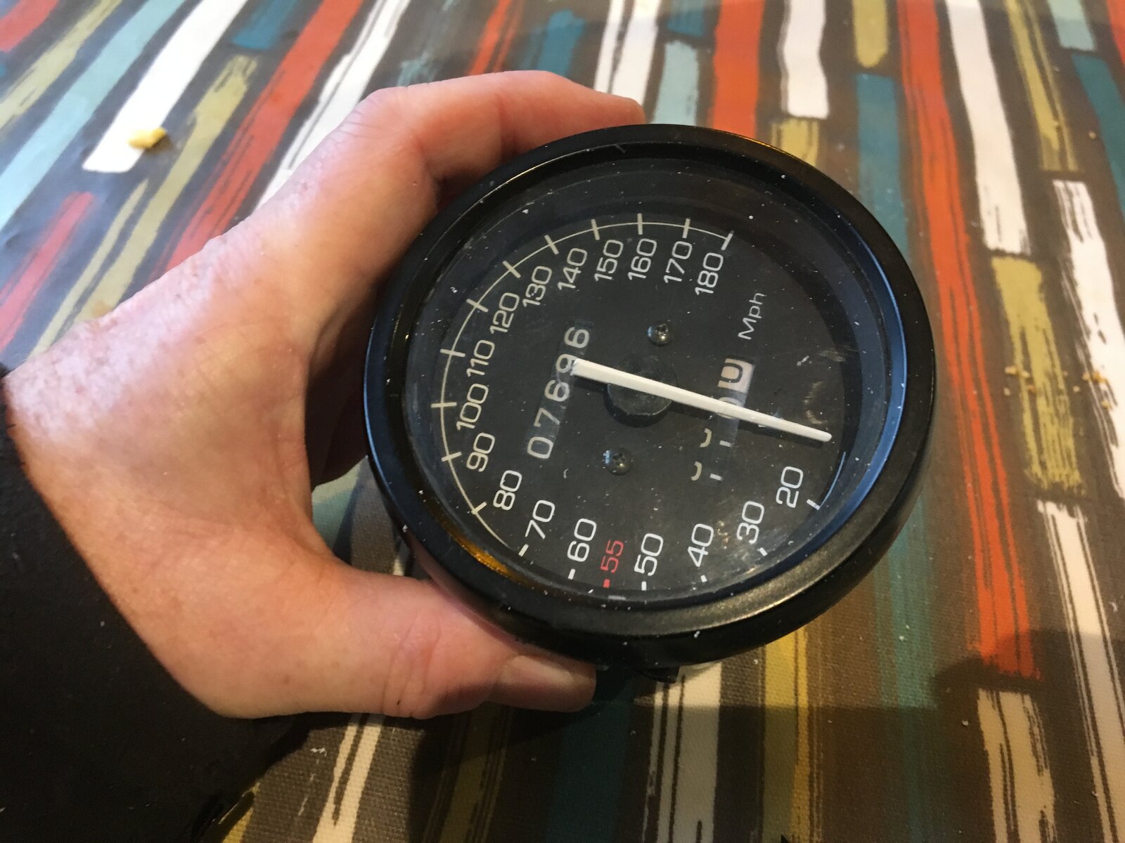

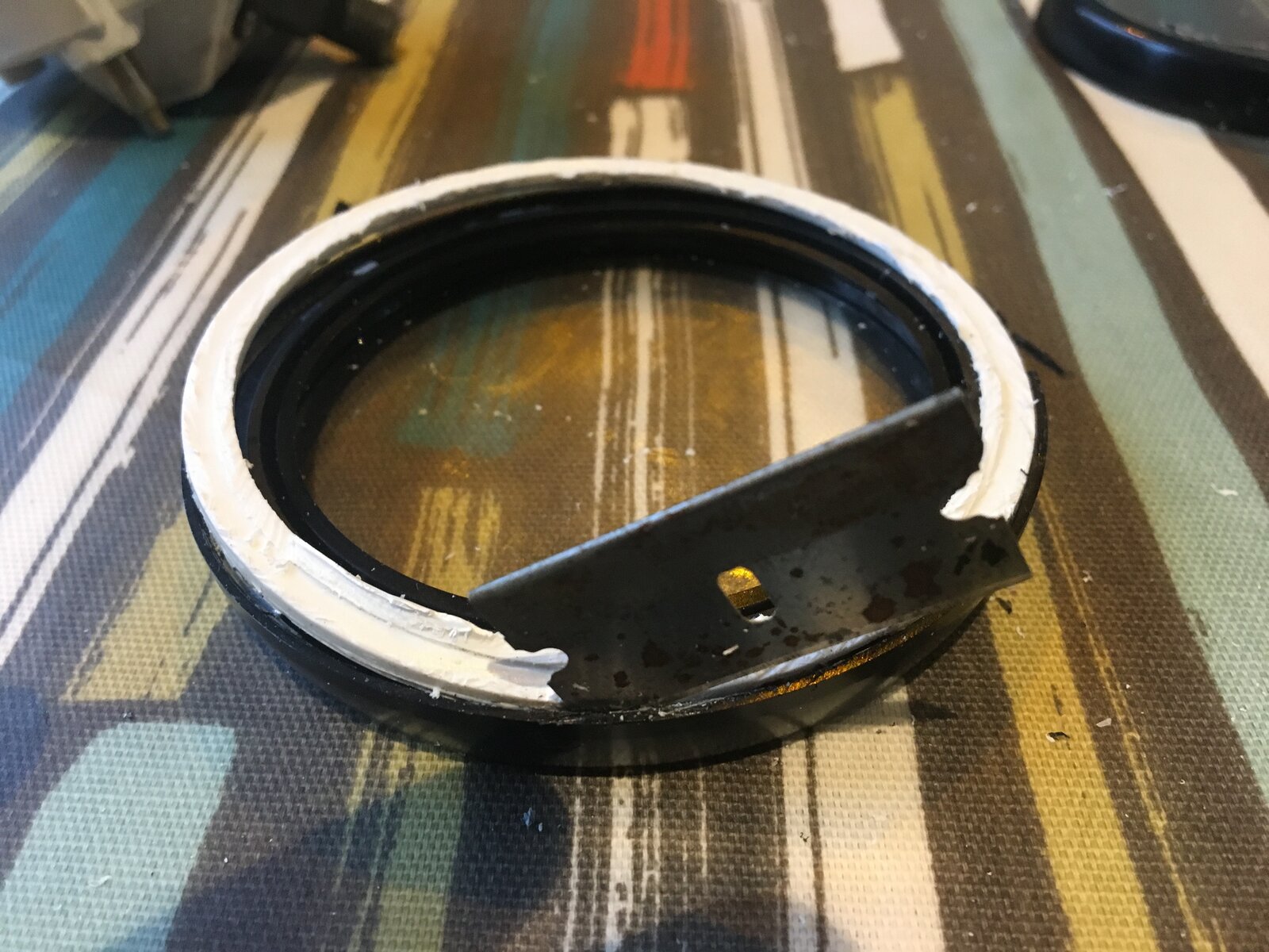

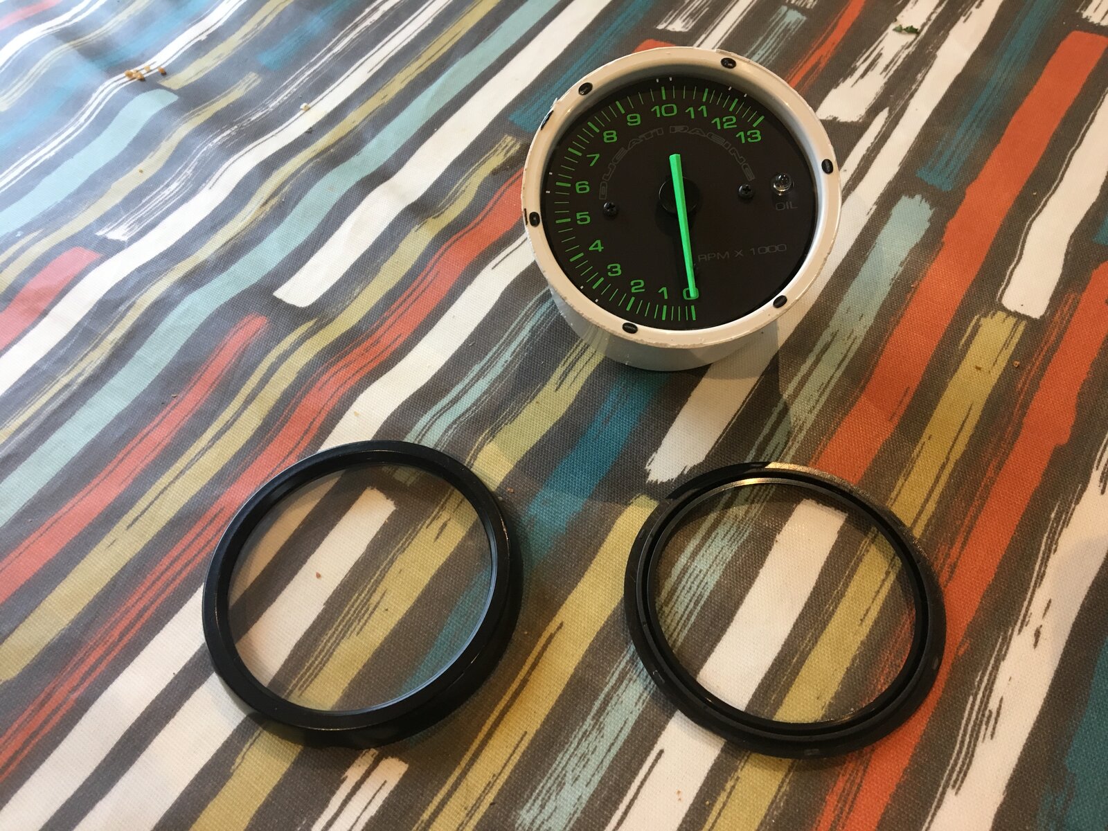

  9. IMG_0167.JPG IMG_0158.JPG IMG_0160.JPG IMG_0161.JPG IMG_0162.JPG IMG_0163.JPG IMG_0164.JPG IMG_0168.JPG IMG_0169.JPG Hi Guys! Thought I would give you an update on my cracked Rev counter! I had in my possession an old mph speedo I had bought years ago due to MOT centre failing my KPH one! But then changed their minds a few years later and failed the MPH one as it didn't have kph as well! Anyway, I digress!

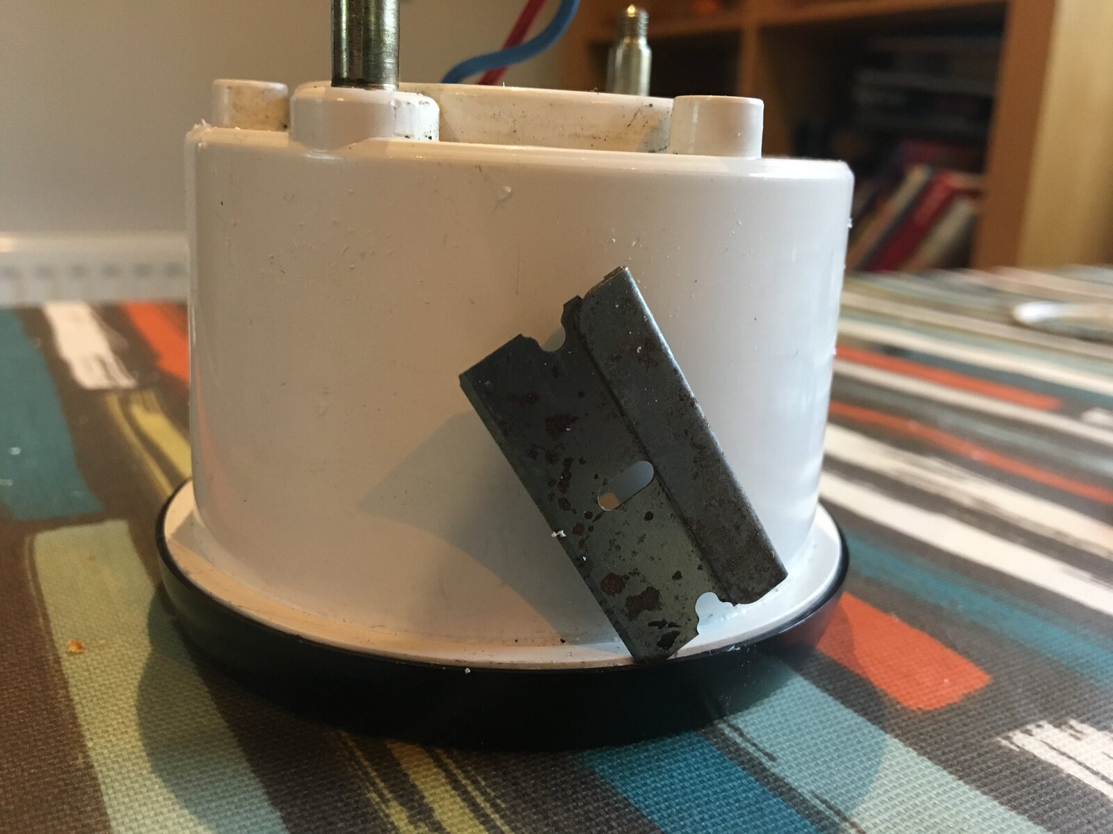

    SO I had a go at gently prizing off the cracked glass on the tacho and by carefully inserting a blade (like a scalpel or craft blade) between the white rim and the bezel edge (from the back) it eventually came away. It took a lot of patience, by gently (with some pressure) going round and round the lip at back, between the black outer and white inner - these are glued intermittently. So the idea was to work my way thru the glue. AS it was already cracked, I wasn't worried about more damage but at same time needed to see how tidy I could get it off. It took a while and patience was def the key, but it came off.

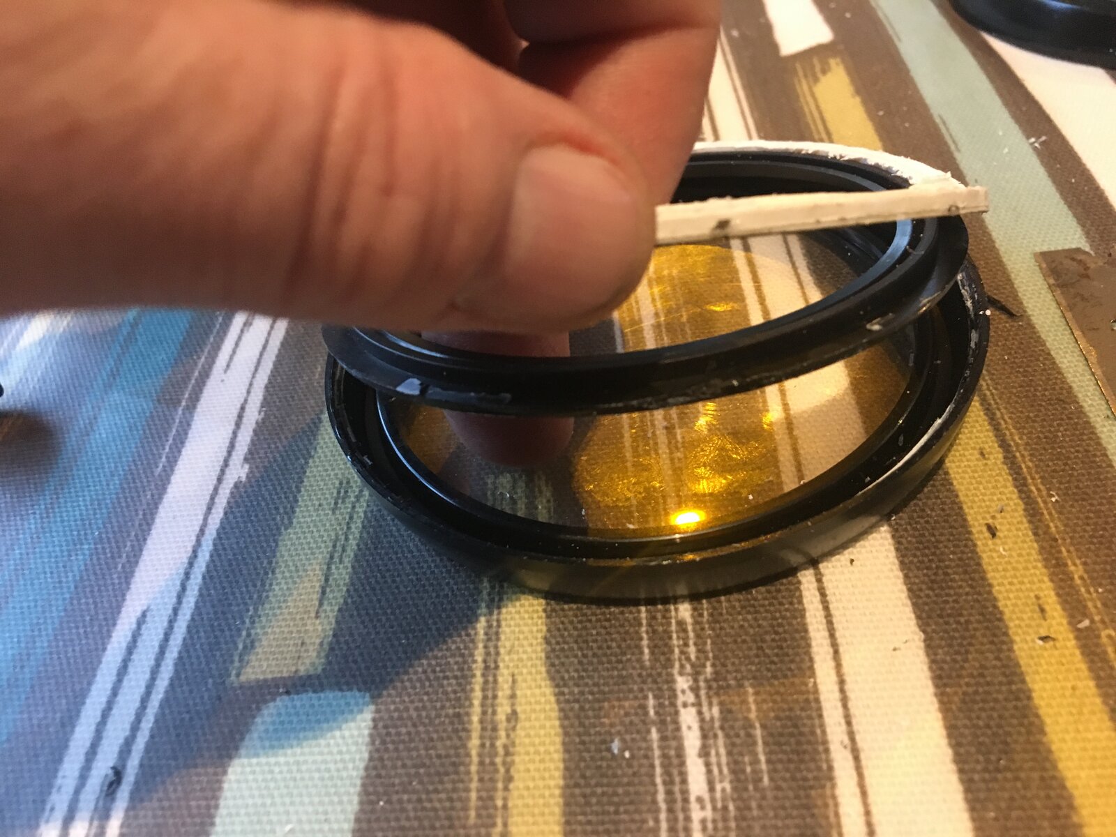

    Next was the speedo. I started by doing the same way - but it appeared have more glue so as someone else had suggested I cut the glass off at the white flange with a hacksaw! I then returned to the previous method, inserting the blade tip between the white flange and black outer bezel, going round and round gently with pressure. Eventually, (20mins) it started to free up, and then it came away, nice and cleanly.
    I now have a nice (decent) glass to refit to my original P8 tacho (and a scrap speedo!)
    Have to say I'm well pleased with the result. I had been in touch with a rev counter restorer who wanted £250 to replace the glass and 'make' new bezels. This was more the result I hoped for!
    So anyone out there with a cracked P8 tacho - they are repairable!
