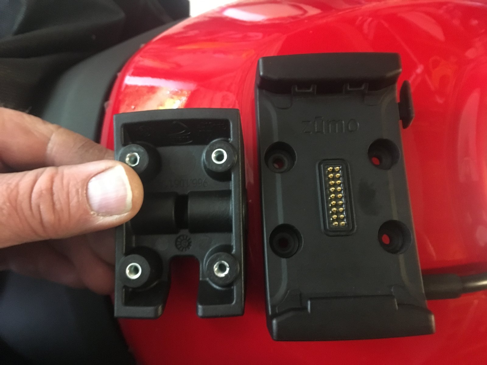

    Looking for some help as i received the new ducati (navihalter copy) mount today......however my garmin 590lm cradle doesn't match the holes on the mount, the instructions show a completely different garmin mount.....anyone else had this ?

  2. Show us a photo, sounds like someone needs to get the drill out.

  4. It appears to be designed for the 390. Garmin in their wisdom decided to for some reason to change the layout of the mount and the hole spacing.
  5. The original Navihalter has a flat plate with multi mounting options that will probably accommodate any satnav
  6. Right, david at Snells has found a solution, they're having an engineering firm make up some new mounts out of aluminium then anodised black.
