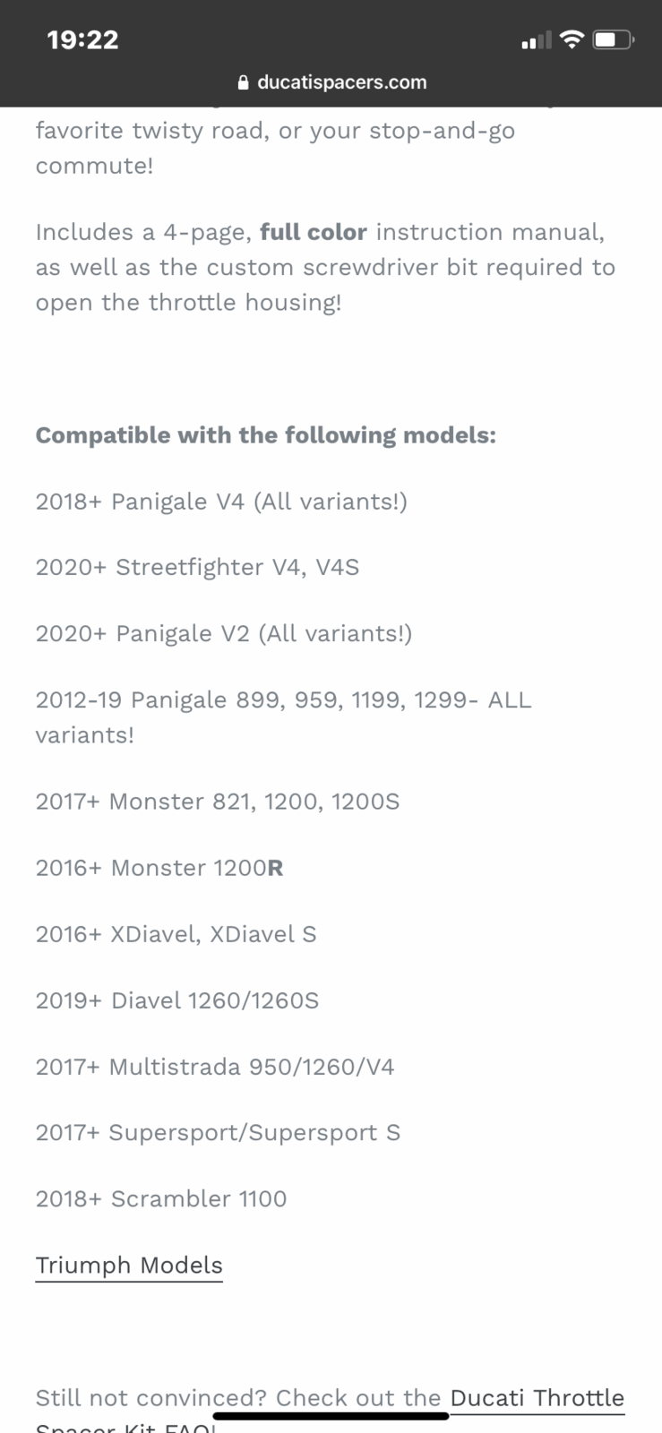

  1. Hi i recently bought some Ducati throttle spacers from eBay which I believed were genuine DucatiSpacers. After fitting on my SFV4S after the first test ride I noticed the auto blipper was not functioning correctly. I contacted DucatiSpacers who asked if I could return them for investigation to the USA which I did. It turns out I bought cheap copy items and the tolerances are different. Kevin from Ducati Spacers sent me three sets to try which I did. Low and behold his spacers work perfectly and the blipper works a treat. It’s always nice to acknowledge great service and Kevin is an absolute gent so thank you to him. This is a warning to anyone that is buying to throttle spacers on eBay to ensure they are the genuine DucatiSpacers items or you may have problems with the quickshifter/ blipper functioning correctly. I now have two spare sets of throttle spacers for anyone that wants a set then let me know. If you cover the postage I will send them out. I think they are the same spacers on the SFV4S as the Panigale V4.
  2. Would the spacers fit an 1199? If so, I would gladly buy a set off of you.
  3. yes I believe they will. See below
