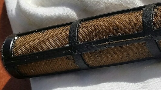

    oil filter mesh has metal particles.. see pic. 2015-08-11 11.07.18_resized.jpg

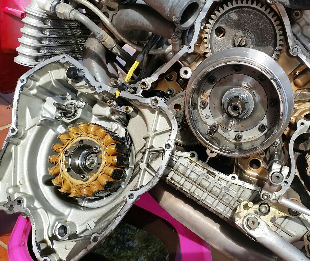

    removed alternator cover hoping to see something locking the engine. Nothing looking wrong here visually. nut is still tight. No movement on the fly wheel. no damage to cover or alternator. no water in drained oil or vice versa.
    plugs now out.. still wont turn over..

    engine made light rattling on the left hand side so I suspected wrongly the above area. where to look next? without engine out.?? uffff.

  12. Could be so many things as suggested, but going by symptoms it could be that one or both big ends have failed suddenly as if they have been wearing out gradually they don't usually seize a crank solid unless engine pushed really hard plus main bearings usually rumble/develop play rather than seize as they are conventional bearings not shells. Causes for a sudden oil pressure loss again could be due to several reasons but crank oil gallery plug unwinding (as said) is quite common and probably the most likely. Although often criticised for having greater than ideal clearance, oil pump failures are virtually unheard of and almost the same for pressure relief valve.

  14. If you can move the flywheel up and down then you may well have broken a main bearing. The bearings are in a plastic cage and if they break up and roll out I guess you could have one jam the crankshaft or get between the crank and the crankcase and jam it. They can make a bit of a mess when the balls are free to fall into the crank and crankcase area.
    Judging by the metal floating about in the oil it looks like something has broken (up). Certainly further investigation is needed and possibly it is time to remove the heads and barrels and look into the crankcase to see if you can see anything amiss or seized. Many possibilities have been covered but to add one more item a ring could have gone and done some damage, although unlikely.
  15. ^ op said no movement on flywheel
  16. I mentioned this to indicate what main bearing failure might feel like, if you have not experienced it before, and it's always worth a check. If the jamming is caused by something jamming the crank that is in between the crank and the crankcase there still is\may be the possibility of main bearing failure, which possibly could just be starting, or certainly worth a check. No doubt deeper inspection might prove what the problem is\might be.

    Spoke to one of my Ducati mecánic mates and showed him the filtered oil. Uggg. I thought I had a clue of things.
    He thinks a piston has locked up. How?
    Flickering red light to full red in seconds is sudden oil blockage. How?
    Well it might have been my fault when rebuilding the sprag . .. too much liquid gasket/silicon seal for the alternator cover.
    He found some in the oil. He thinks it blocked up an oil galley, slowly but surely. And overheated a piston/big end bearing....
    It happens fast he said when oil suddenly stops. No overheating. Just lock up. The shavings are not magnetic so has kinda diagnosed that.. broken timing belts won't give red flickering... they just break the engine he said.
