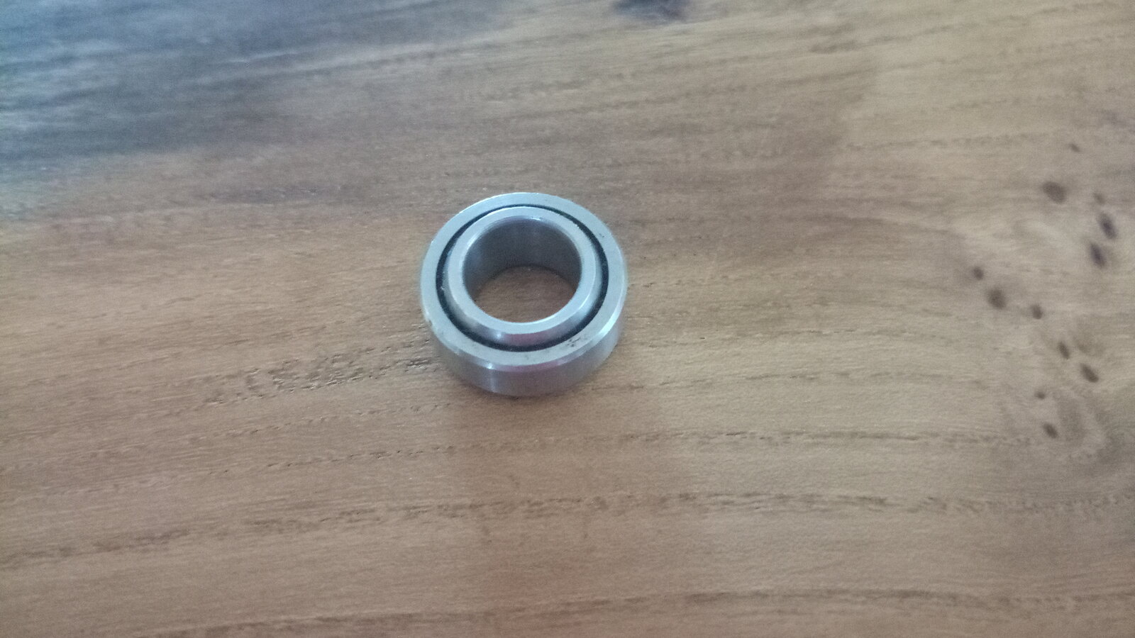

  4. It will just be a spherical bearing that may or may not be held in by a circlip or similar. Here is one I changed recently on a MV Agusta. It's a standard SKF bearing that had some top hat bushes pressed in and was held with circlips in the body/top eye.
    Ohlins for example don't bother with circlips. They are just pressed in. 1633421580698271397879026146820.jpg
    11 quid for a replacement from your friendly bearing place.

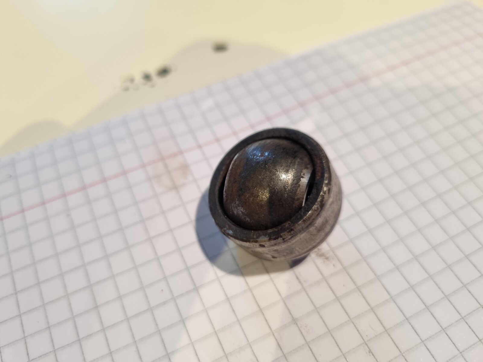

  8. Hey Petsmisth, just to thank you again for the useful and precise input. Thanks for your directions it was a breeze to take out the bearing.
    For future reference, the DVT shock has circlips with eyes, so it is pretty straightforward to get them.
    Here is the bugger, definitively busted!
