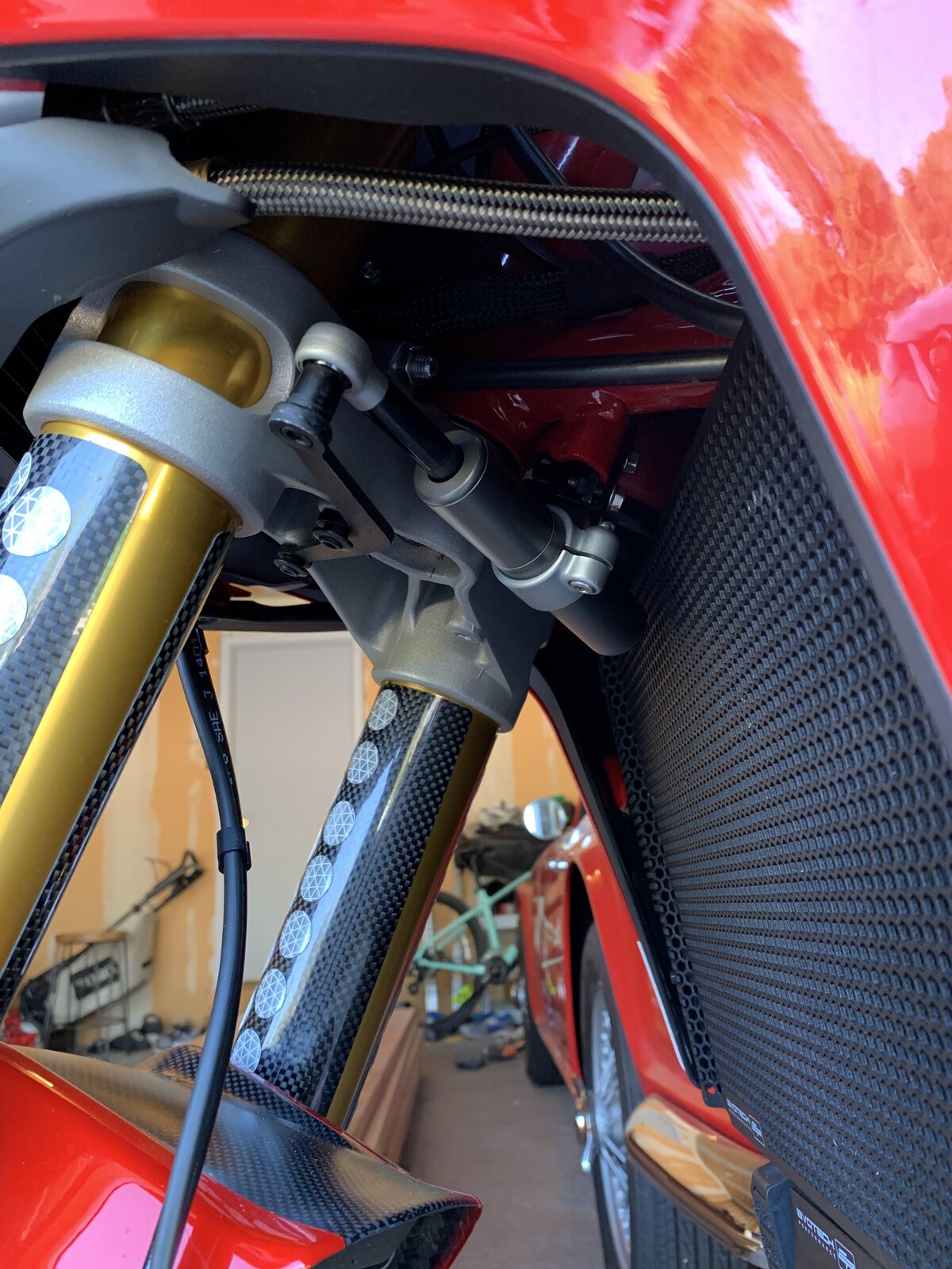

  1. I am struggling to find a steering damper kit for a post 2015 Mutley DVT. The only one I can see is the Ducabike unit which attaches to the fuel cap mount and I am not keen on that. Strain on a plastic fuel tank doesn't sound good. It also (IMO) looks an abortion
    I can find decent looking damper kits for the Multi 950 and for the earlier Multi 1200's (rotary type) but there seems to be bugger all for the 1200 DVT's - does anyone know of anything I have missed ?
    Ta :)
  2. somebody already has done one from a Enduro Mutley, he posted all the part numbers up, wasn't cheap though.
  3. You can bolt-on the 2016 Multistrada Enduro damper on the 1260.
    Parts list & photo (courtesy of krisnet55) :

  5. Awesome - thanks guys
  6. I found a complete assembly of steering damper c/w mounts on eBay Germany that has been taken from an Enduro so I have snatched it up. It's not adjustable, but it was only 158 quid all in, which I reckon has to be worth a shot. If it will fit, I can look to maybe upgrade the damper part later. If it doesn't fit - I guess I chuck it back on eBay :)

  7. Has anyone been able to mount a rotary type damper to a late model Multi?
  8. Easy bold on? Did it add some good stability to the front end? I always had Ohlins on my BMW's and track bikes with excellent results.
  9. Yes and Yes. :)
  10. Excellent and thank you for the information. I will order one today!
