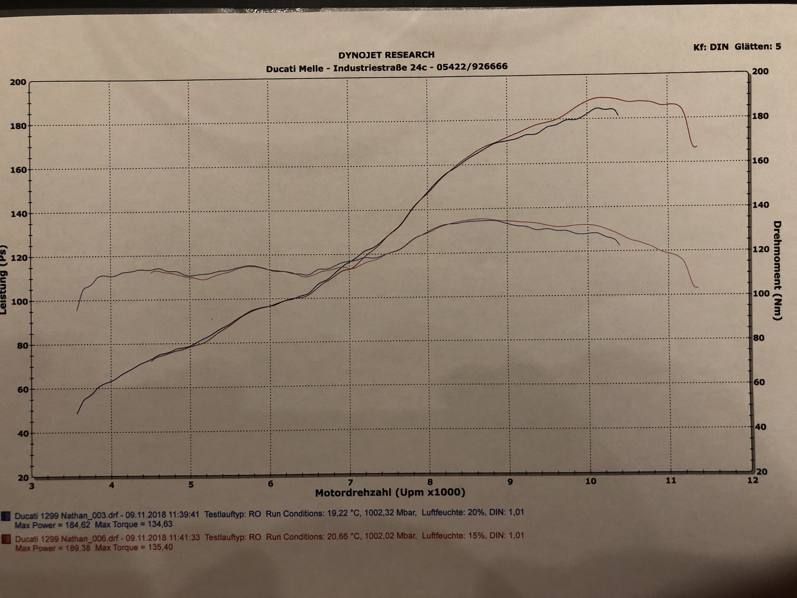

  1. So managed to get my 1299s on the dyno this morning for a quick run the set a comparison on with and without Rapid bike Evo fitted.
    First run without RB gave 184,6
    Second run with the RB connected gave a figure of 189.4
    But what you can’t see from the graph is how much better the bike pulled.
    Bike is a 2016, with full. Akrapovic with DB eaters + Upmap fitted and a BMC air filter.
    I have a Termignoni full Force underseat System to fit, and then I’ll run it again to see the difference.
    Note- I think the auto trim changes haven’t been applied correctly as I think I haven’t ‘sent’ the map back to the module after approving the changes, so user error could be a factor.

    I wasn’t right clicking on the Trim table and accepting the adaptive changes.. bugger.. but on a positive note, the run above was in theory a run with a standard RB map for the 1299 with the first trim changes, but as some were at the maximum value allowed ( as per -/+ settings ) there is real scope for improvement with a few trim map improvements.
