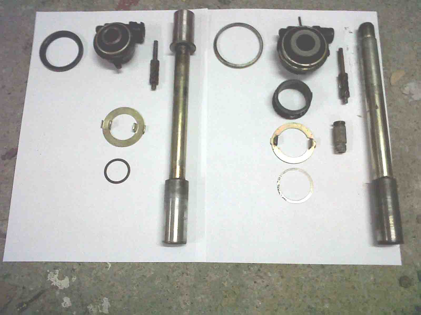

  4. Steve should have just fitted the later wheel and axle and speedo drive..........
    ......much less 'kin around even it didn't save much weight.....;)
    Nothing from the later speedo drive will fit the earlier wheel, not even the grease seal........
    ........so it isn't just a case of changing the bearings, spacer tube, top hat bush and axle.......
  5. i have a later type spedo drive,if your intrested i will sleeve it down for you.
  6. It won't fit..........it will be too large diameter to fit in the wheel hub housing........
    The early wheel housing is approx 52mm diameter and the later one is approx 58mm diameter........and they are machined differently in the housings........IE, the 'stepping down' in diameter is in different places.
    The later drive is approximately 52mm diameter and the earlier one is approx 45mm diameter (haven't had a chance to measure it lately).
    The driving rings are also not compatible being completely different in diameter and shape......the driving tags don't fit in the wheels the same way.
    Neither are the grease seals compatible, the later one being larger diameter, but thinner than the earlier one, so trying to swap the drives means they won't fit in them either.
    Here's chewy's photo of the different drives before I acquired both types..........You can clearly see why they will not swap over.
    Even the pinion gear appears to be a different length.
