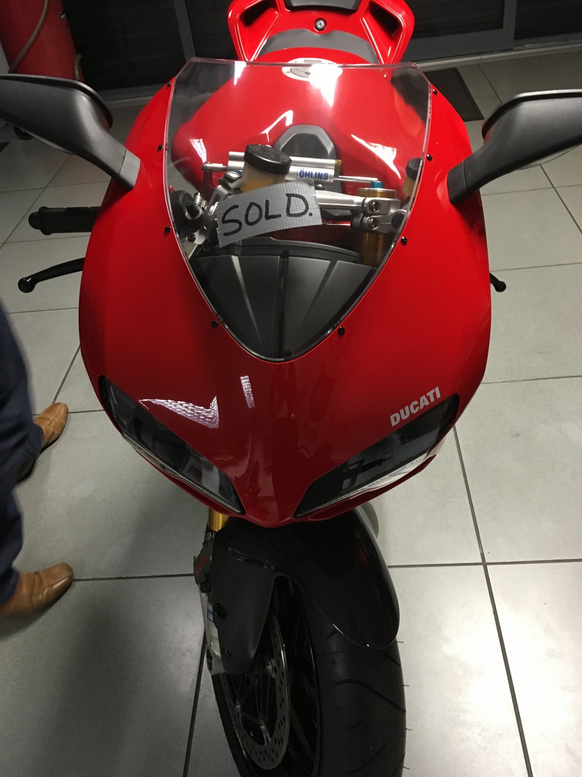

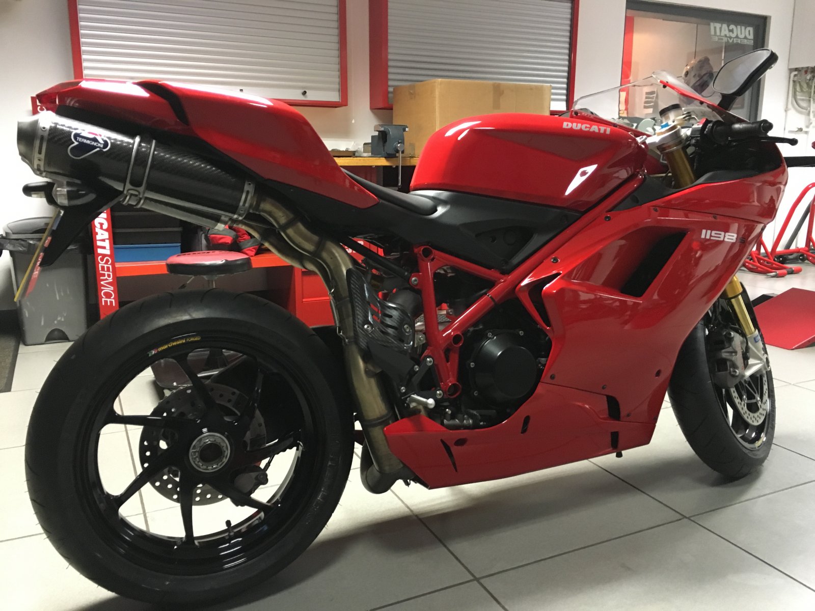

    No proper pics yet, just some I took at the dealer... (That won't upload from my phone)

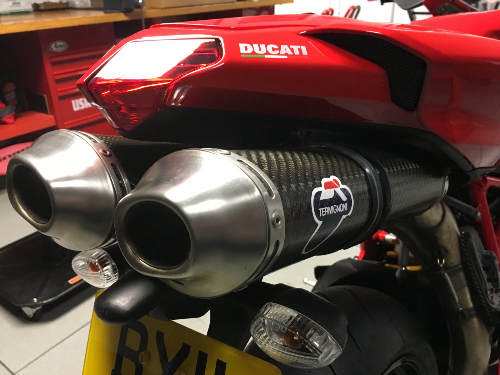

  17. Love the Panigale... But really dislike the exhausts. So it had to be this...
  18. Be interested to hear your thoughts once you've taken it out for a blast.
  19. Is a minter. Do you know who had it before, and why such low mileage?
