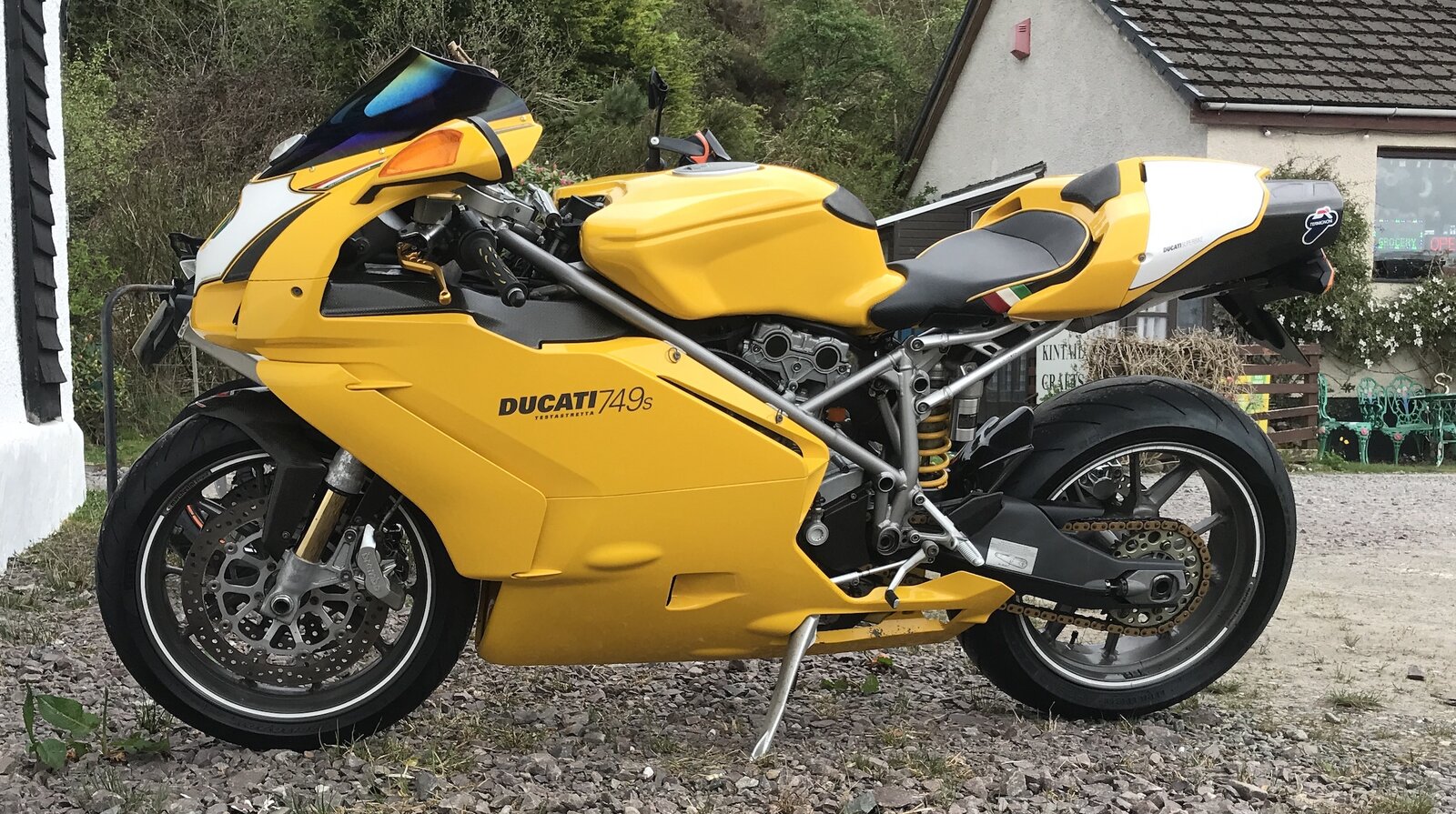

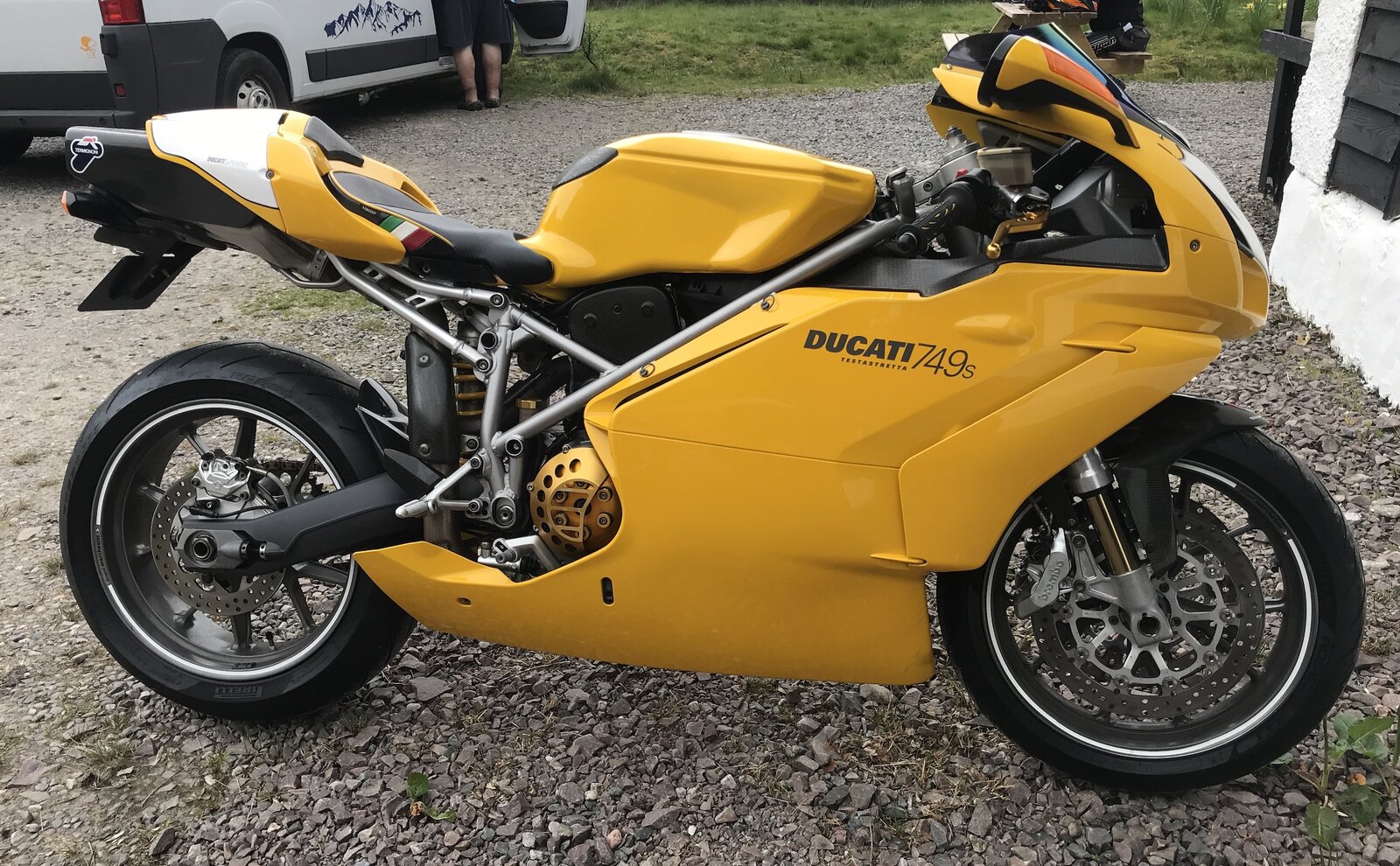

  1. Just bought 2004 749s after a variety of Ducati's, a V4s Multi as my keeper and this one as a somewhat romantic return, it was either going to be this or an old Bonnie, the 749 requires a little less constant oil leak chasing. I had a red oine several years ago and always regretted getting rid of it for an 848, the S really feels so much more visceral and last of the real 'man's' bikes, so that is what i was after.

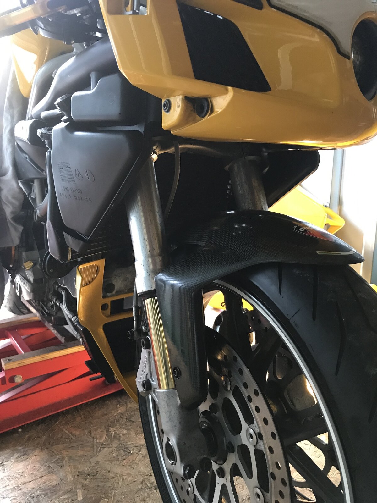

    Nice pics and decent spec on e bay (7500 miles) and £4800 later she turned up today and regretably not up to what i was hoping. looks like someone left this outside for 20 years as everything is corroded, all bolts, subframe, engine paint peeling off, fork spring rusty, but worst of all leaky fork seals and pitted lowers, completely dissolved uppers, right bloody state.
    I ran her out for 30 miles or so, still handling OK with a sagging front end and oil pissing out of the fork leg, clutch VERY heavy, not sure if I remember it that bad, brakes Ok, idling and tickover OK ish.
    So it is a bit of a head scratcher now, cant go out again until the forks are oil tight, but really should get a new set of fork legs, and then of course it all starts...spending money trying to redeem this old bird. any good advice to offer?

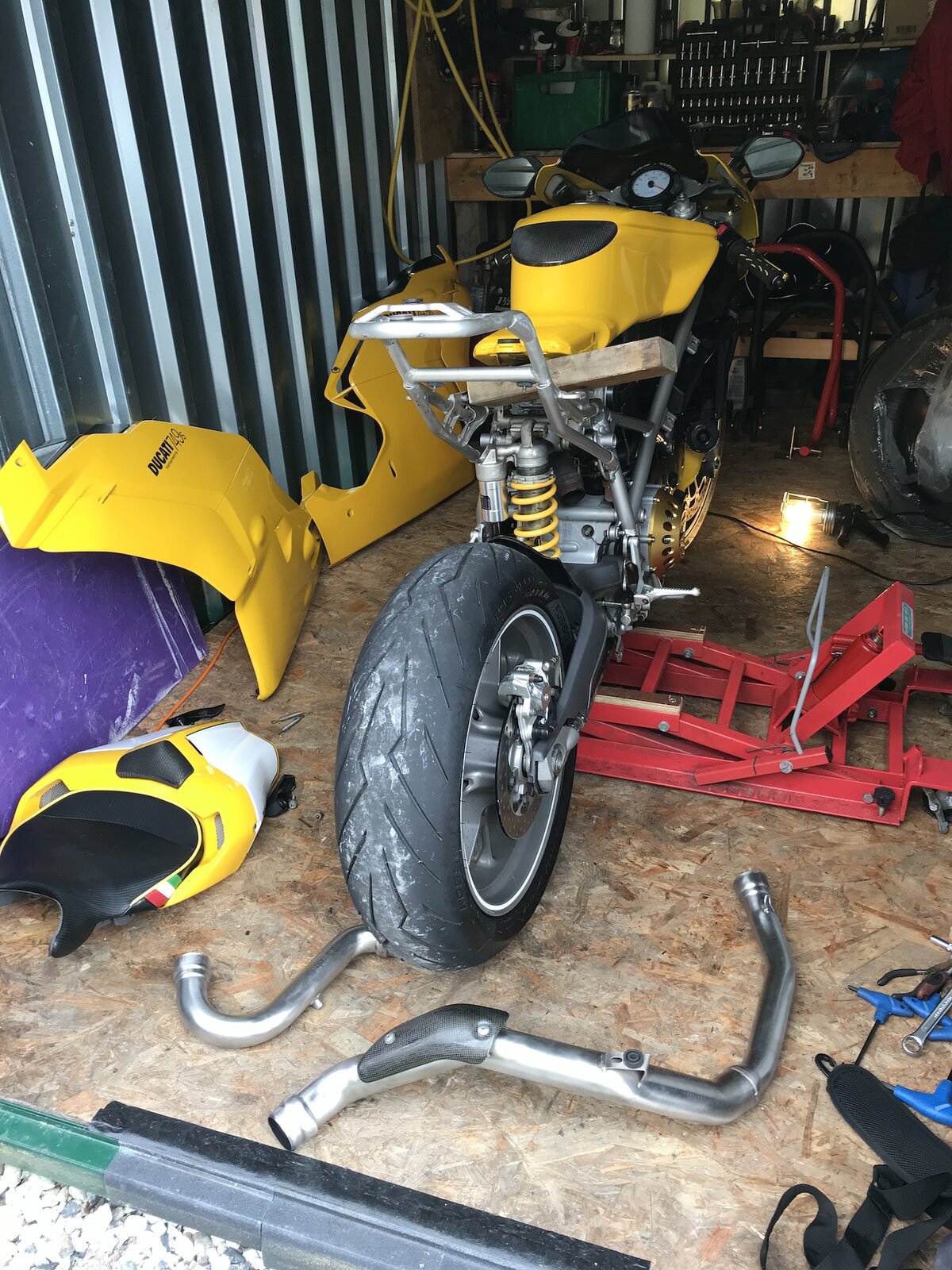

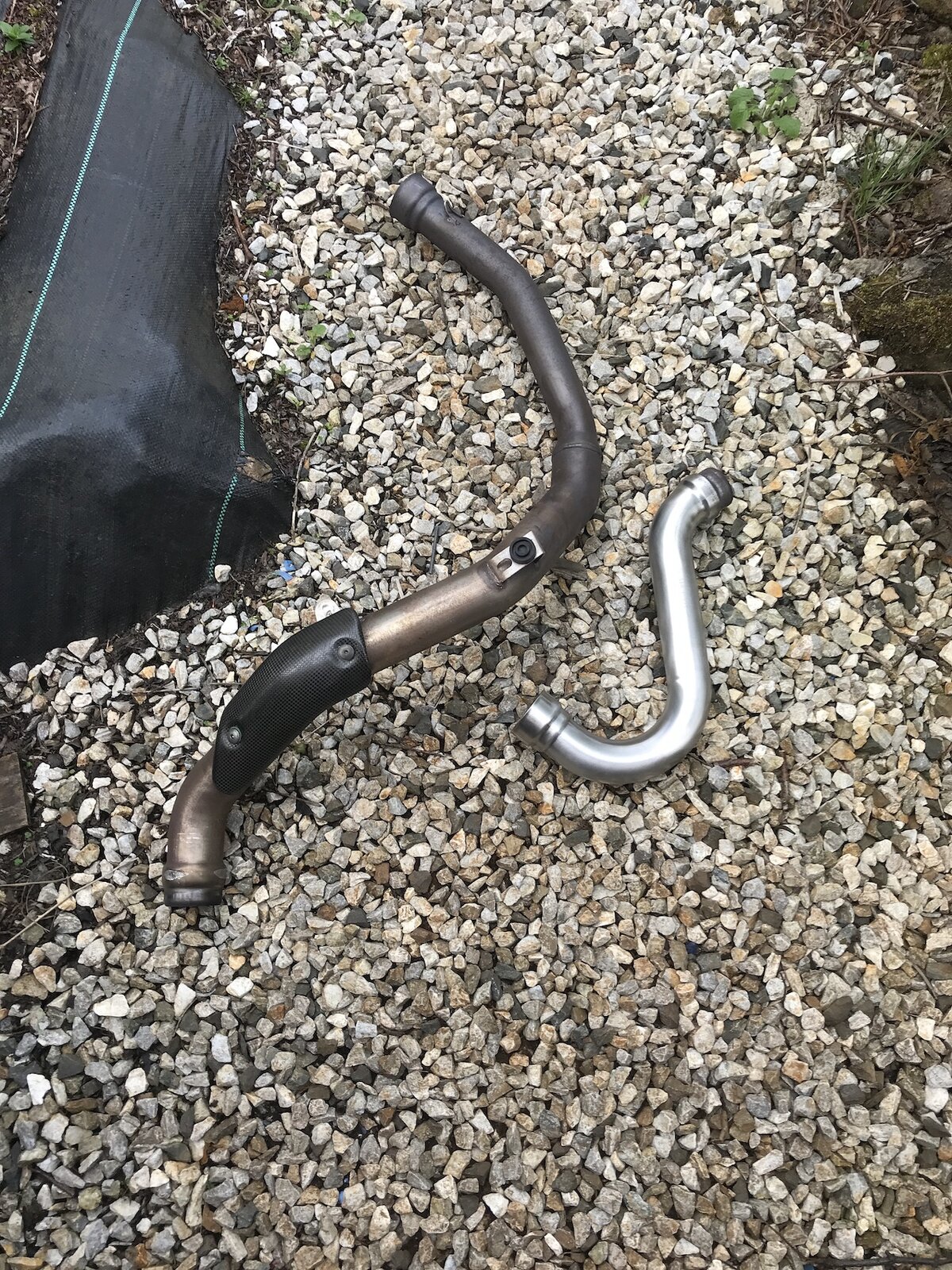

  10. OK, in we go!, cleaned up the pipes nicely, checking what i can as i go.
    Now, can i get the front forks out without taking off the front fairing/airbox tubes/coolant bottle etc? or do i have to keep tearing it down ? going to either remove and repair/clean the fork legs or replace. IMG_1061 2.JPG IMG_1062 2.JPG IMG_1063.JPG
  11. Unless it’s rhetorical, you can easy get the forks out without stripping anything at all
  12. Those pipes came up pretty well!
  13. oh, nice. she is up on the engine block and stable so just wheel out, pinch bolts,bars off and slide the fork tubes out? I should be able to manage that just didnt want to get too deep in the first breakdown. anything to be aware of?
  14. thanks man, my job requires a lot of cleaning and polishing so had some nice scotchbrite wheels to hand.
  15. erm,nope, no way to get a 6mm allen key up into that space with any movement, so all that shite needs to come off as I feared, airbox legs dont come off without the front fairing coming off, what a to do!
  16. Yes. I’d mark where clip ons are now (if they don’t have a pin) as well as how high the forks are thru the top clamp. Pencil or chalk works well for me. Wheel out, incoming bolts, slide out downwards (iirc)
  17. Can you move the bars from lock to lock to access? I’ve had forks off 996, 848, 1299 and various other Ducatis and never needed to remove anything else
  18. It can be done without removing the nose fairing but one needs suitable tools to allow access to the lower yoke clamp bolts.
    Personally, I tried once and then just removed the nose fairing as life is so much easier with clear access and it’s not much bother to remove it anyway.
