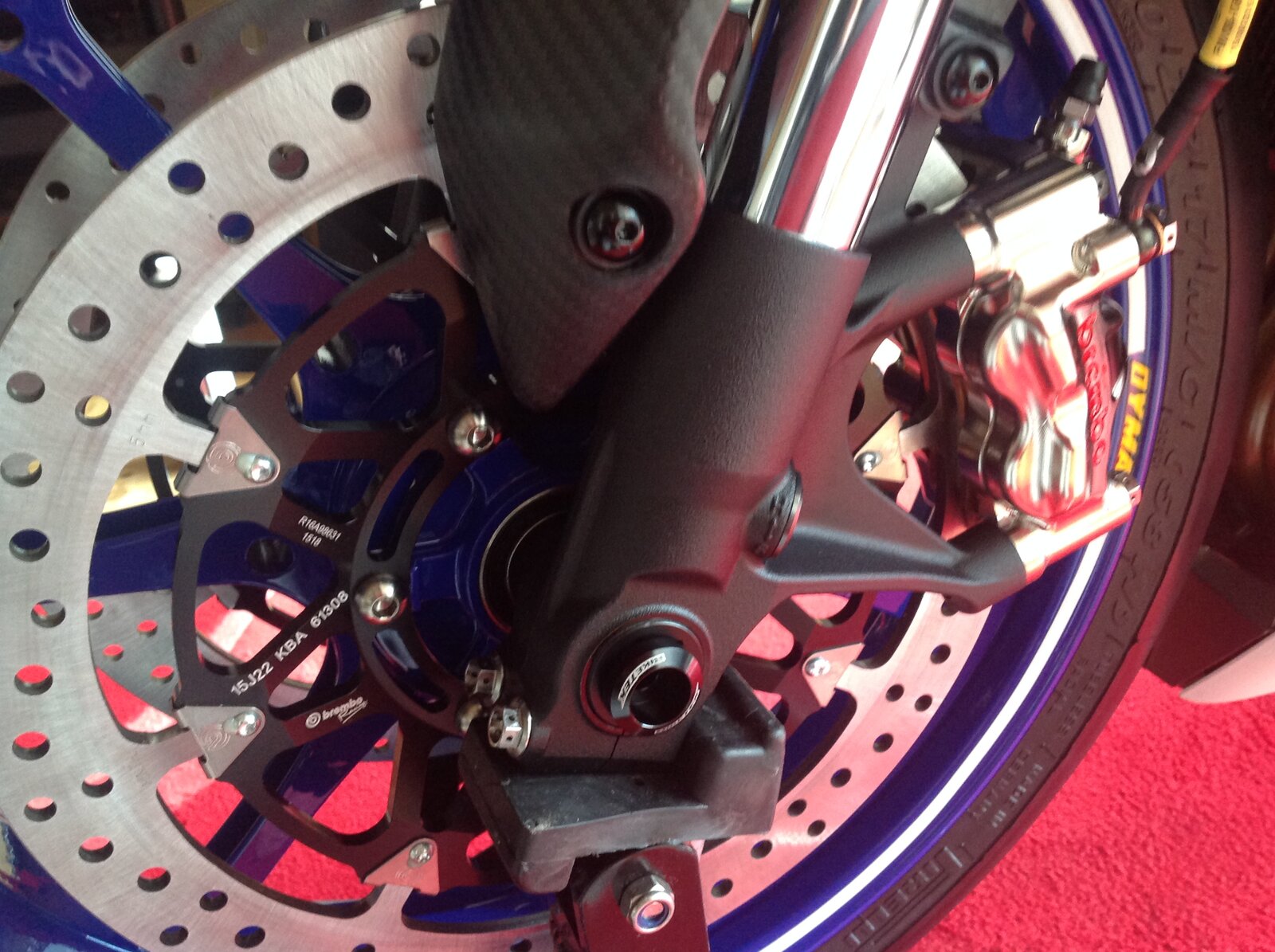

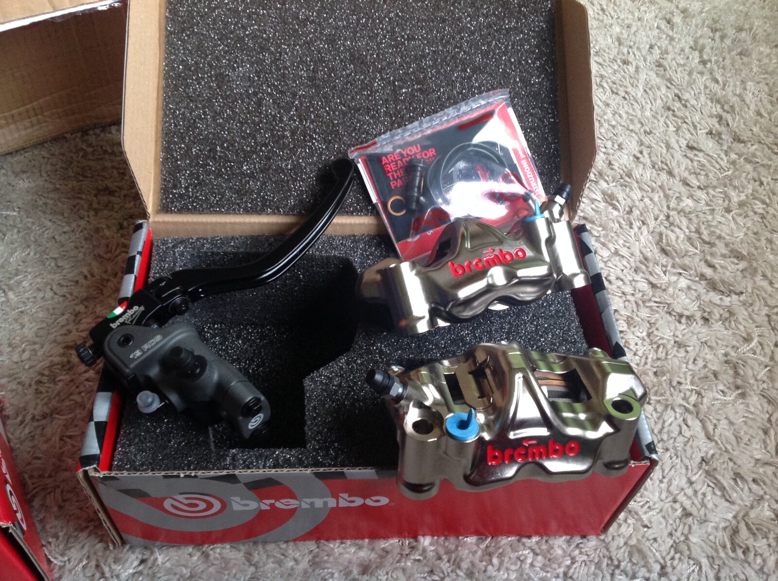

  9. Sorry probably not want you wanted to hearo_O I’ve also run EBC set up on an older project fast road and track day tool. Never ever got a confident feeling what so ever! and brake fad was on another level :dizzy: terrible modulation.... the only positive thing was the price point!
  10. The GPfax stuff isn’t too bad. But it murders discs.
    I’ve always chosen Brembo over ebc tbh

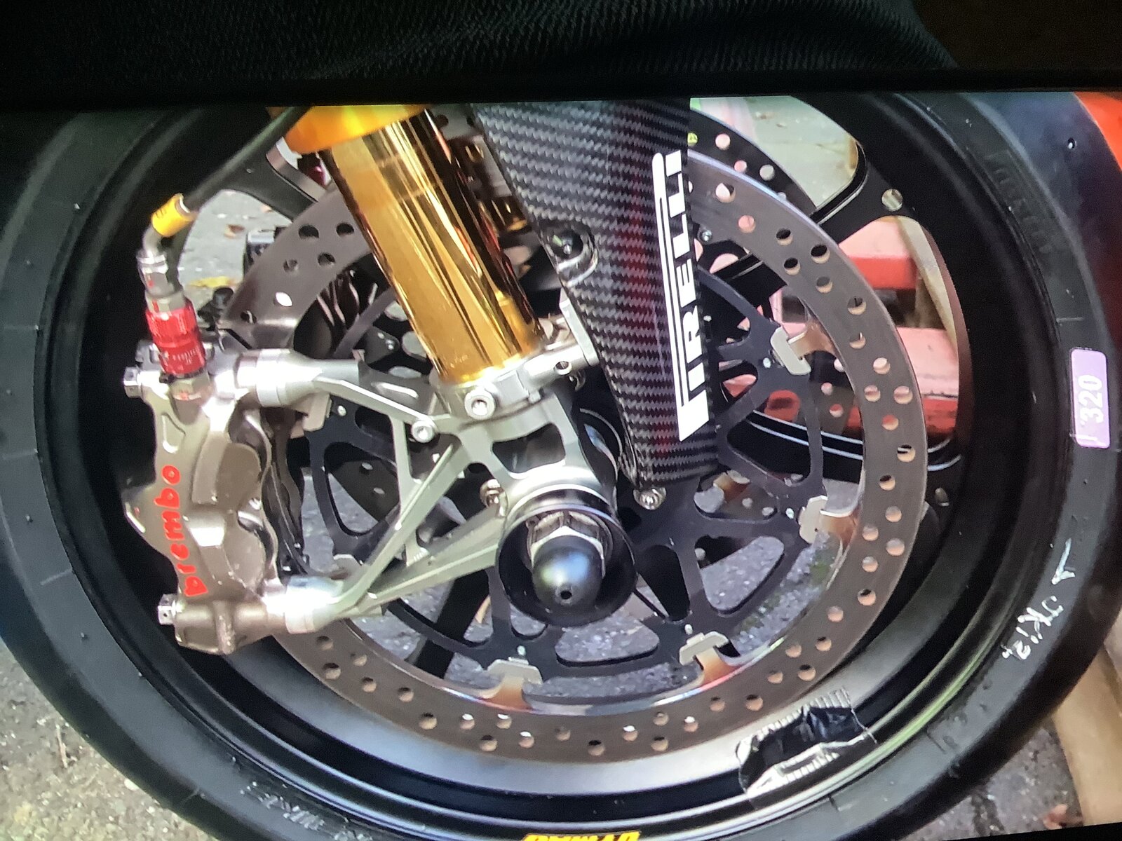

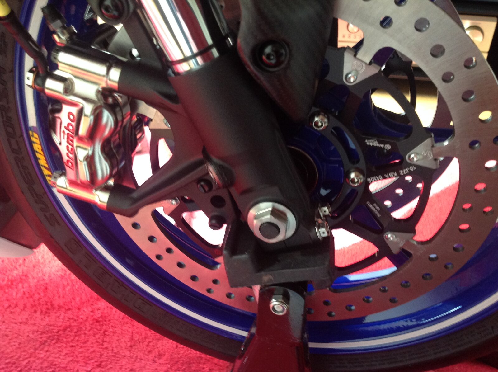

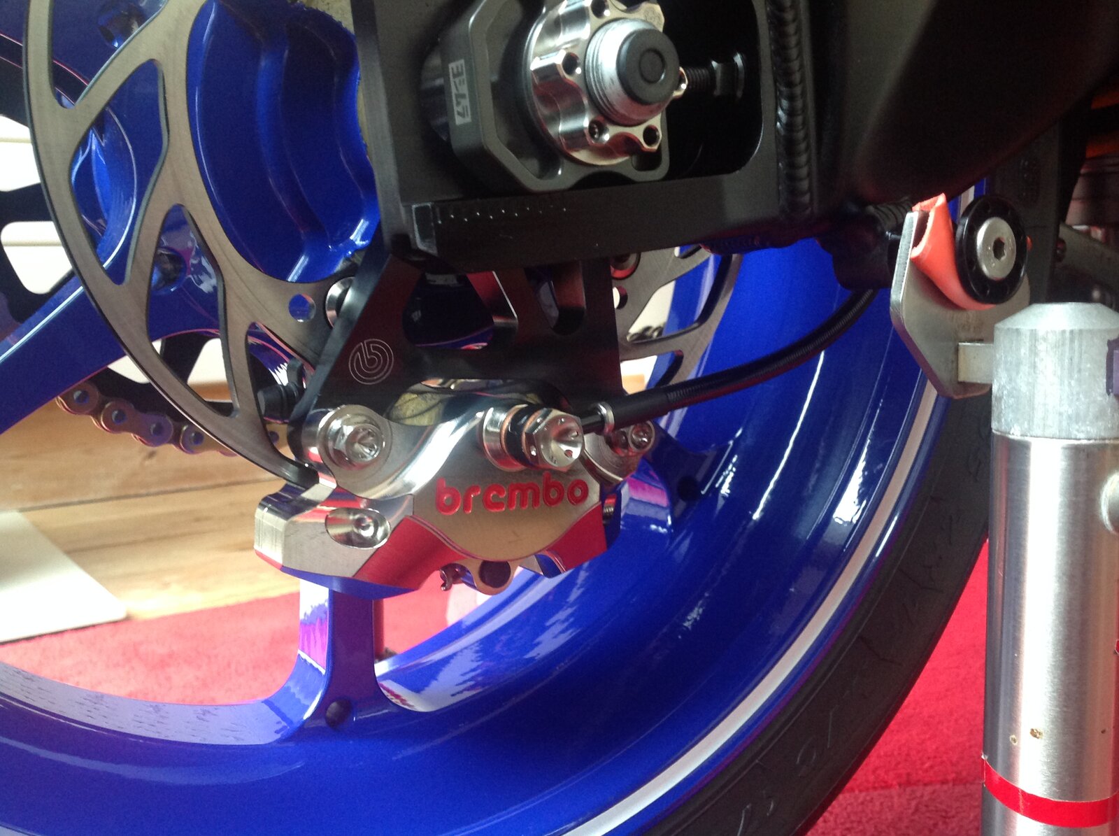

  11. Not cheap but worth the extra! Demon braking, Zero fad, excellent feeling at the lever every time without the dramas...
    D7338526-256B-4C66-AF4A-F513F13E89EB.jpeg DDE041EE-47FF-4ADD-A0F9-A23DF1F4BF21.jpeg 7D65D72C-7FC1-4021-870C-0A72A1266538.jpeg 8B44A846-2F61-4605-9D73-D6EADF51244C.jpeg 90858E4B-0668-4206-BA0E-1079C1437579.jpeg
    • Like Like x 7

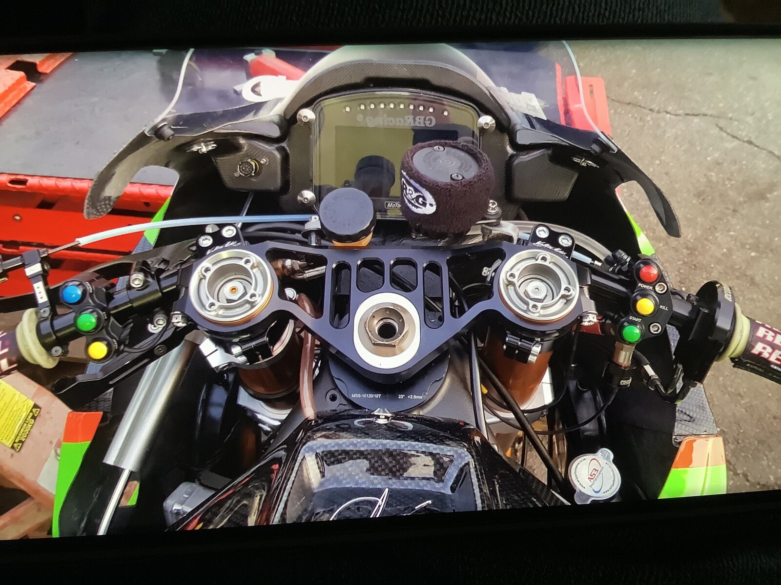

  17. only my old blade..... The ZX10 was Leon Haslams BSB winning bike from a couple of years ago. Bournemouth Kawasaki is my second home:) Even though I don’t ride a green machine anymore:D
