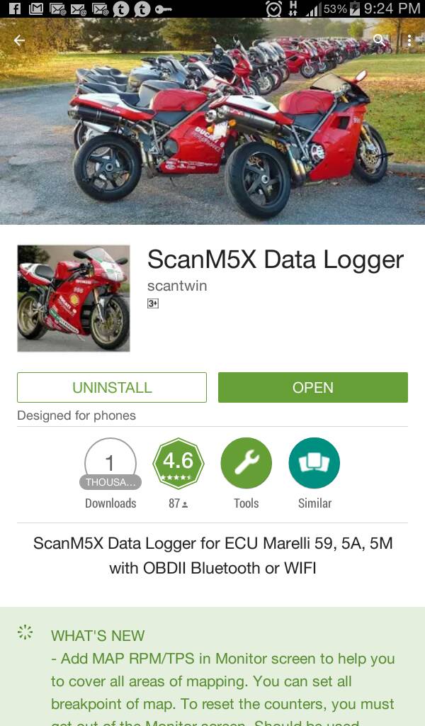

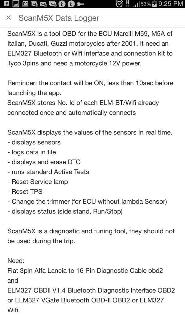

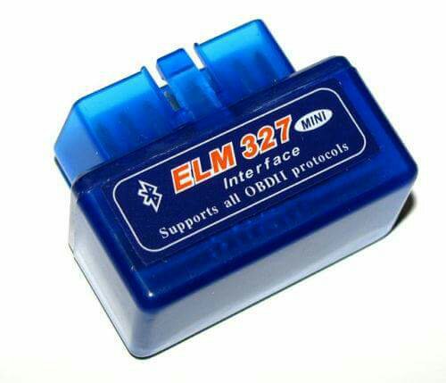

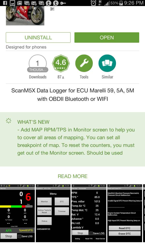

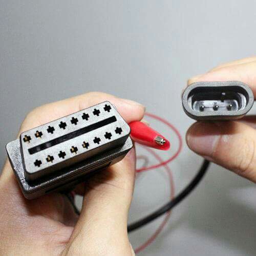

  4. Something the dealers won't tell you is that there is free Android software out there and only requires a smart phone or tablet for the ScanM5X software plus two eBay items: Fiat 3 Pin Alfa Lancia to 16 Pin Diagnostic Cable OBDII and a ELM327 v1.5 OBDII Bluetooth Adapter Auto Scanner. See the photos below
  5. I meant to add that this has been used successfully many a time on my 999S. The bluetooth adaptor and cable are not expensive at all.
