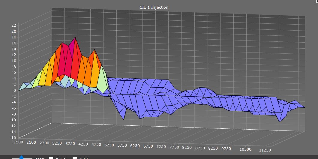

  7. Always had good results with the Rapidbike Evo on my 1199 and on my KTM 1290R, bikes both felt a lot smoother and allowed me to add the Motohooligan airbox to the KTM without a remap, could keep an eye on the fuelling and optimise the map through the Rapidbike master software, it also maps each cylinder individually on a twin.
