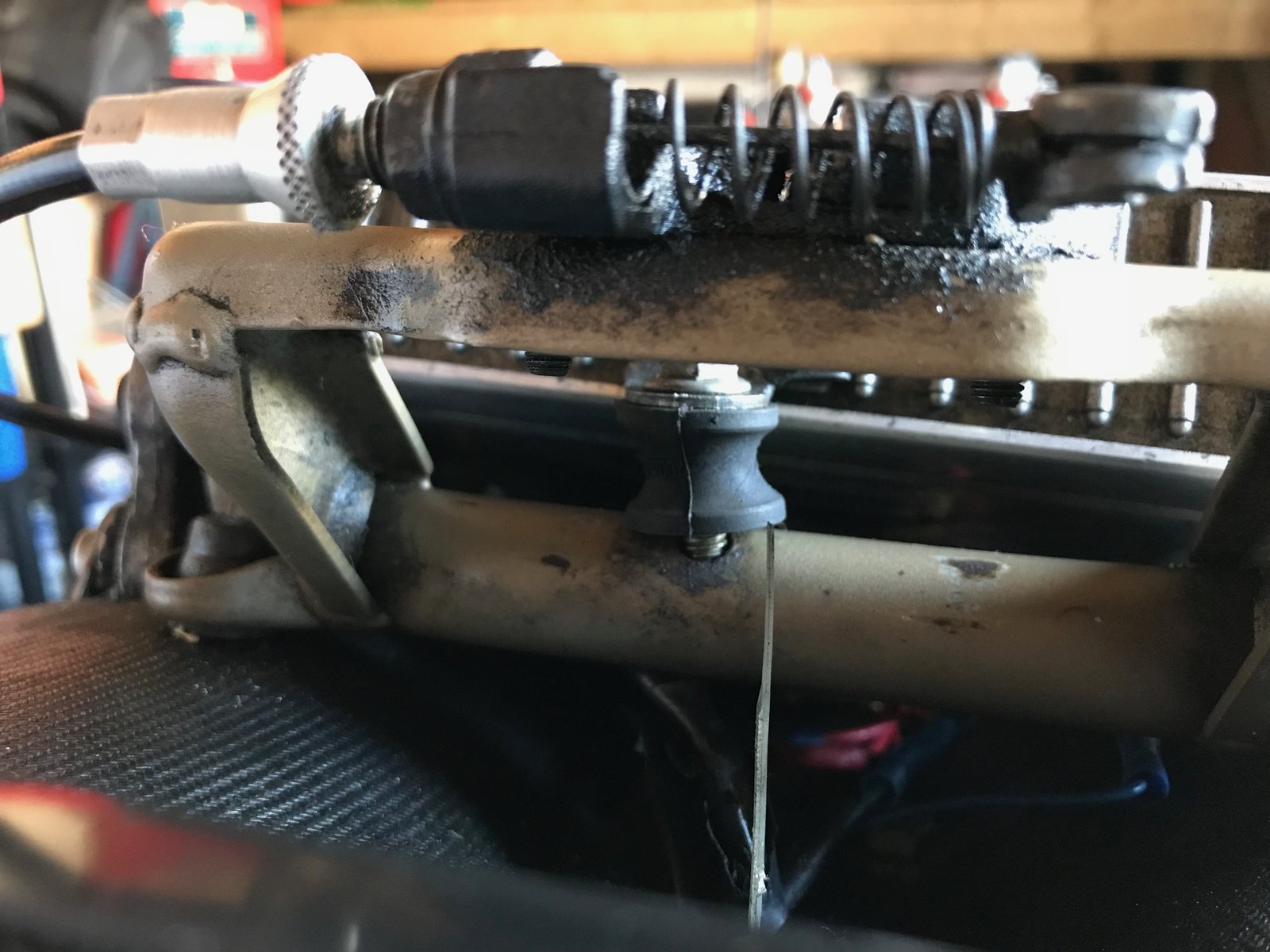

    Can anyone help me please. My recently purchased 1994 916 Biposto seems to have some issues under the seat:) Can anyone tell me if it has the wrong ECU or is it the wrong subframe? Someone has drilled into the subframe to mount the ecu, and the rest is just floating around!

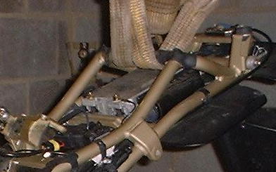

  2. This was my 98BP. I don't know how much changed from 94 to 98, but the ECU looks very different. :(
    #2 Robarano, Jan 28, 2018

  3. That's the P8 ECU in a BP subframe. The P8 was used on the early mono and also SPS. The ECU in Robarano picture is the correct one for that subframe, so you may have bought a mono or even SPS that has been converted to BP. You have any more info or pictures of the bike?
  4. As above, looks like it's an early monoposto 'Strada' bike that's been converted to carry a pillion.
