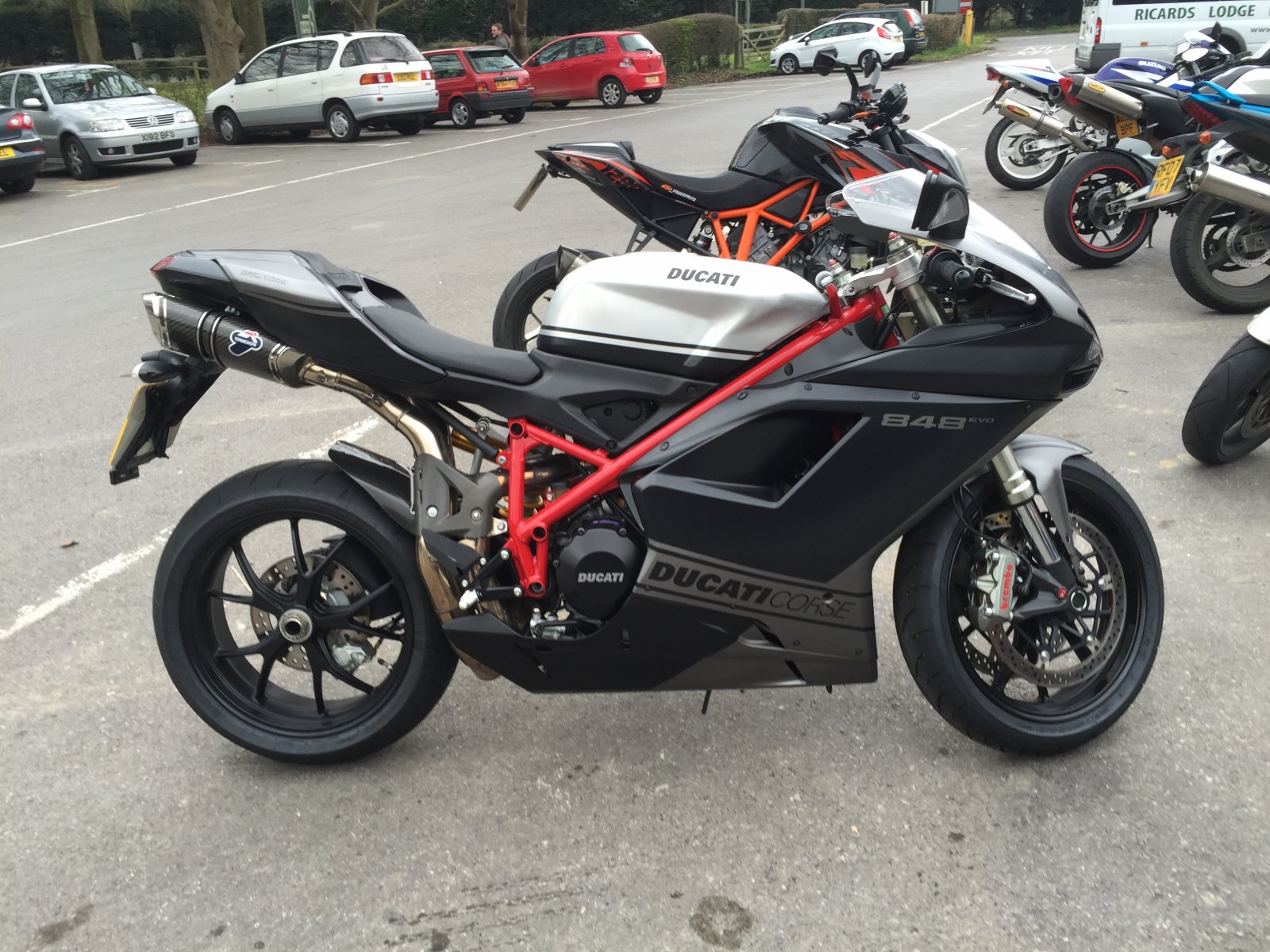

  1. Well here is my baby Ducati 2013 848 Evo, so far the only upgrades are full system Termi, and 1 tooth less front sprocket. off to moto rapido this morning for ECU flash 60 mile ride there and then a 60 mile ride back.
    I was really surprised at the difference between this and my od 2011 Evo.
    2011 model used to lurch a bit on the throttle 1st & 2nd but they seemed to have ironed that out on the 2013 model as it is a lot smoother.
    Lets see what the ECU flash does to it.
