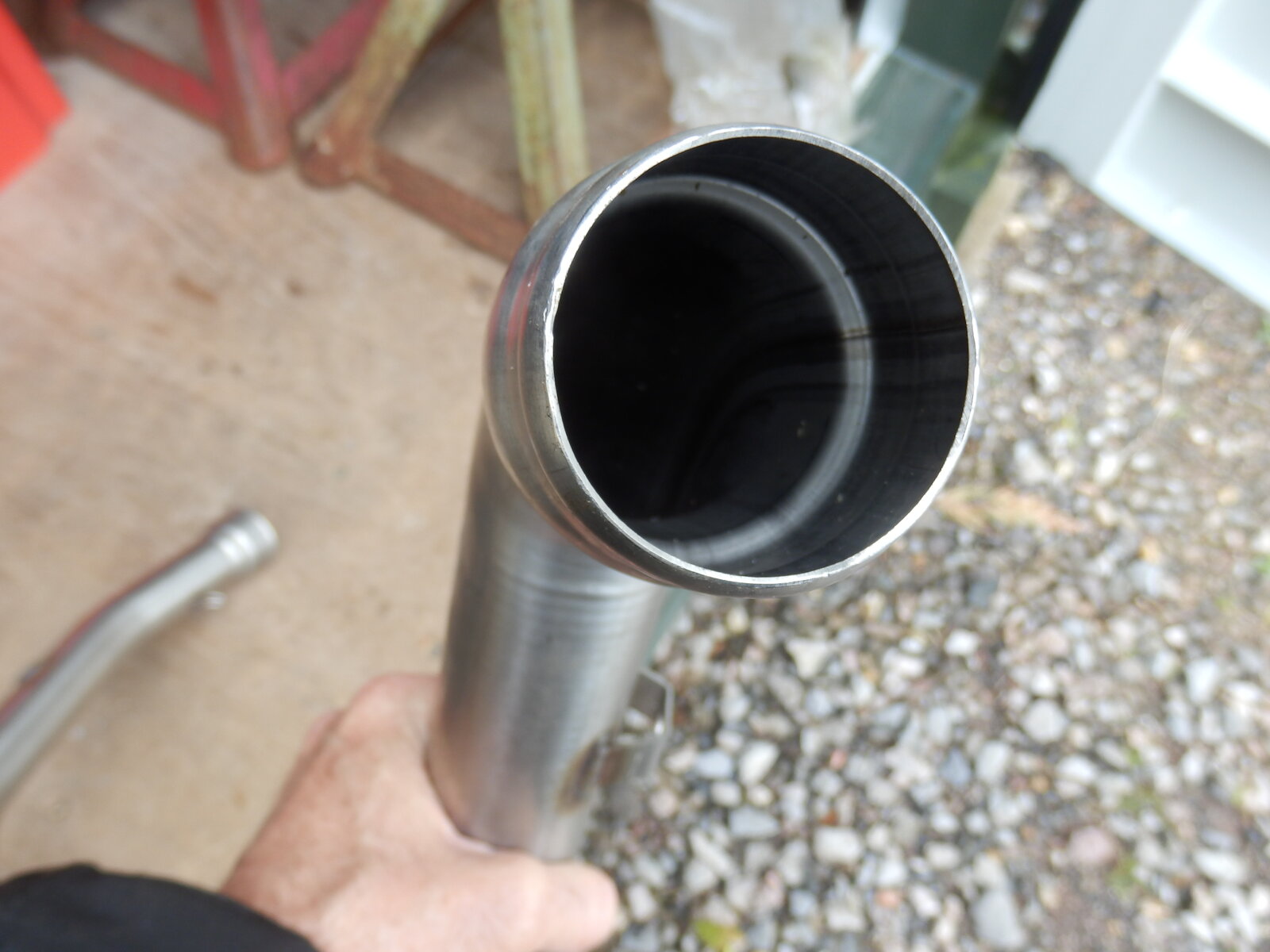

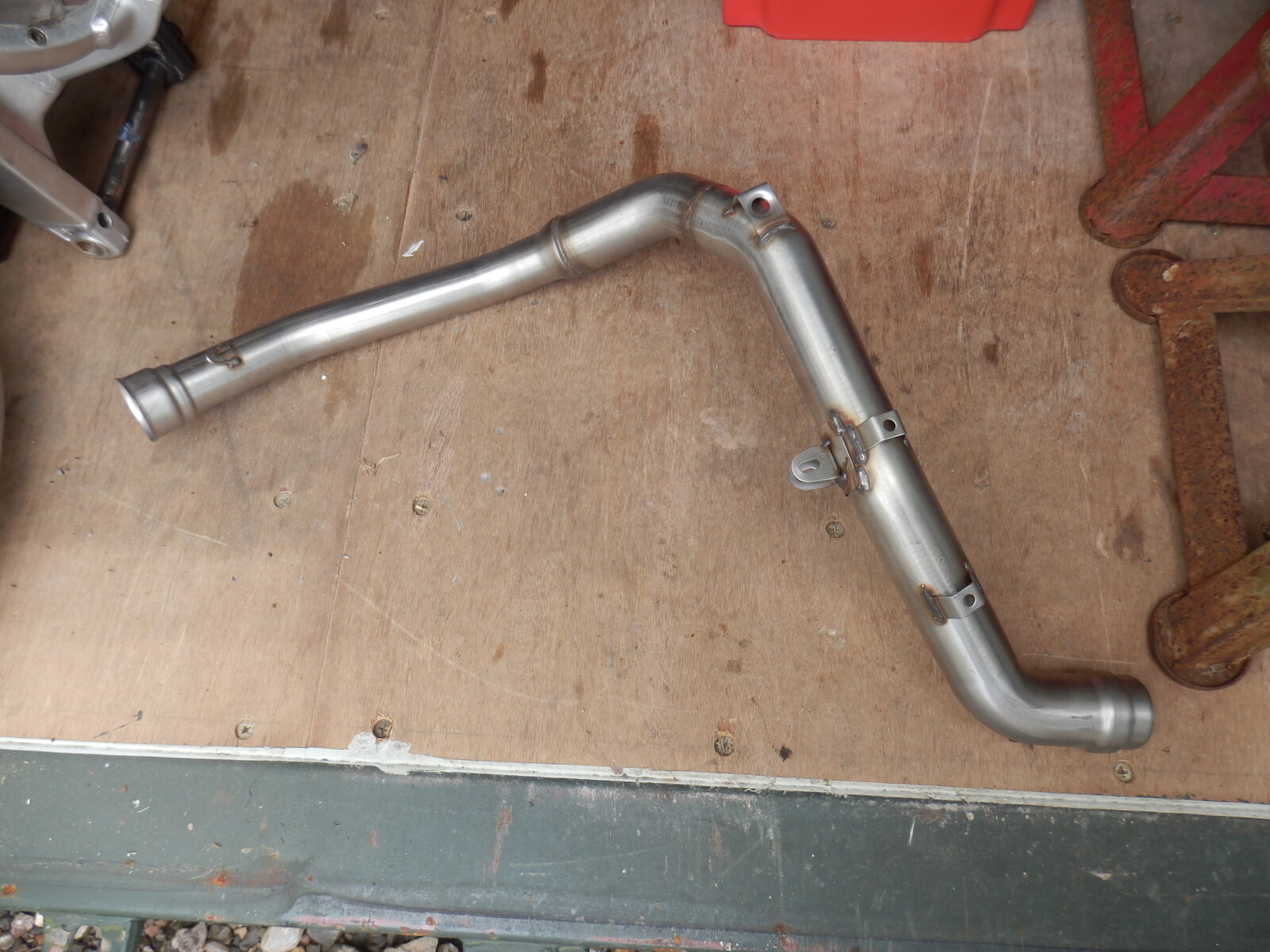

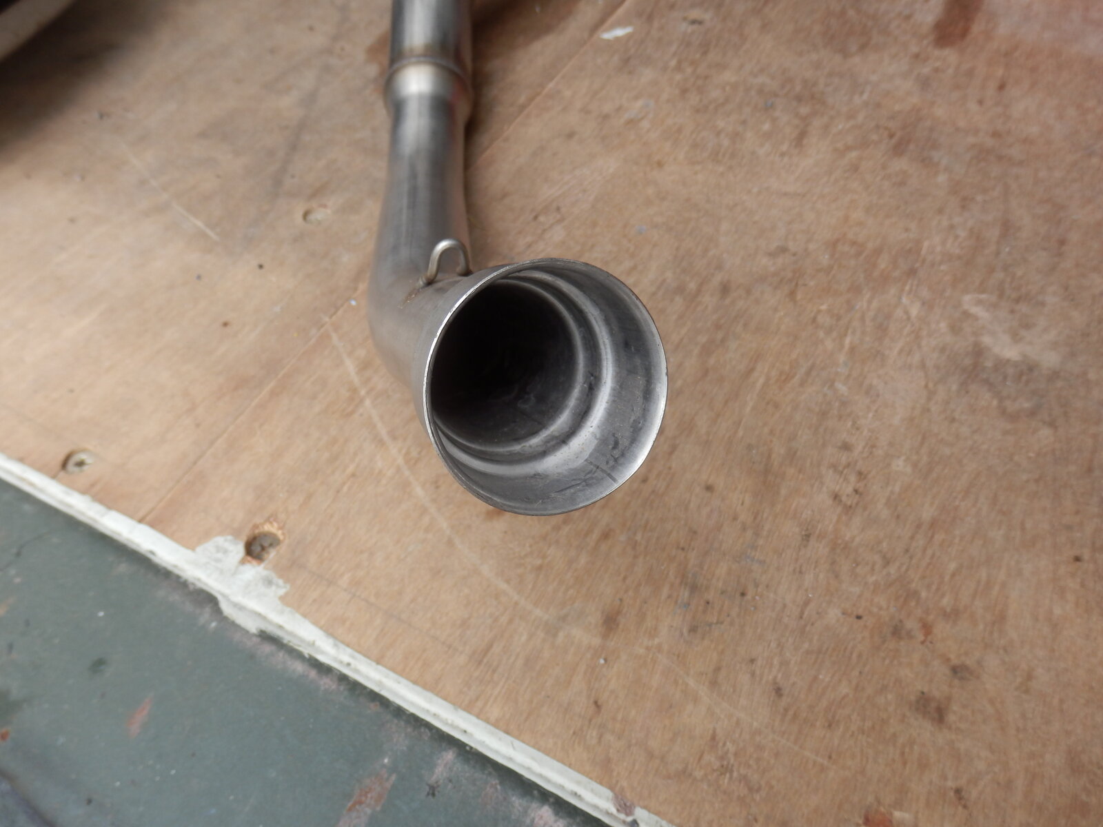

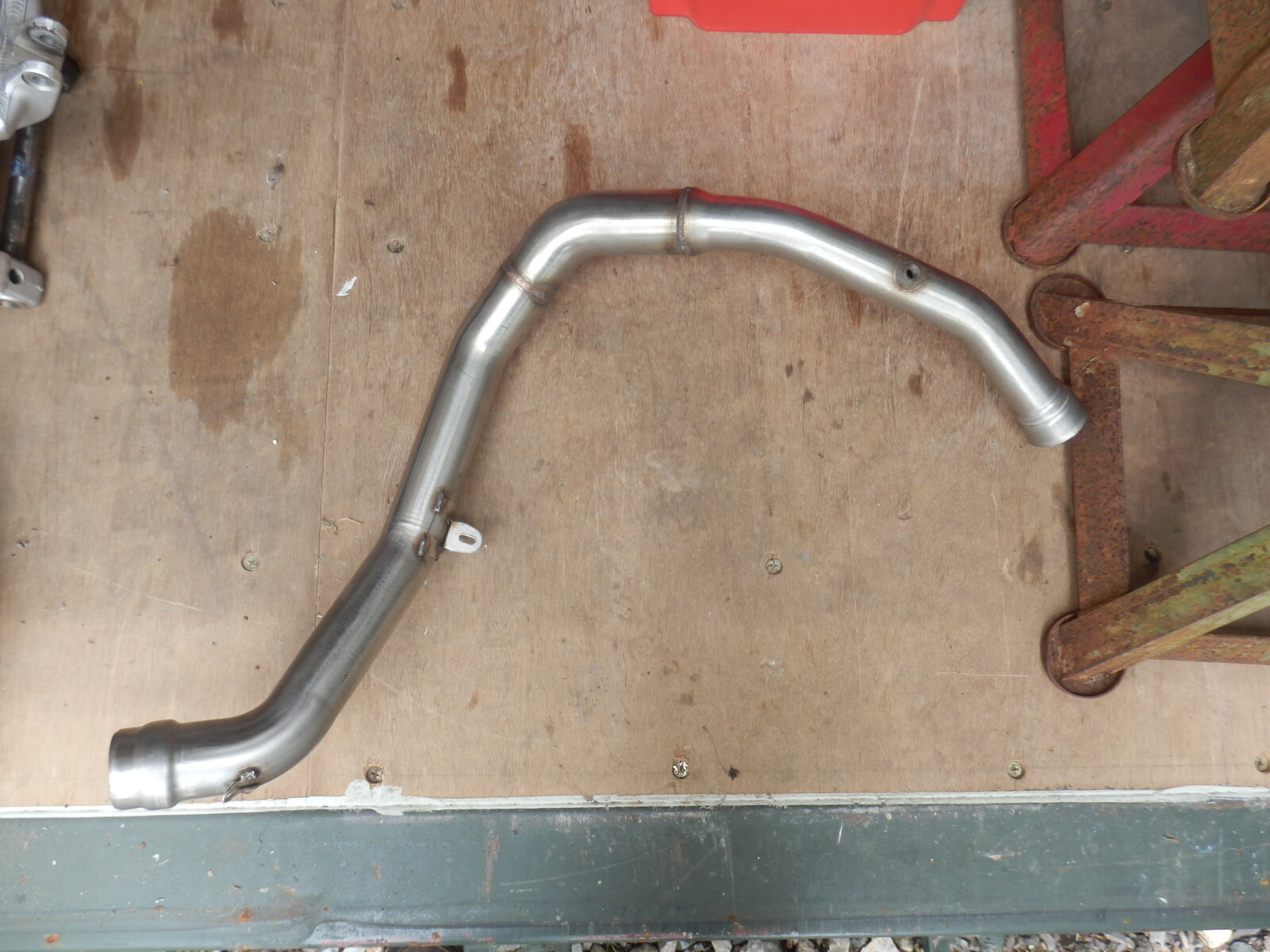

I've a spare no-CAT front Header pipe to fit a Deep Sump engine and later Black swingarm if you are looking to purchase one.
Sorry, discovered I'd put it in my storage container, but dug it out this evening. It's in really good condition and looks to have been hardly used. I've never had it on my 999, it came to me with an exhaust system but I already had a de-CAT pipe on the bike so didn't use this. Posted within the normal UK limits, £120.
Bit far from me ! Message me your details and will pay you after work today. Just to confirm fits deep sump and later swingarm ??
Bit far for a pick up !, message me your details and I'll pay you when I finish work. Just to double check it does fit 999 with deep sump and later swingarm ?
Hi. Yep, it's exactly the same as the one on my 2005 deep sump 999 with the later Black swing arm. Will message you some details.

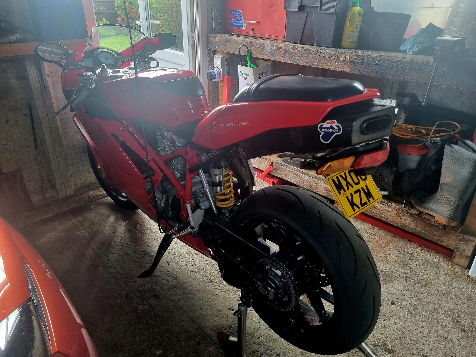

This is the map I had on my 2006 999 with Termi slip on (including horizontal de-cat pipe): 28640801L I would advise you do your research as it was installed when I purchased the bike. I used the GuzziDiag software to connect to the bike: https://www.von-der-salierburg.de/download/GuzziDiag/ You need these versions: IAW5xReader V0.28 (5AM, 59M) IAW5xWriter V0.24 (5AM, 59M)
