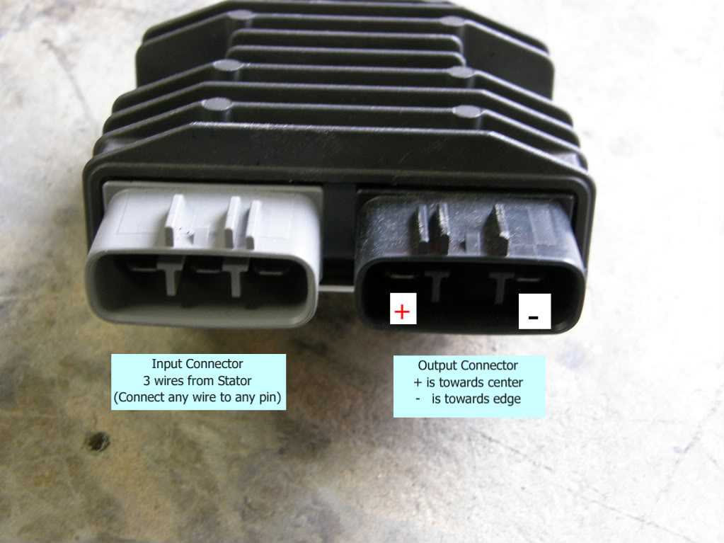

  7. The 4 wires to your regulator are red = +ve out, black = -ve out to ground, 2 x yellow = ac input from alternator.
    Look for a Shindengen Mosfet regulator like this
    They are used on most modern Ducatis, Triumphs and many Japanese bikes. The have 3 input terminals but you only need to connect your 2 yellow alternator wires to 2 of them leaving the other terminal with no connection.
