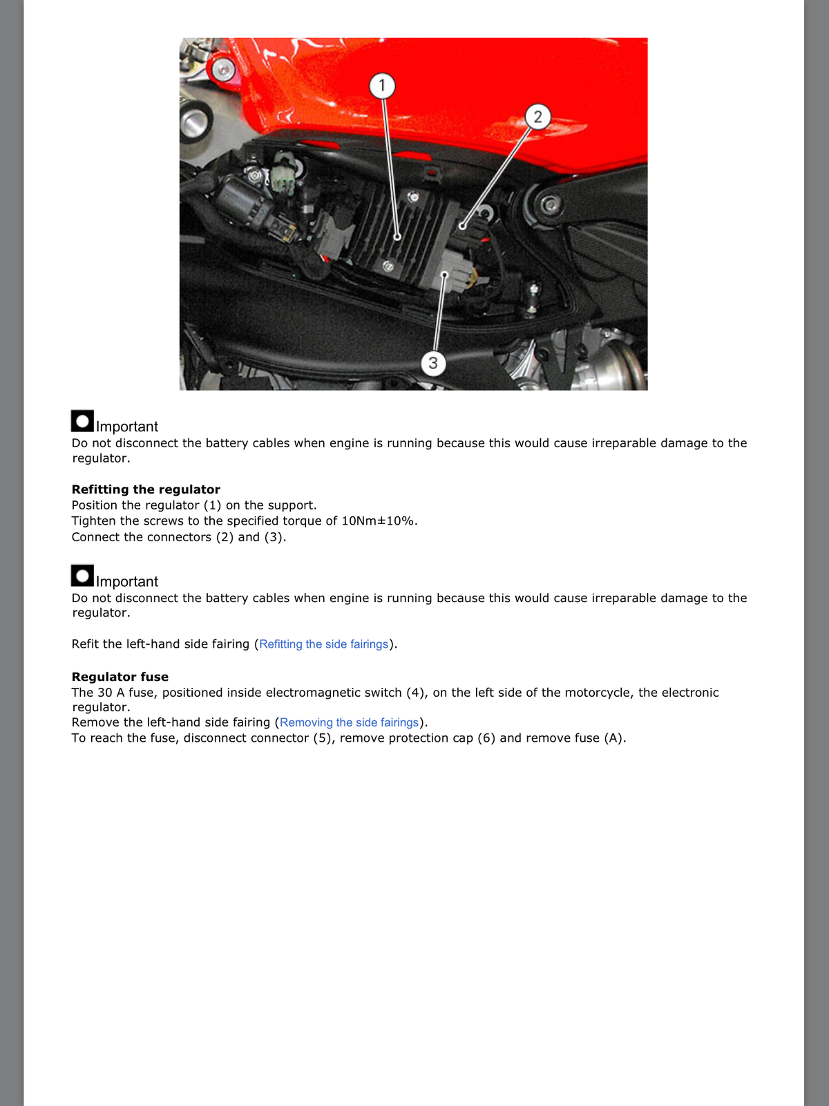

  2. I imagine you've got a rectifier that's knackered, when they go they can smoke plus they kill the battery.
  3. Cheers Jon, didn't think I'd find any more fuses! :)
  4. That's a 959 manual, but I assume they're same or similar
  5. Yes it is exactly the same. I removed the rec/reg and did checks with a multimeter which seem to check out ok, battery voltage is good at rec end and I have readings of zero for neg and readings between 432 and 437 for each stator wire although I don't have the Ducati factory readings for comparison? It's not a cheap component so not sure that it is at fault, however I've been wrong on many occasions (ask the wife)
