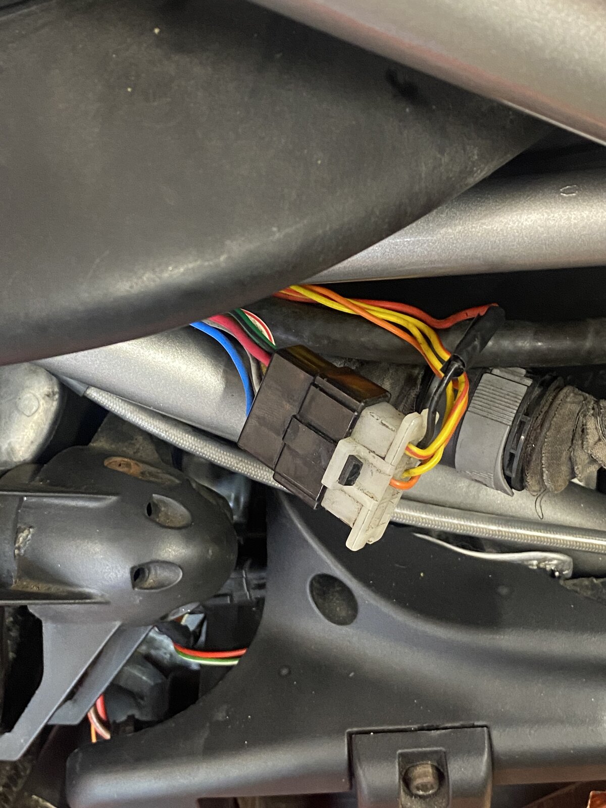

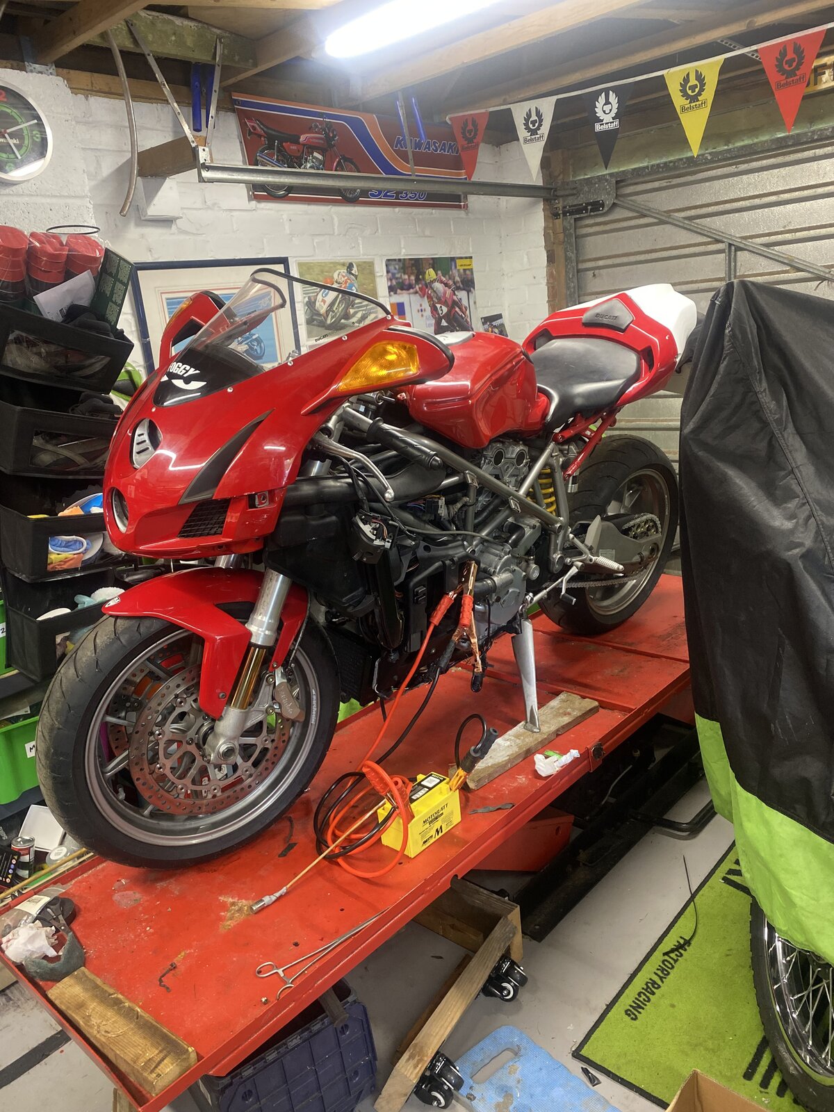

  5. It’s sorted. Some contact cleaner in the ignition switch block connector and it all kicked in. Thanks again for the help. IMG_3281.jpeg IMG_3277.jpeg
