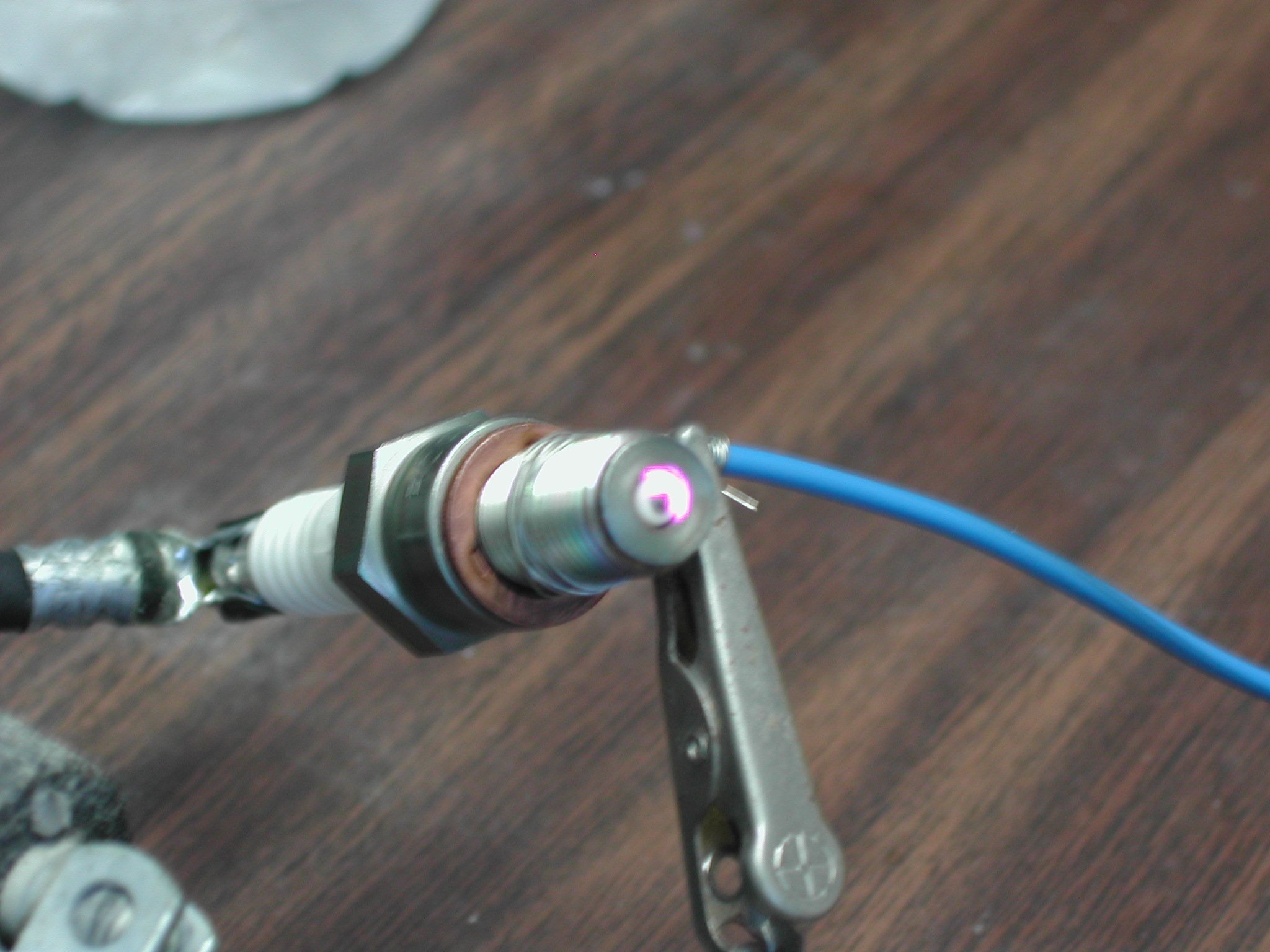

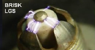

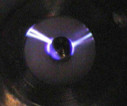

  13. the electrode is fatter, and the surface area is greater.
    standard plug: ground electrode sticking down and gap fed by the resistance coil. - spark arcs between gap and electrode.
    surface discharge: ground electrode is the outer ring so the spark discharges across its whole circumference surface.
    vs
    you improve it by adding more electrodes:
    but like valves, it comes down to surface area. the more surface you have to spark the greater the chance of even ignition burn and the prospect of limiting misfire.
