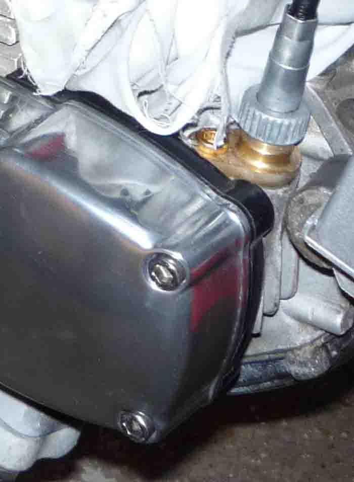

  5. Depending on which engine and heads, you might be able to fit a mechanical one, but I would need to see a pic of your engine where the front cylinder belt cover is.......just above the 'top' of the cover near the front......
    AL
  6. Nice find dad. I'll look into that.
  7. Right Al I'll get some pics, cheers.
  8. I'll keep an eye out for one mr r, cheers.
  9. Saved you the bother of pics...............Have a look at this one..........
    Is there anything where the brass bit is, like a blanking plate with what should be a single screw?.
  10. Thanks Al, just went out to the shed, no nothing, just cyl head casting. I'll get some pics up tomorrow, cheers.
  11. Unless you have something there, or you are a brilliant engineer, go electronic...........that's the tacho drive take-off.......
    Driven from the cam (worm gear between two bearings on the cam........you will have a spacer, I reckon), which drives a vertical pinion into which the cable is connected......
    I have seen three monsters with mechanical drive tachos........so I guessed SS heads been fitted......or did some monsters have the SS engine???? I dunno.........
