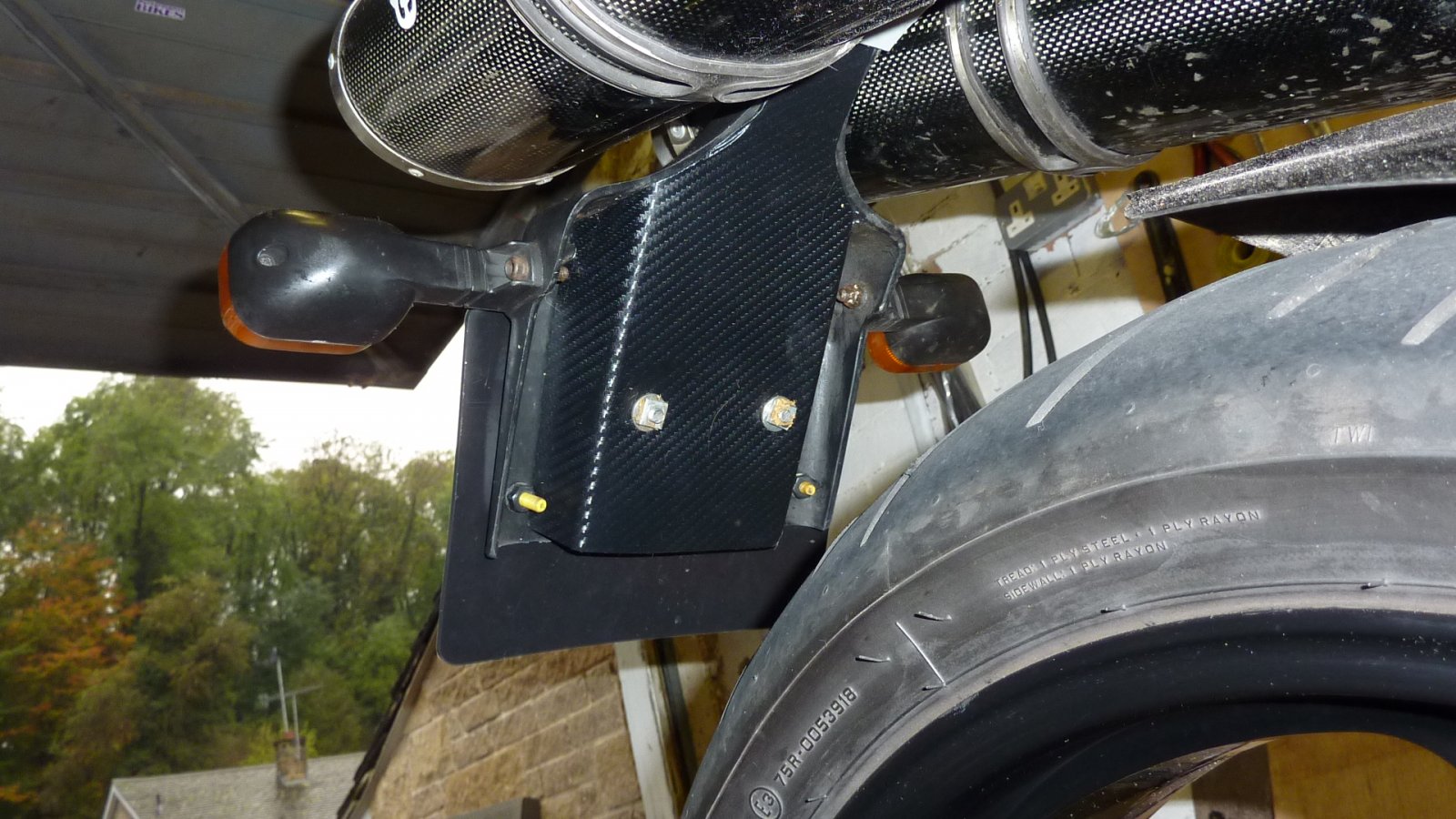

As my bike is a keeper I went the route of fitting the reg behind the number plate to keep it cool although I don't think it's necessary as the shindengen has a thermal cut out to prevent overheating. And with a cover. Steve
