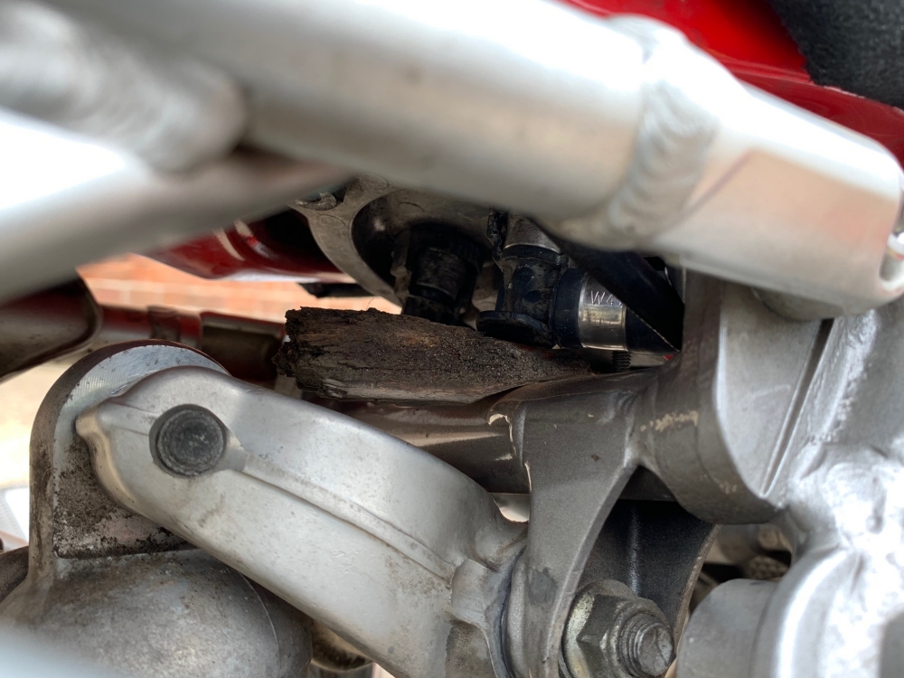

  1. So there I was, minding my own business, riding along the Hadleigh bypass (which is a sixty speed limit) when the fuel light came on. No probs I thought, plenty left to get me to the A12 Esso (their ultra has no bio ethanol don't you know?) about 4/5 miles away.
    Then she started to splutter, then conked out. Suck fake I thought. Cruised to a stop, on a bend, just passed a sticking out hedge and dusk was on the way. In a tight spot here! Got off and could smell petrol, had a look around and petrol was all over the exhaust pipe! The quick disconnect had spontaneously disconnected. I popped it back on, primed the pump and it popped off again :mad:
    So I called the RAC. They said I'd need a recovery truck, which would be coming from Maldon, a good two hours away. Tuck fhat I thought and started to look around for something to wedge between the frame cross member and the connector. The Ducati Godess, although quite unpredictable, brought me a gift to extinguish her ire:
    A perfectly wedge shaped piece of wood! Amen. I weighed up either waiting for the RAC on a darkening road which the local boy racers (and old wuck fits like me) like to cane it along. I considered the potential danger wood being quite close to the hot header pipe but decided to get myself off home. The picture above was taken the next morning.

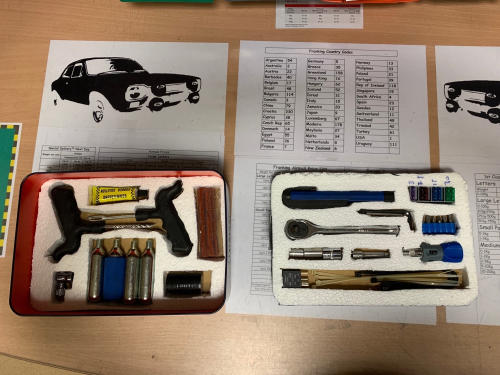

    It contains:
    Puncture Repair Kit
    Co2 Bottles And Tyre Valve Doodah (not nitrous oxide, honest)
    Small Roll Of Gaffer Tape
    Torch
    Fuses
    Allen Keys
    Ratchet
    Small Extension Bar
    8, 10 & 13mm Sockets
    Screwdriver (multiple head)
    Cable Ties (biggish & smallish)
    Relay
    I have a sleek ruck sack that is not too obtrusive to the riding and fits the kit perfectly.
    I realise theres gonna be some ribbing and some will not find this post at all useful, that's fine, I'm 53 and can take the urine being extracted. But for those of you who would consider this a good idea, what vital item would you include in your tool kit?

    Also, I've stuck some 6mm neoprene to the cross member so that if the new quick disconnects decide to give up, there's nowhere for them to go as they are resting on the neoprene!

  2. 3 amp fuses
  3. I have two small blocks of closed cell foam wedged between the frame and QR couplings as a “just in case”.
  4. Those 'Sticky string' puncture thingies are the dog's doodaas :upyeah: But ditch the CO2 bottles and get a small 12v compressor. Add a pair of pliers, or a Leatherman type multi-tool, jump leads and a side stand 'puck'.............and an AA card :cool:

    But would also include a tester bulb and length of 2 core cable.
  8. A wiring diagram!

  10. Fuel pump relay, the main item that fails on 749/999

  12. Decent recovery insurance, currently £65pa for UK and Europe, puncture repair kit, 1/4” drive multi set and a small first responder medical aid kit that includes a space blanket. Andy

  16. At the very least .....
    a few pieces of coat-hanger wire , some bits of electrical cable , paper-clips
    and a Leatherman-type multi tool .

  17. Couple of terminal blocks. Insulation tape. Toilet paper. 500ml water. Hand wipes nicked from mcDonalds. Other outlets available!

  18. Oh yeah .... that , what you just said ..... and some cable ties ....:p
    And some of those gizmos that let you connect into a wire without actually cutting it
    ... blue plastic thingies , about 1/2" x 1/4" , and there's a metal bit on top that you squeeze down
    with pliers , and it makes an electrical connection with the loom wire ,
    and with the wire that you are joining in .
    What the hell are those things called ?
    If anyone knows , please tell me , so that I can buy a bag of them ....
    .... they are the business !
    :cool:
  19. I know! Halfrauds do them, it’ll come to me in a bit. Got a box full somewhere in the garage if I can find it. Next to the house I think. Need a wee! Back soon. My birthday yesterday, got a trophy not arrived yet. Probably take a while.
  20. RS components do them 50 for less than £3. Splice connectors. Found the bag in the garage.
