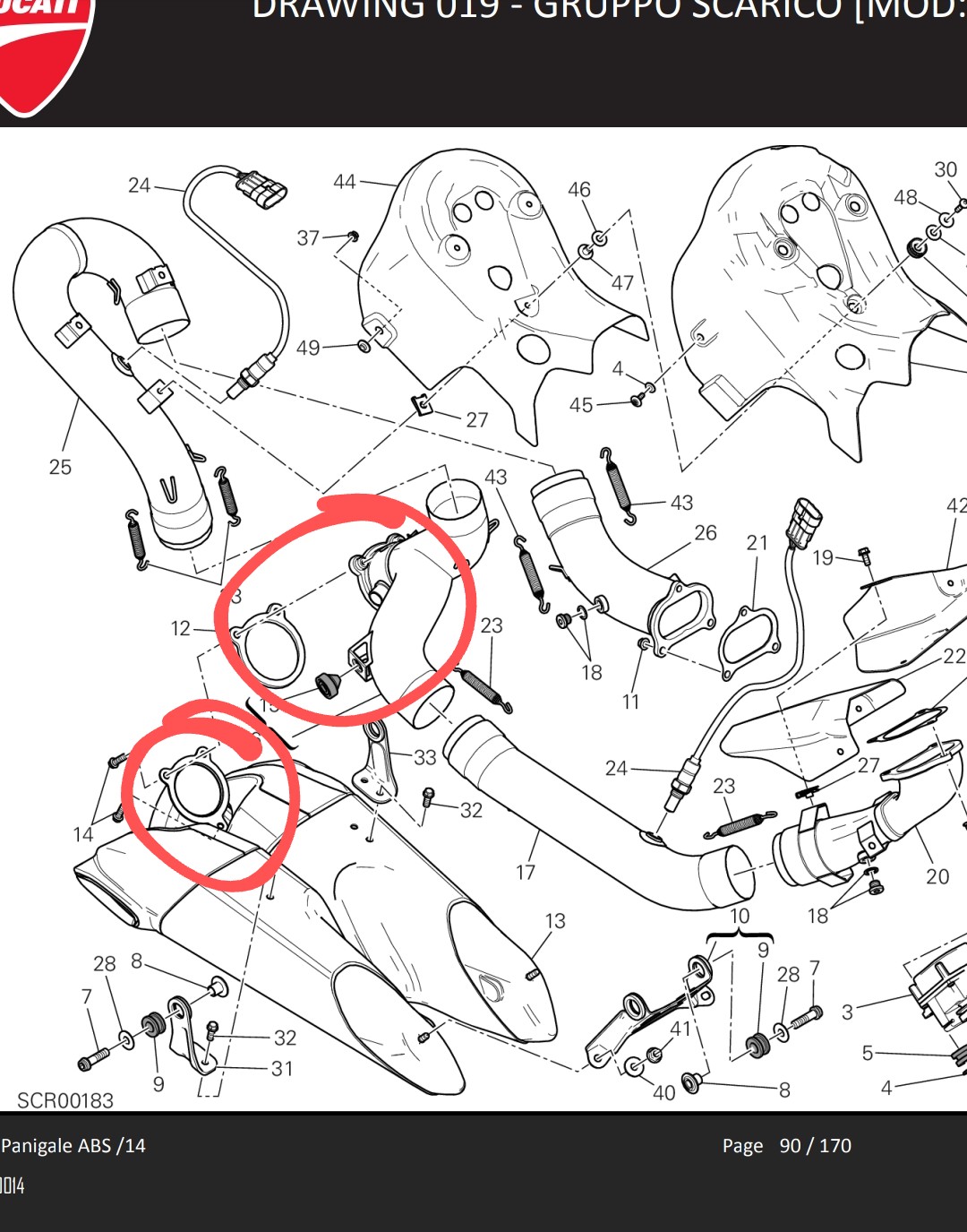

  1. Hi, can anyone tell me if the standard 1299 end cans will fit on a 1199?
    Thanks

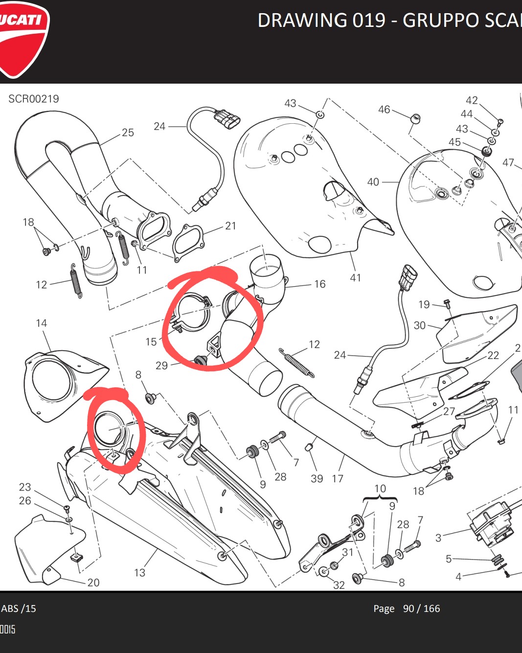

  2. From what I understand they won't, because the connecting piece (y-piece) is bigger and uses a different fitting. I'm sure I've read you can fit the 1299 exhaust to the 1199 and 899 if you fit the entire 1299 system.
    I've attached a screenshot and highlighted the fitting I'm referring to for the 1199 and 1299 from the official parts catalogue.
    1199
    1299
    #2 MarkyPancake, Aug 6, 2020
  3. I put a full 1299 system on mine, I can confirm that does fit
