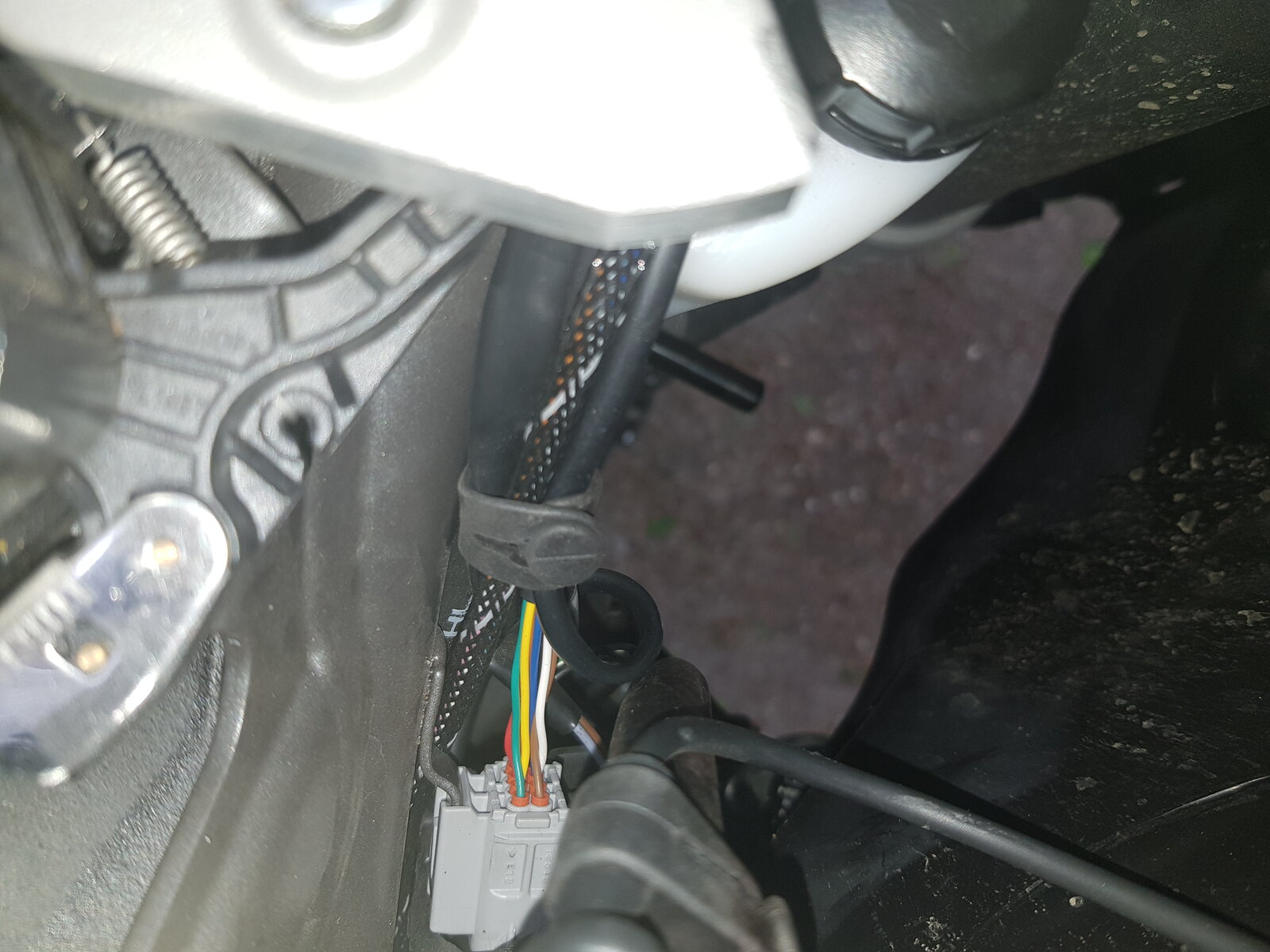

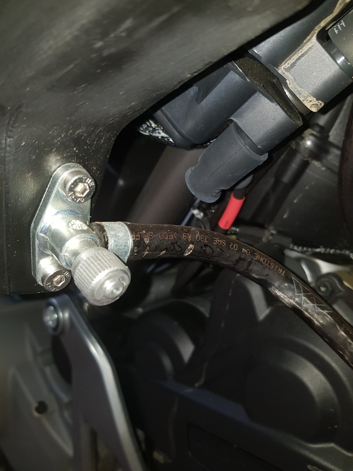

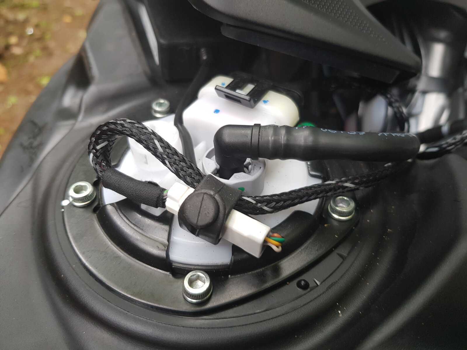

  2. Here are the taps and the hose connector. The plastic ring is loose, but I cant rotate or lift it.

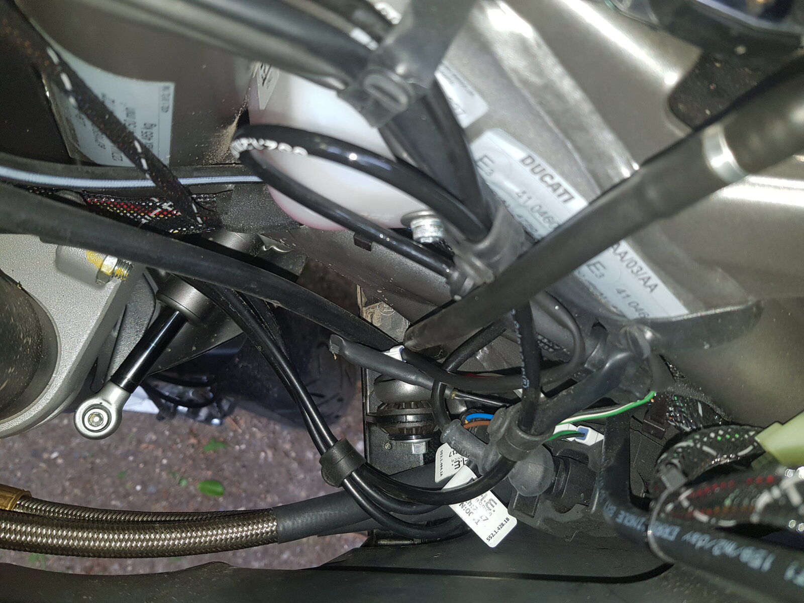

  3. Location of the throttle connector. The heated grips one is just below it.

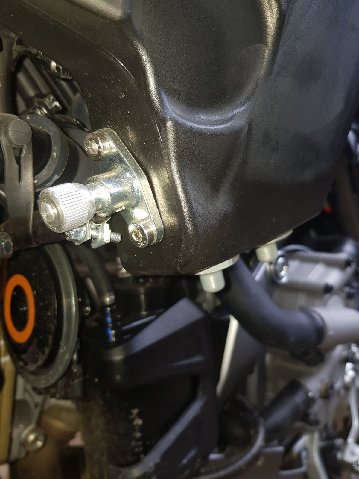

  4. And here is the left side one. It's just below where the green wire is.

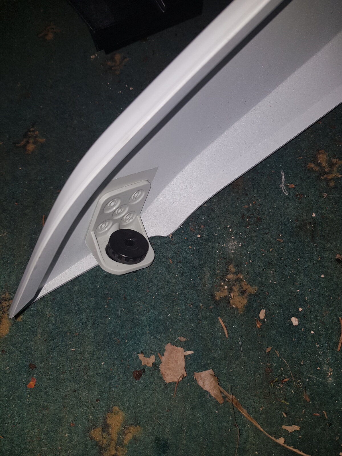

  5. One final pic, for those contemplating doing the same be aware there is a hidden Allen bolt on the left rear side of the tank cover. You need a long Allen key to get to it.
  6. Just close see the taps on the link pipe and disconnect one end, both if you’d prefer.
    Th3 hard pipe is indeed the fuel delivery. To disconnect, push down on the connector and pipe, keep the outer ring of the connector depressed and pull the pipe out. It’s fiddly, but don’t force it. If it’s not disconnecting, the hard you pull on the fuel pipe, the tighter it’ll be held.
    Tbh, I’ve done the grips without removing the tank. It’s awkward, but doable. Just swear a lot... I find that helps
  7. Thanks Nelly, much appreciated.
    Maybe I didn't swear enough :D
    Next question for you There is a white connector attached to the socket for the keyless filler. Is this for the satnav feed or the spotlights, or is it the same fuse and doesn't matter?
    I need to get my satnav supply sorted too.
    Oh, and another one while I think of it, how does the sensor in the beak disconnect ?
    I couldn't figure that out either, clearly too many beers last night frustrating as hell ;)
  8. The spot light connection is down the LH side of the tank where you highlighted the grip connector is. I think the sat nav is the one near the filler cap one. Iirc, it’s simple red and black wires....
    Temp sensor in beak is just awkward... you need to lift both clips either side whilst pulling it out. Three hands helps
